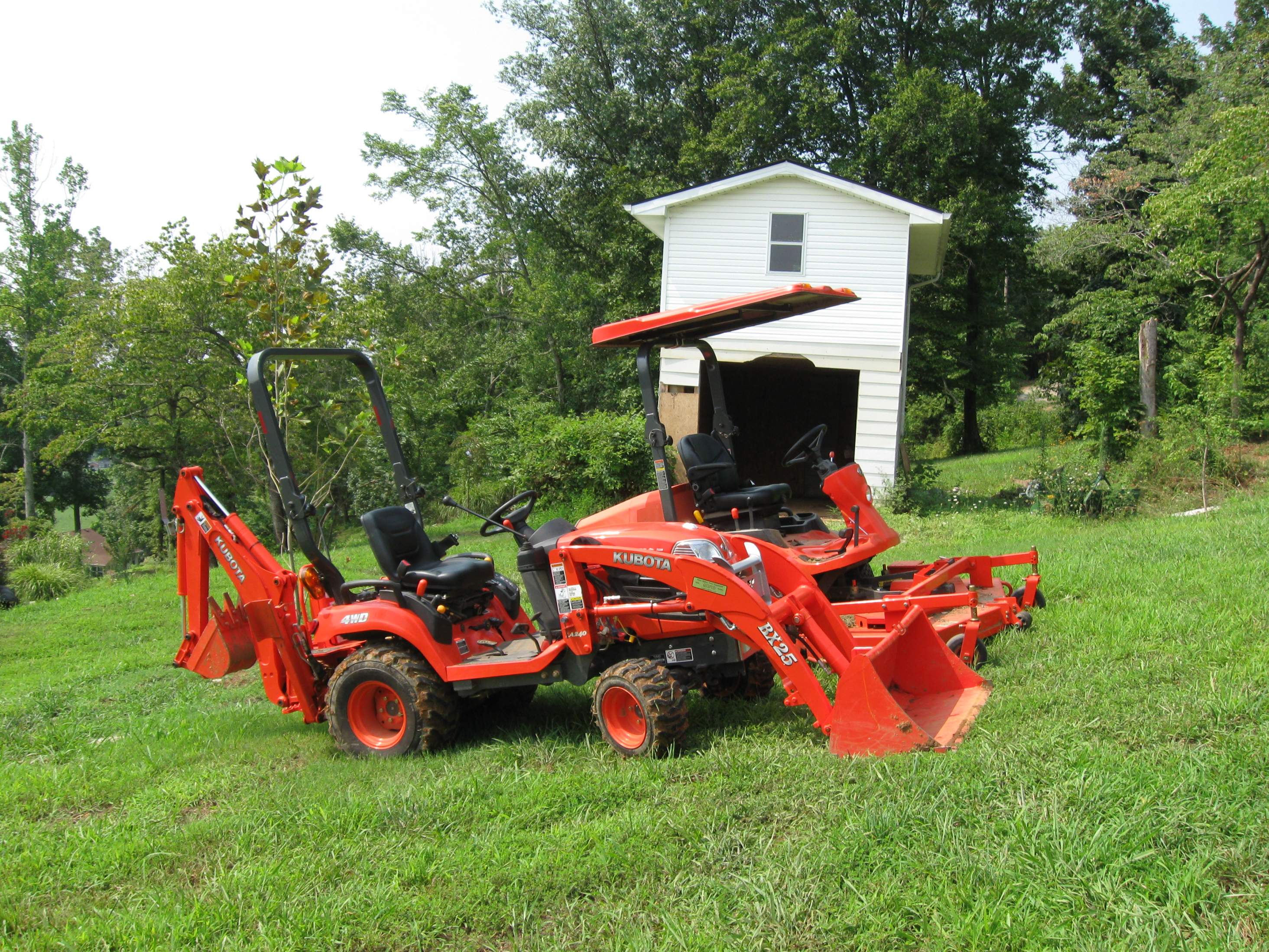

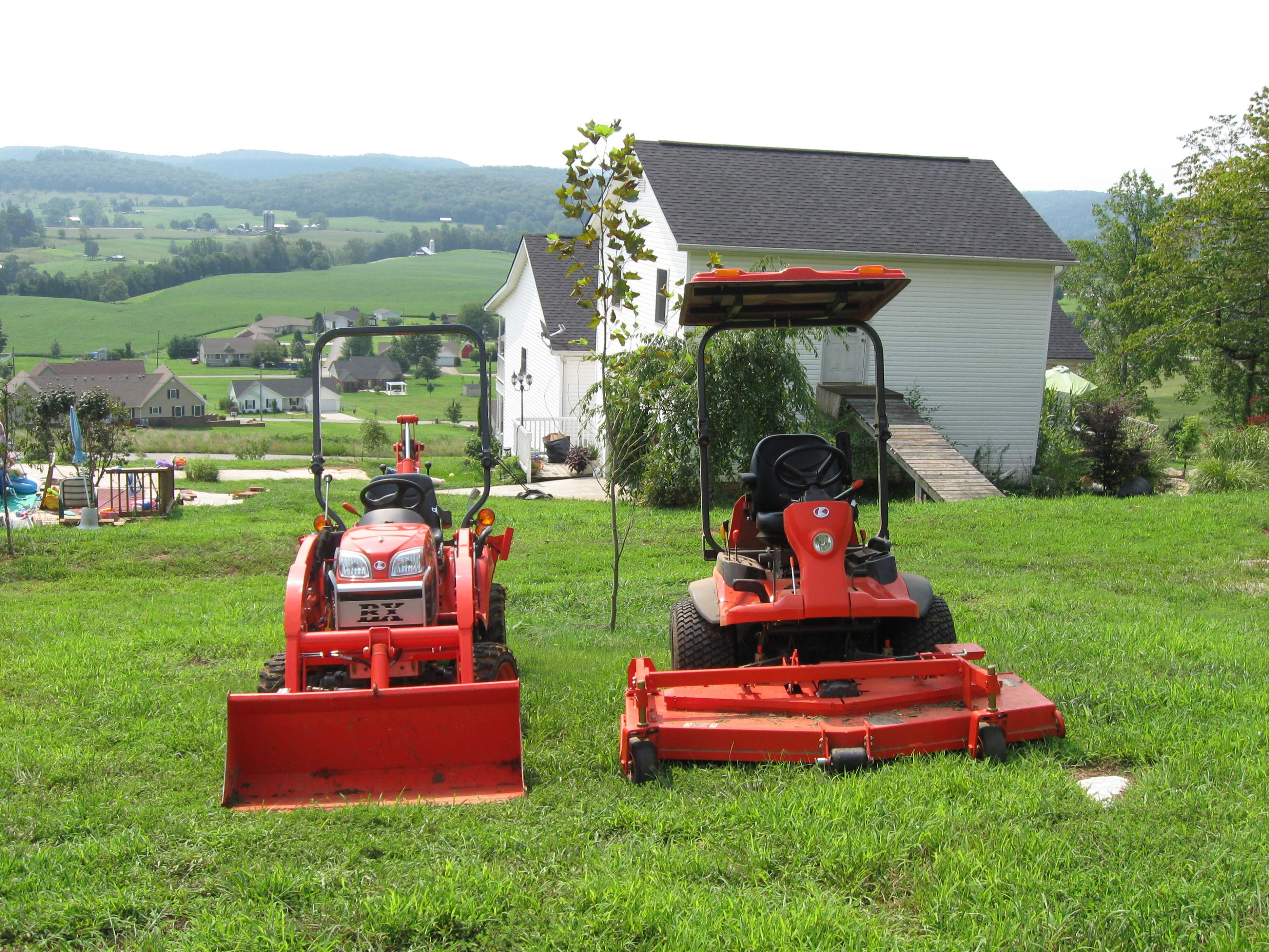

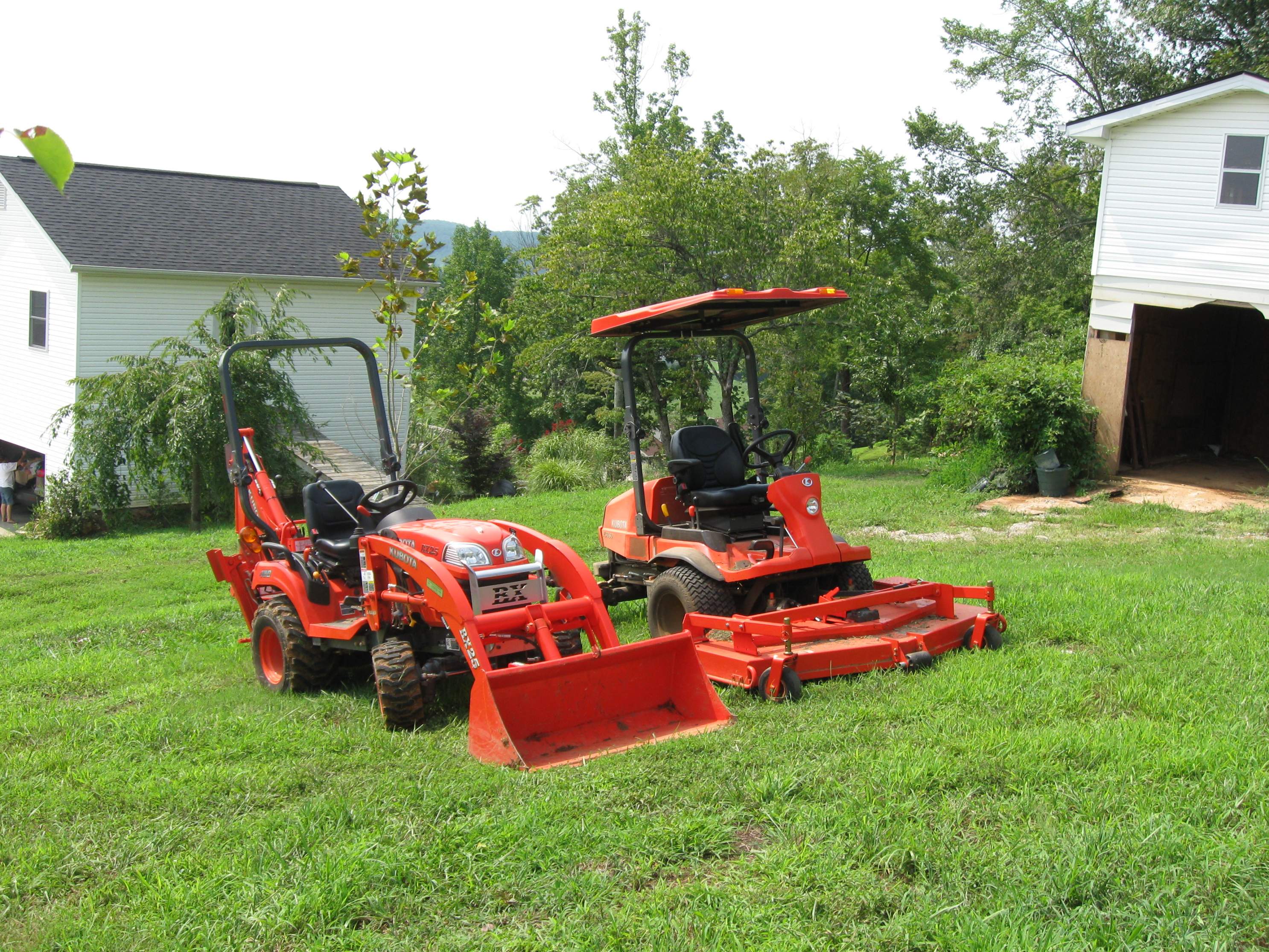

The 3ph does indeed come in a box since the BH comes installed. I've never opened my box yet. I believe every 10 hours for greasing is what's recommended. I've never been that regular myself. I use FEL and BH on BX25 so I figure 10 hours of BH use and 10 hours of FEL use is 20 hours on the meter plus 10 hours of idle and travel time plus some unknown factor so if I do it in 30 hours that would be a frequent greaser for me. Now some are going to say they sure never want to buy one of my used rarely greased machines but to late. Done traded and giving up trading.:)
Changing oil and fluids and filters is easy and would never enter my mind, well it has entered my mind but have never paid anyone else to do it. Helps me get more familiar with my tractor to do this simple laying down on the ground for a few minutes job. Not much maintenance to these tractors. I mostly fuel them, work em, change fluids and filters as recommended in owners manual and grease ocassionally.
I also leave them out in the rain occassionaly to wash them off and then always raise the seat and leave it up when I get finished using it to keep bird poop off the seat.
I do keep my tractors under cover in a building other than for rain washing and when working.:)

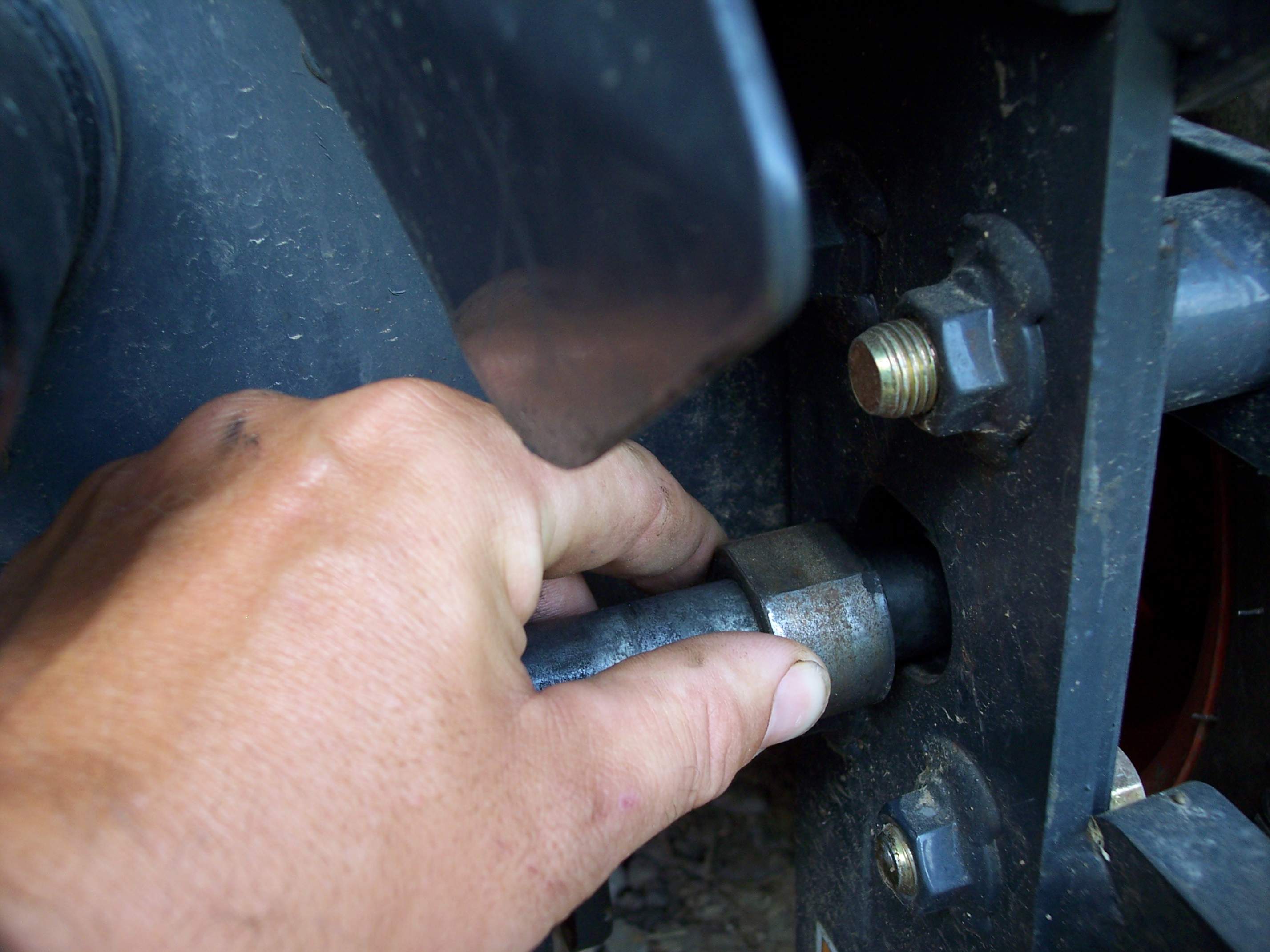

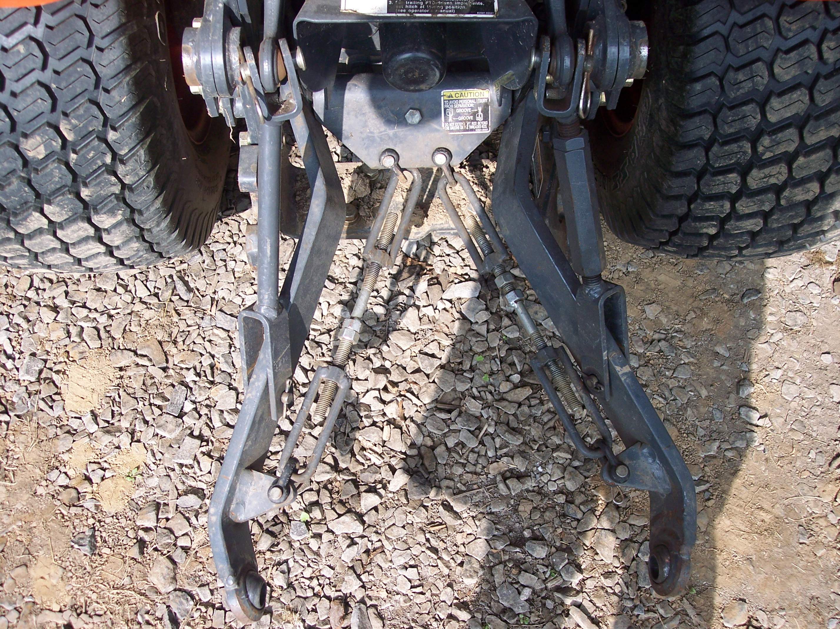

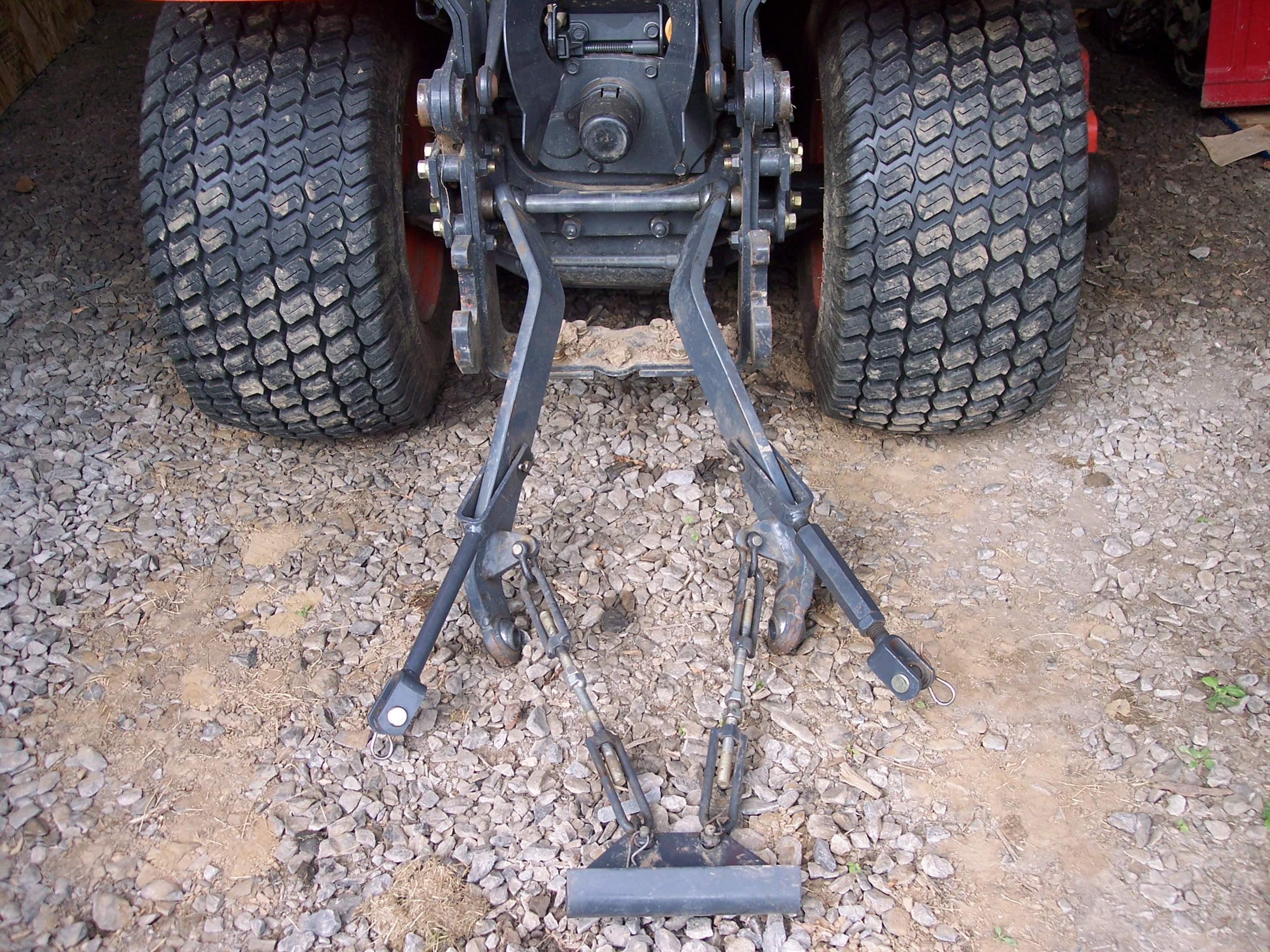

I forgot to add the 3 pt pics to help you to look at how it should look like when installed. I was fornuate enough to have my dealer help me put it together when he dropped mine off since I wanted ot test the rototiller I got the same day.
I suggest that you lay out the pieces like I did, and pull up to the tractor and install the crossbar and install the busings. then the j plate. keep in mind that I modified mine, I tapped my hole to use a regular bolt. Yours will be a bushing bolt with with no threads and its installed from underneath and held in with a small clip. Once the plate is in, then you can attach the side arms on both side and you are ready to go.
