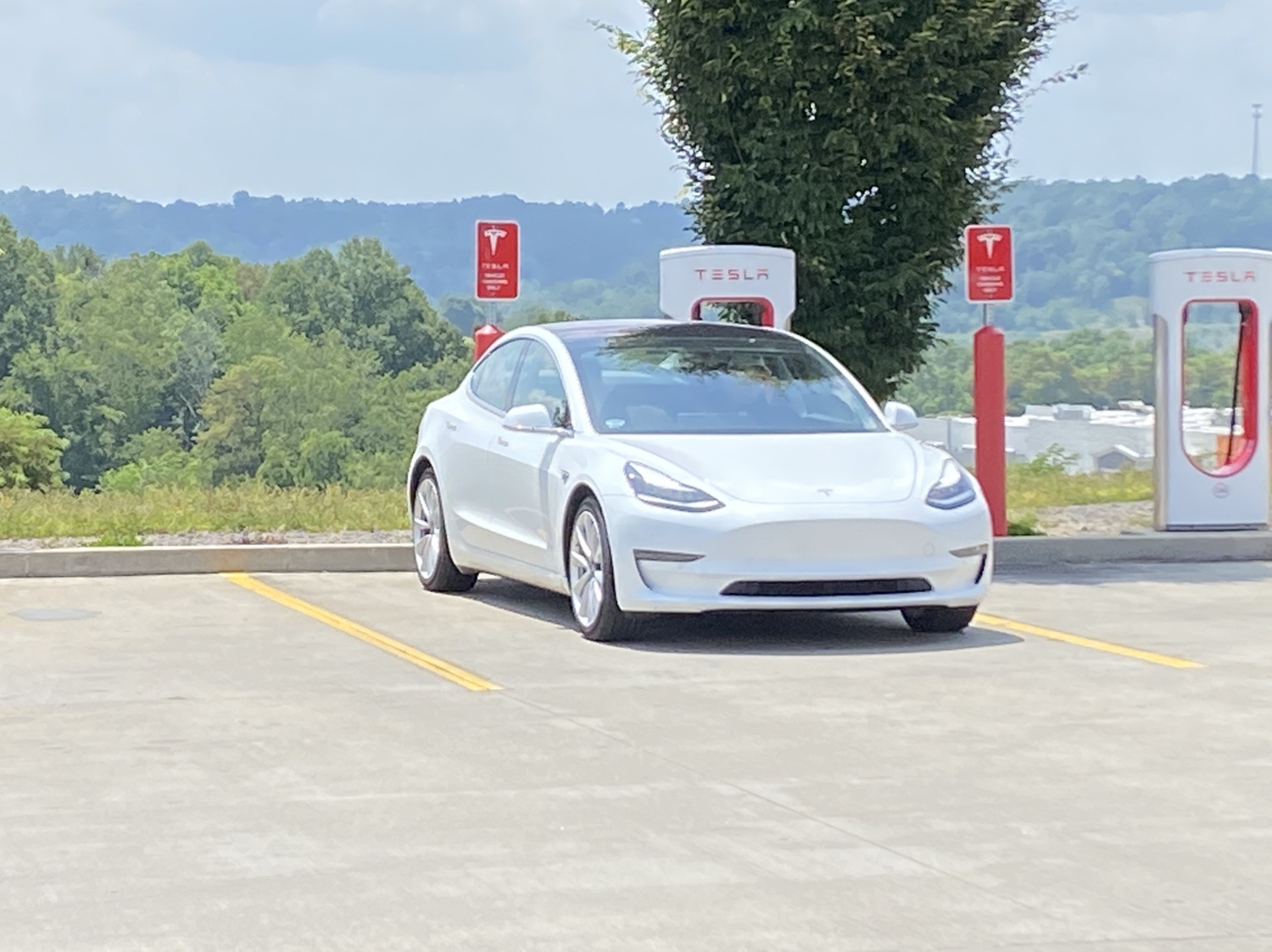

Time will tell if it's any cheaper after the station charges the fees to use their charging station.
I can’t imagine it would be. Is cost to customer calculated on a $/minute basis? I bet the commercial charging stands are expensive to install, all that cost has to be recouped.

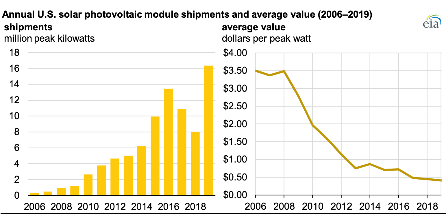

That’s representative for residential systems too:
I was simply commenting about how the price of solar has dropped. Here’s a chart of costs from the EIA:
You obviously can’t maintain those kinds of decreases forever but the DOE expects prices to approach 2 cents per kWh by 2030. If you look at the massive investments being made and who’s involved, it’s not hard to see that solar will be a dead no-brainer in less than 10 years. For many it already is.

By the tim
It will be interesting to see how that plays out. The base cost of the electricity per mile is roughly half that of an ICE today so there’s a lot of room to maintain margins, although gas stations don’t make money from selling gas, they make it selling Big Gulps and hot dogs.
I would be surprised if gas stations even remain a thing. It’s dead simple to install a charging station vs gasoline and diesel tanks so they’re going in a lot of places people go already, and most let you charge for free just to get you to shop there. Good things don’t last forever but here’s an interesting article about some guy who never paid to charge his EVs for three years and why giving away free EV charging still makes those places money:
