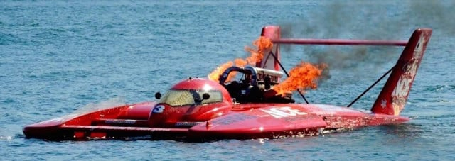

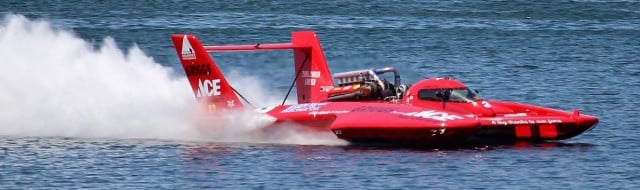

Up here we have hydroplanes and there is an old piston hydroplane group (vs the new fangled turbine engine hydros). The last time I had a tractor in the shop for a re-build it was worked on by a part time piston hydro mechanic (not enough of them to be full time). I got to see him fire up the piston hydro ahead of firing up my old Massey. Not quite the same sound :ROFLMAO::ROFLMAO::ROFLMAO:. He said he put the same effort into both engines.
