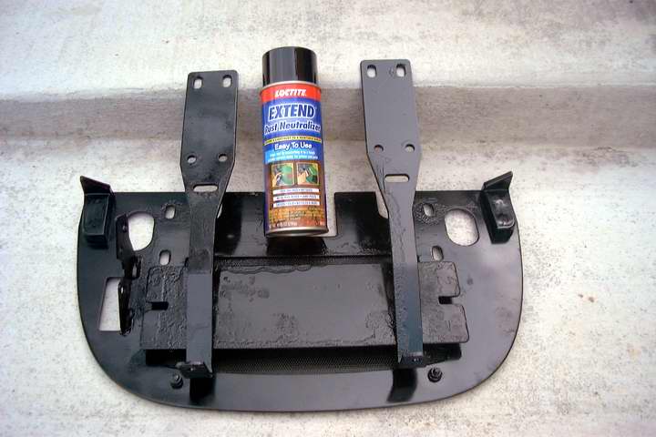

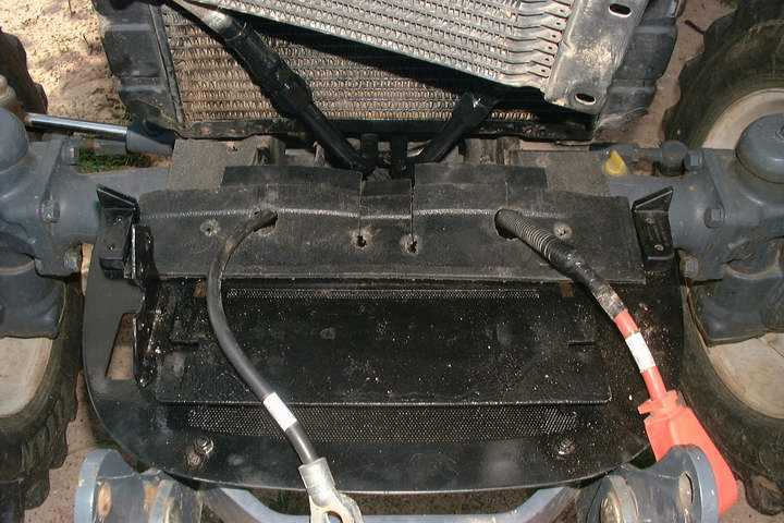

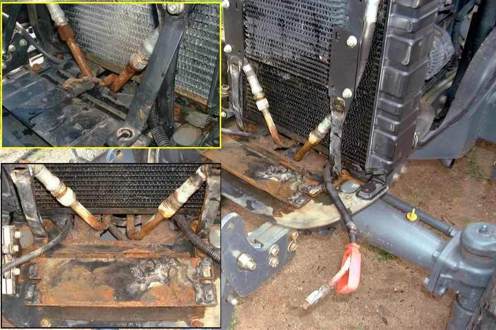

Well I've got the acid stains and rust all scraped off. I've primed and painted the rusted parts and have a battery box in which to install the battery. Now I just need to decide whether or not to re-engineer the charging system try to trade for an Optima battery or just leave it add the battery box and replace the battery every four years.
/ Battery Boiling Over #39
I'd make a secondary containment box and line it with EPDM that is acid resistant, Id provide a vent cover/catch hood where it would allow any boil over to be contained within the box. I'll make sure I do not have any holes in the epdm by making up some clip system to attach it to the containment box. I use the new battery till it dies and will then replace it with an Optima. If I can get good credit for the return (90% of original purchase price) then I'll trade it in for Optima now.
Jim's word is as good as it gets.
JC,
/ Battery Boiling Over #40
Have you found the cause as to why it did it ? That is first priority .
