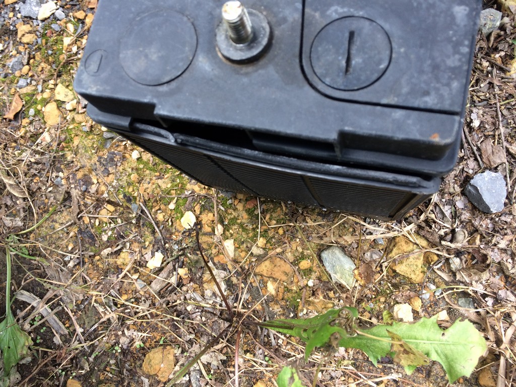

The battery in the photo looks like a sealed type.
VRLA have pressure chambers and better maintenance free have similar design.
Gas is produced when charging and high rate creates more gas.
Internal structures that may come loose between cells can cause an intermittent connection that usually allows low current load from controls to work but high current loads like pump or starter motors can cause the connection to spark resulting in boom
