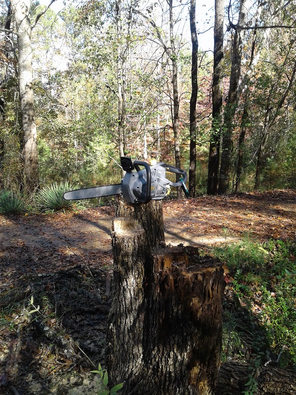

I've bought 4 battery operated chainsaws - two of the B&D 40V, 12inch LCS1240 and two HF Lynxx 40V. The first B&D I bought partially because it was on speciall at Target for only $120 w/ battery and charger. I gave that one to my son almost immediately, only used it enough to know I liked it and wanted another, which I got. It was light enough I could easily use it one handed with my arm extended and at the top of a ladder. But my daughter needed it more than I did.
My first HF one was a 10" bar on a pole saw. It worked so well I bought the "regular" 14" Lynxx chainsaw, which uses the same battery. The HF Lynxx 14" is much heavier than the B&D 12", heavier battery, lot bigger charger, more expensive.
Cut's well.
I really liked $120 B&D's, but at $200 they are NOT WORTH IT.
The HF Lynxx has virtually replaced my beloved Stihl 021, especially when I'm "in the canopy". I've always disliked starting a saw while 20' above the ground.
