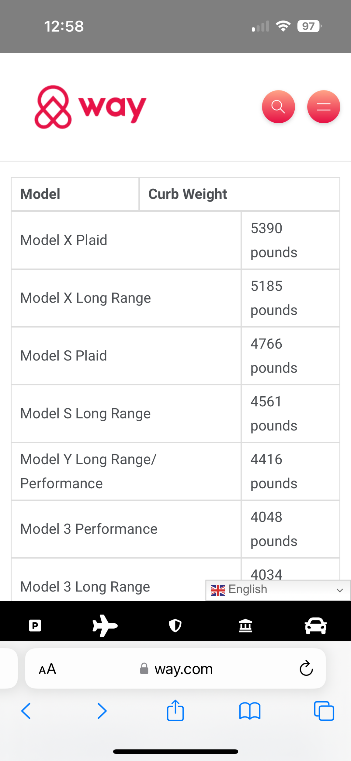

Even teslas are constrained by it. Those little cars are weighing close to 8k pounds, that's HD truck territory.
I was having a little trouble believing this, so I searched on “list Teslas by curb weight”, and this is the list I got, heaviest to lightest.
They’re not made of feathers, but none listed here are anywhere near 8k lb. Which ones aren’t listed?
