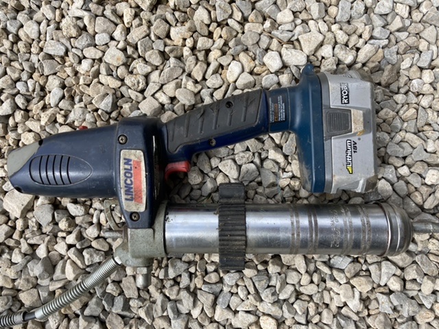

You know, I have a grease gun that took some kind of 12 or 14 volt batteries that I picked up off the side of the road. I also have various Ryobi flashlights and stuff that could probably be sacrificed for such a cause...

There are adapters for the various 20ish volt batteries out there. That one looks almost OEM though. Nice work.
Badaptor Dewalt 18V/2V Battery Adapter to Ryobi 18v One+ Tool | eBay although that one is kind of backwards for me. Flat faced batteries are easier to adapt than batteries with a post on them (like the One+ ones). Pile of files to print the adapters out on a 3d printer too on thingaverse or what not.
Aaron Z
I don’t know how your luck would be on some oddball battery but you can buy adapters for the more common brands.
I had not seen those.
Yeah, an adapter to put a Ryobi battery on a Dewalt tool would seem to be a better idea.
But, I would never need it.
