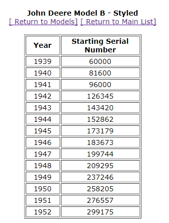

Bob
There's no such thing as a 5 or 7.5 volt battery for a automobile or tractor. Each cell(cap) on a lead/acid battery contains 2 volts so if it has 3 cells as your tractor should then it requires a 6 volt battery. Below is a serial chart so you can determine yr model of your B if it has a serial number tag.

Sorry. I have been away. You were correct it was a missed type. It is a 6 V battery. It goes under the seat and fits snugly into the area where the battery is to go.
Thanks!
