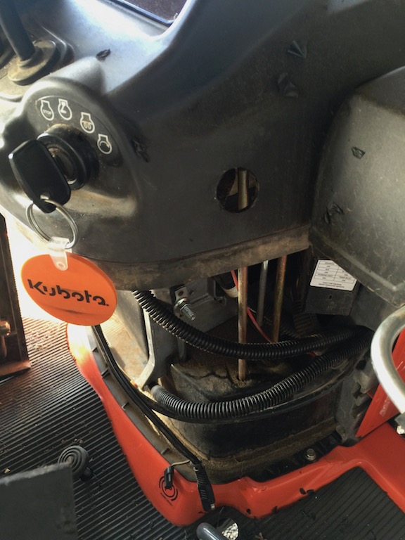

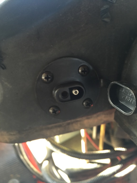

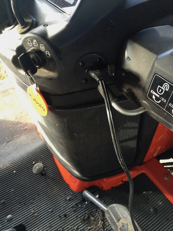

   / Battery Tender Connections #15
This is what I did. Permanently connected leads to the battery that came with the battery tender and installed a quick disconnect panel on my dash.
