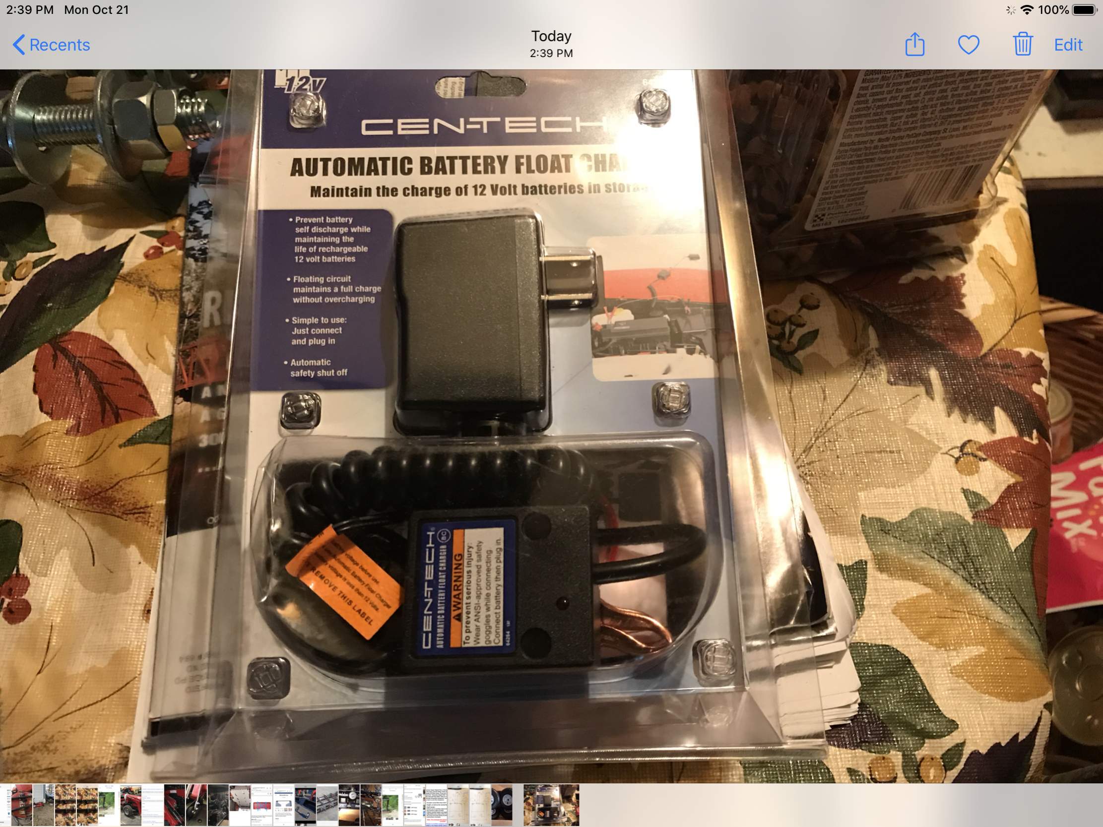

Just received two of these battery tenders to try out that I forgot I had ordered with some wheels, was more interested in the wheels then the tenders.
"Battery Tender" is a registered trademark (patent?) of Deltran Corp. in DeLand, Fl.
Those pictured are not Battery Tenders!
Maybe Harbor Freight?
