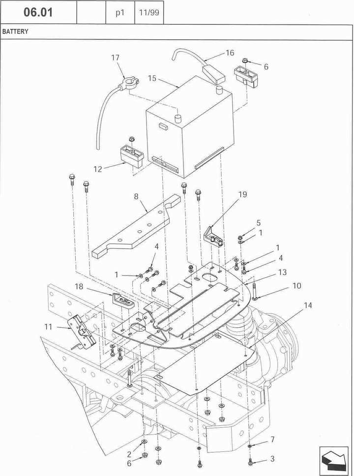

Hello all,
Just to make a long story short, this morning I noticed a white residue on the floor under the front of my DX33 with 107 hrs. /forums/images/graemlins/mad.gif /forums/images/graemlins/frown.gif Popped the hood and the Battery tray is wet.
Went to my dealer and tried to get him to replace the whole tractor with the new one sitting in his showroom /forums/images/graemlins/grin.gif, but he didn't think that would be necessary. Service man will be out tomorrow to check it out.
I know it's not a NH, but they are related.
Ron
   / battery terminal corrosion #74
I'd wash down the area immediately and check to see if the radiator is wet. If so, I'd wash the radiator and front of engine as well. What is typically happening is the battery acid, once it sloshes out or gets bubbled out, gets sucked by the fan into the radiator and blown all over the front of the engine. NH has replaced many a radiator and related pieces as a result.

I have a suggestion that might help you Here's an illustration of all the parts of the battery shelf. You can print a copy of the illustration. Then, as you inspect your tractor, you can mark all the parts that need to be replaced. Give the illustration to your dealer so he knows what parts to order to fix your tractor. You might also need a new radiator and hydrostatic transmission cooler lines in addition to what is shown in this illustration. Good luck with your repair. I had all this stuff replaced and now my tractor is holding up well. /forums/images/graemlins/cool.gif
