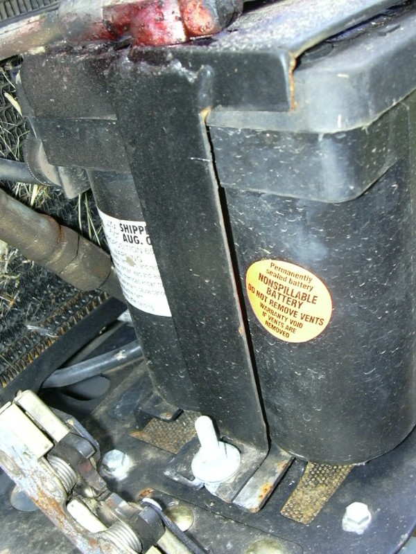

The dealer replaced mine with NAPA's sealed battery. Here is a picture of it with the bracket he fabricated.
Mark
   / battery terminal corrosion #56
'nother.
Mark

Hey Mark, that's a nice bracket you made. I like the way it uses the existing hold down stove bolts. The wide strap instead of a "J" bolt should make the bracket and battery stable without sitting in a snug frame. I will try to cook up something similar without welding. I don't have a welder just now. /forums/images/graemlins/frown.gif

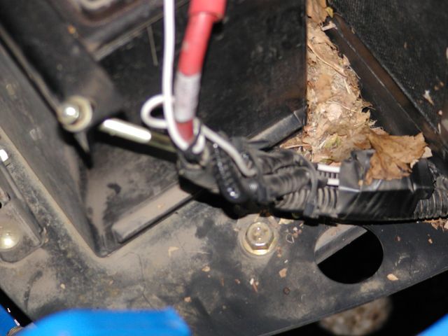

The Class II Boomers utilize;
- 2 pieces of 1" x 1" angle iron
- 2 J bolts
- 2 holes
One piece of angle iron is attached right in front of the radiator and serves and a 'back stop' for the battery.
The other piece of angle iron has a hole in each end for anchoring the threaded end of the J bolt. The hooked end of the J bolt slips into a hole drilled in a vertical tab (one on each side of the battery) attached to the steel tray the battery sits on. However, I imagine a simple hole drilled in the tray, without the vertical tab could work, too.
Here's a picture that shows the angle of the J bolts and the piece of angle iron that secures the top of the battery. The 'back stop' is covered by the leaves! /forums/images/graemlins/blush.gif
