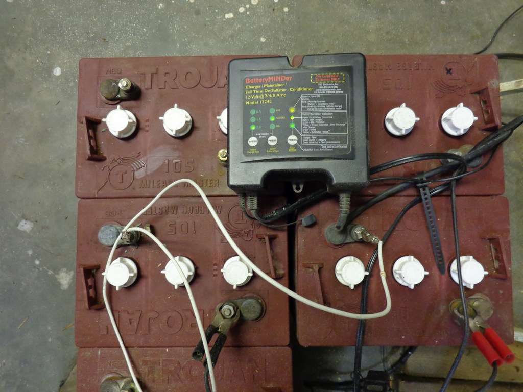

Had the battery minder for or 10 years before I gave it a test that convinced me it actually worked. Bought a golf cart for my wife to drive around our property and the battery's were in bad shape. Checked with a hydrometer they were poor. After hooking them up ( 6 volt tied together for 12 volt) a week on each set and they registered good with the hydrometer. They are still going strong.
