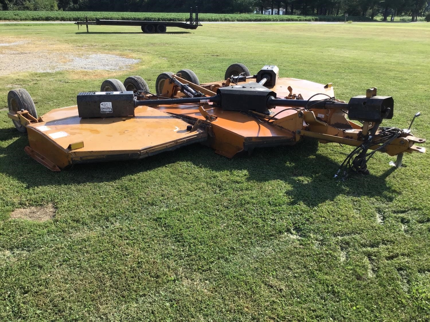

Have to chuckle just a bit, the bat wing over at the farm has had a couple of issues and one gear box is acting up now. It's an older Woods with some very convoluted gearboxs and slip clutches. The gearboxs have a solid inner shaft that passes the power through the gearbox and then hollow outer shafts that drive the bevel gears. Had a yoke on one of the wings spread and allow the u-joint to pop out. Repaired that once and it held for a while and then it spread again. So today was cutting the yoke off the shaft and we will order a new yoke and weld it back on the shaft. Only brush hog that I can recall that had the wing slip clutchs on the "rear" of the gearboxes.

I just changed gearbox on a 5 ft rotory. Stump jumper just falls off, because it has been taken off many times. It kept getting loose bolts, and kept having to take it off to tighten them up, until I used loc tight and double nutted them. But it leaked oil, and didn't get filled, and gears stripped out. I replaced gearbox and have it as secondary, as I bought a new landpride 6 ft.

Update on my gear box. It took almost three weeks to get to the dealer, but it was at their other location for a few days before it went to the closer dealer. I brought the damaged gear box with me, and they gave me the new one. No paperwork, nothing to sign, we just traded them at the counter, and I was on my way home.
I'm very happy with PR Equipment, and Iron Craft. I don't blame them for the gear box issue, I know things break. I appreciate how easy it was to get the new gear box under warrantee. To me, that's the important part!!!!
It went together a lot faster and easier then it came apart. I was expecting there to be a battle getting the stump jumper back on, but it slid on easily, and then I maxed out the bolt with my 3/4 inch impact wrench.
The gearbox came full of oil, so I checked the site glass when it was all done, and it's full, so nothing to add there.
I mowed last weekend and I've been mowing in the evening this week with it. Everything is tight, and everything is working like it should.
