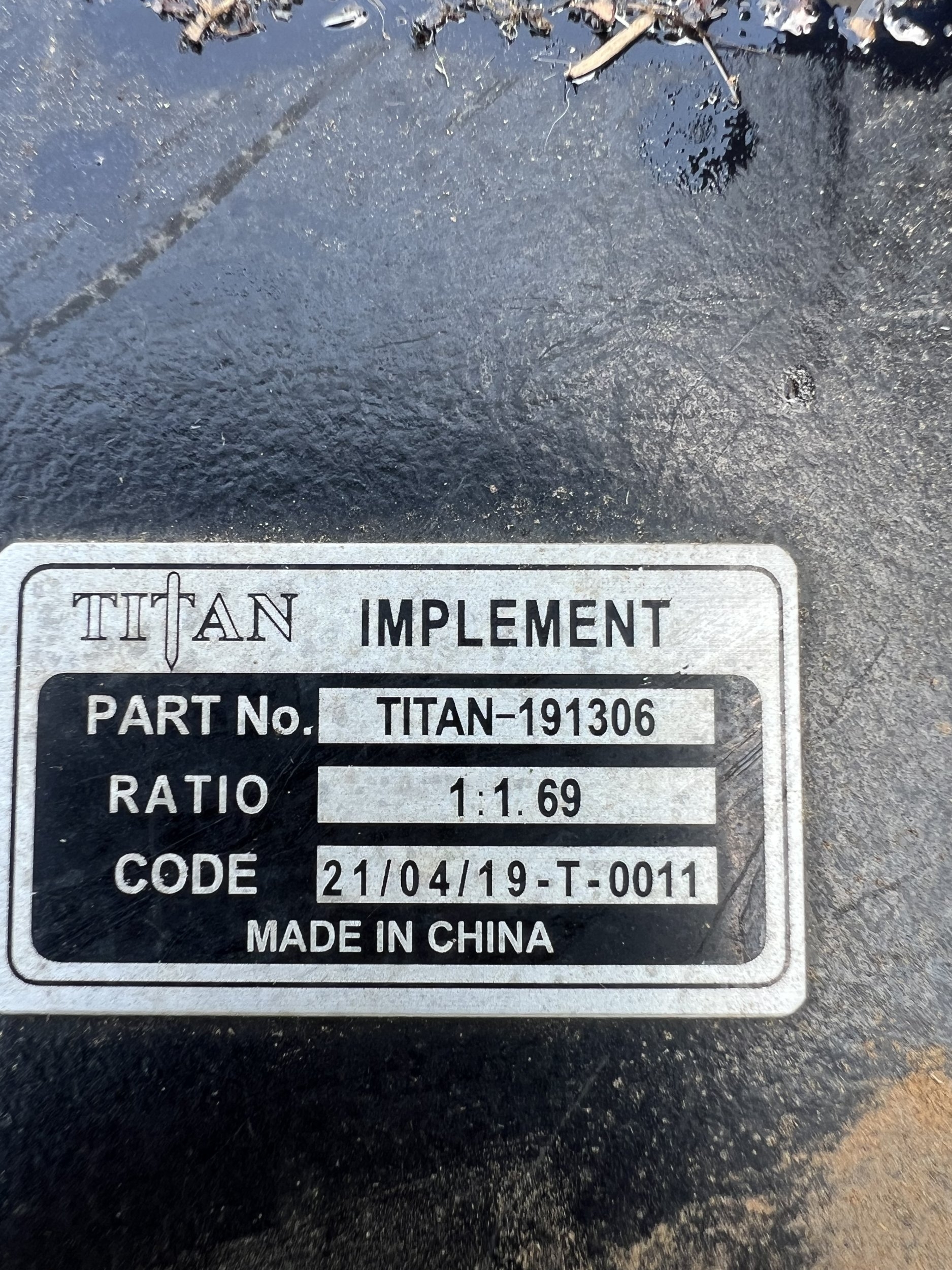

The mower was Titan when I bought it, but a couple months later, they changed their name to Iron Craft after losing a court case against the other implement company in Tennessee that's also called Titan.
This is the top of the gear box.

Oh man - I just bought the 12' Ironcraft. This doesn't give me a good feeling.

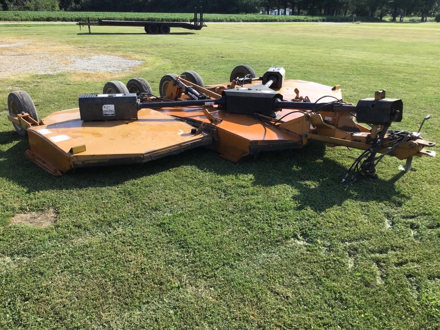

At least you didn't buy a Woods BW12... Total junk. Sold mine for half of what I paid for it while it was still under warranty. :confused:
   / Batwing Gear Box blew up #20
I took a big hit on my Woods BW-180HD
Nice machine when I bought it, but single layer deck was ruined in a year and at best, it was painted with a mop over rust haze.
