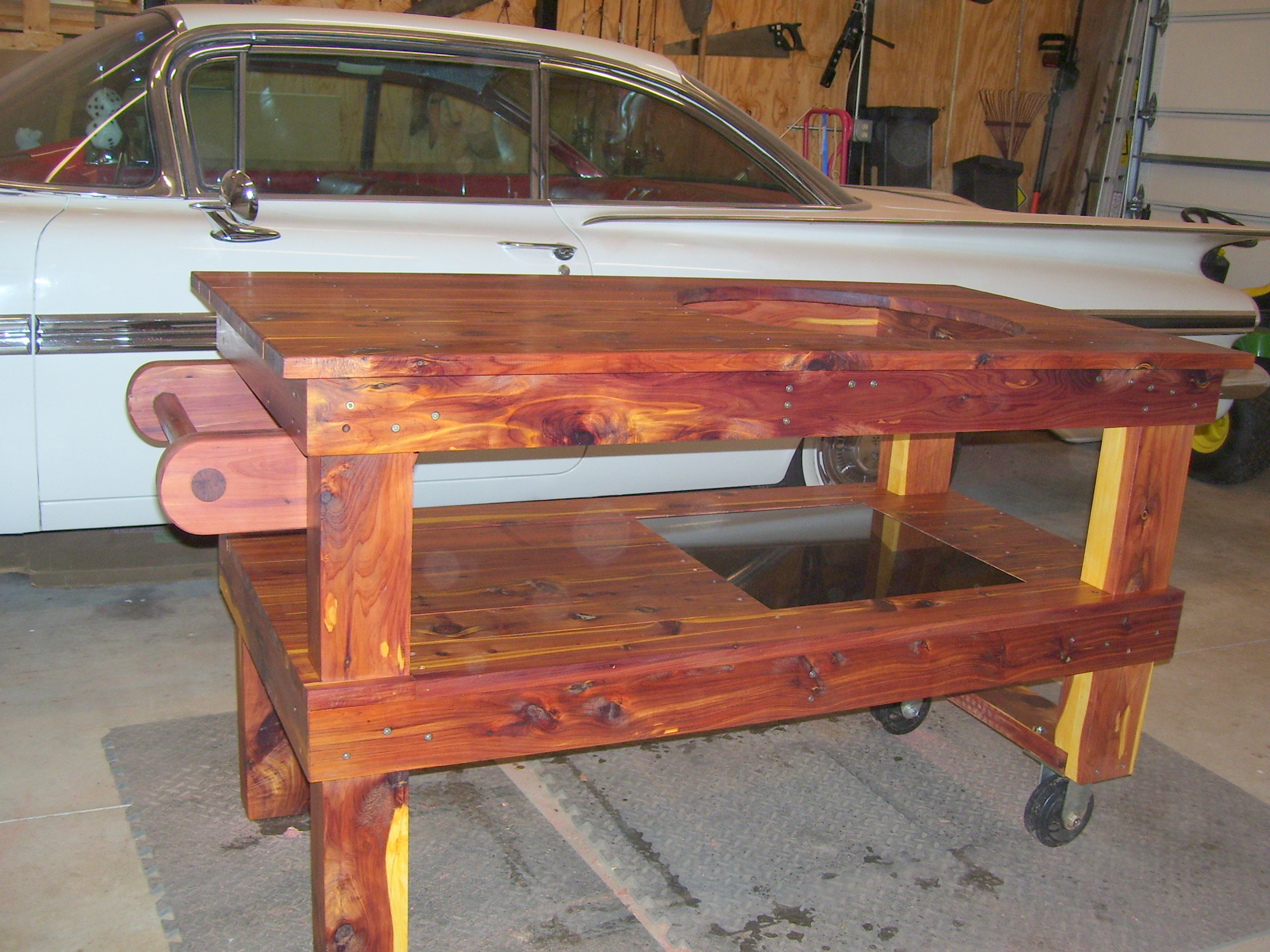

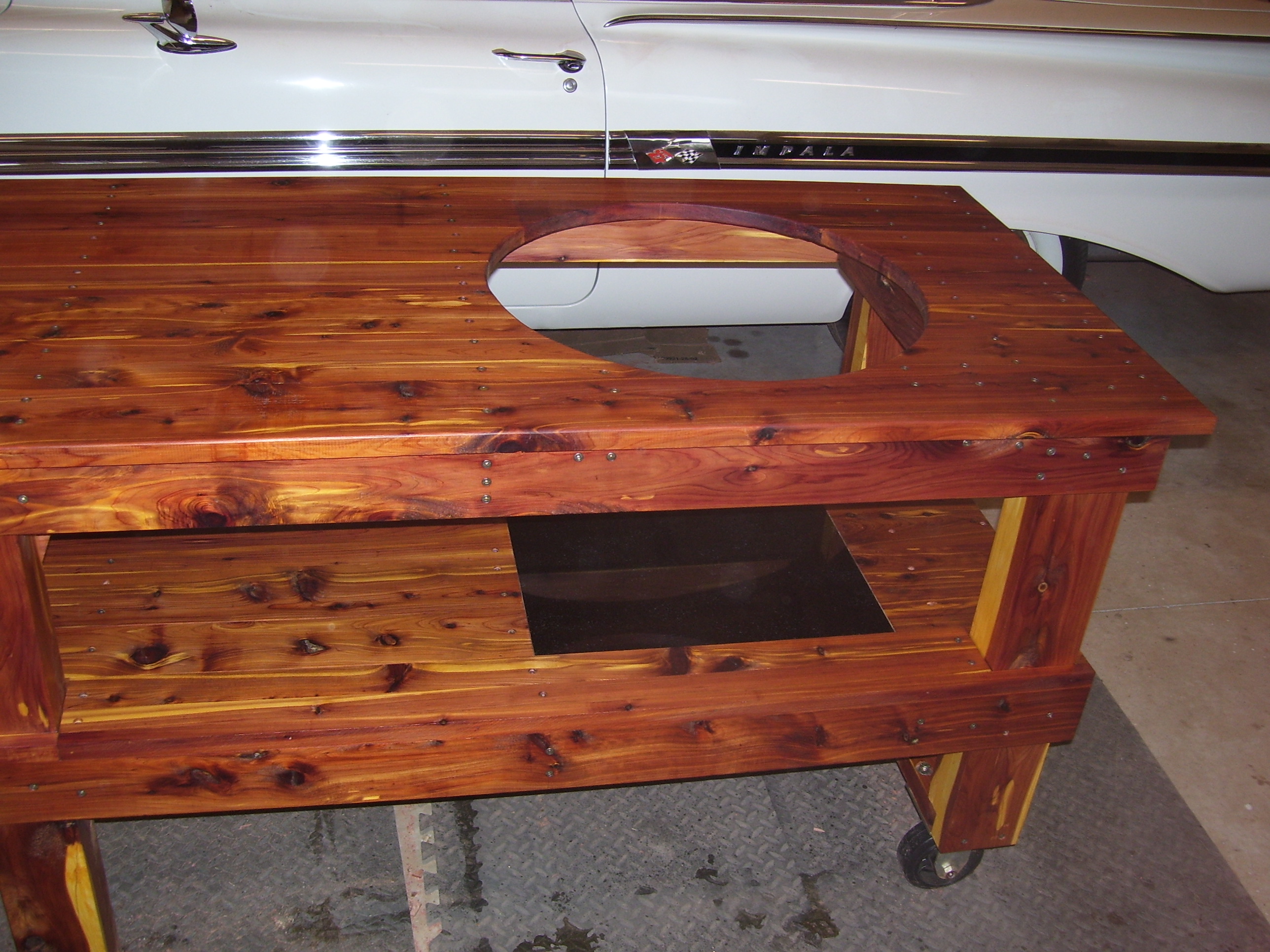

2Lane, what kind of wood and finish. I like the look for a BBQ station!

It's local, aromatic Cedar; no stain. The finish was a spar varnish, but it didn't hold up well at all. I would probably consult with a reputable paint store to see what they have that will retain the color; I probably should have gone with a penetrating finish of some sort. The shiny piece on the bottom shelf is polished natural granite that I had cut at a cabinet outlet to set the Egg on. Granite will take the heat without cracking; you can heat it red hot and it won't break. Oh, I used all SS screws in it. I don't have a lathe, so I made the handle with an antique draw knife that I have had for 40 years and never used. I was amazed how close I was able to shape it and make it fit into hole I drilled with a Forsner bit. The wheels are industrial grade wheels I bought at Lowe's, as I recall.
