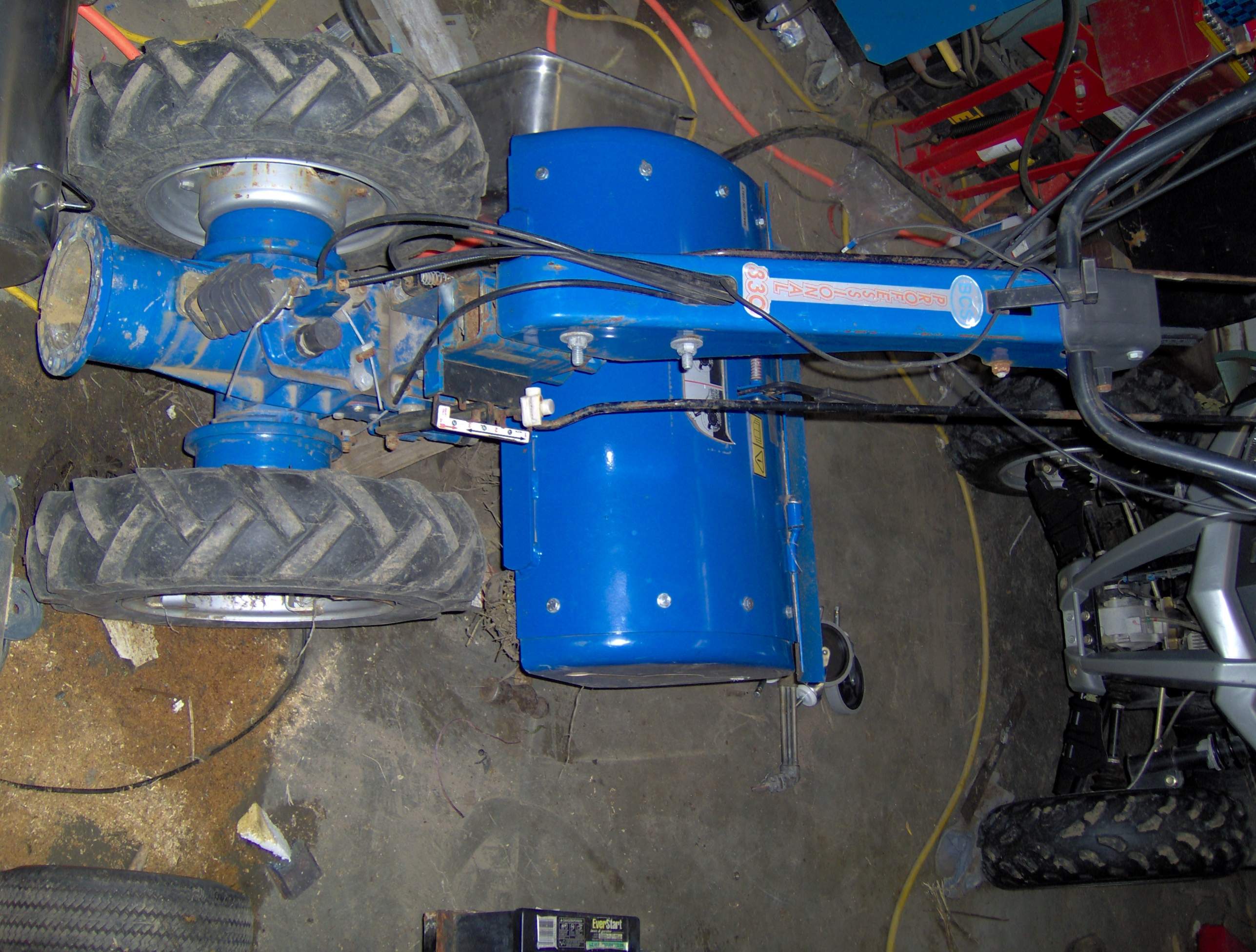

Will I finaly found a BCS tiller I can afford and is what I want in size. I has come with a 10 hp B & S and it works fine but I hate B&S to work on and I have just fell into a nice 13 hp Honda with Electric start. I pulled the B&S off and thought a would look in on the clutch and see how bad it was. The rubber boot around the clutch lever was not of the best shape and the pervious owner was not too proud of his BCS. I believe it lived outside durning the winter months for the last few years. As I removed the engine the water ran out on the floor. (Not A Good sign) I also found some ball bearings loose in the housing under the clutch. Anyone know what they might be from? A good place to buy a new boot? Maybe a clutch? how about a used battery holder for my electric start Honda?

Here's a good place to find the parts you need, Joel can take care of the adapter for the Honda and the boot for the clutch fork, don't know where you can find a used battery holder, maybe Ebay. Welcome to TBN, you can find lots of info here Earth Tools - Walk-Behind Tractors - (502) 484-3988 and you have one fine machine once you get the little stuff taken care of.

Here are a couple of pictures to start. My Batteries died I Will take more later.

Here I have added the 13 HP Honda and Fired it up. Everything is working fine but I have found the BCS shop did not add the Spacer between the Mounting flange and clutch. I am now waiting on that to arrive.

HI Oldtelephone,
Someone on the site referred me to this old thread. I'm in the same predicament, I have the same BCS 830 and would like to upgrade the engine to a 13hp Honda. Was it pretty much unbolt the old engine and clutch assembly, transfer old clutch on new engine, and then bolt on new engine and clutch to the tractor? Any help is appreciated.
