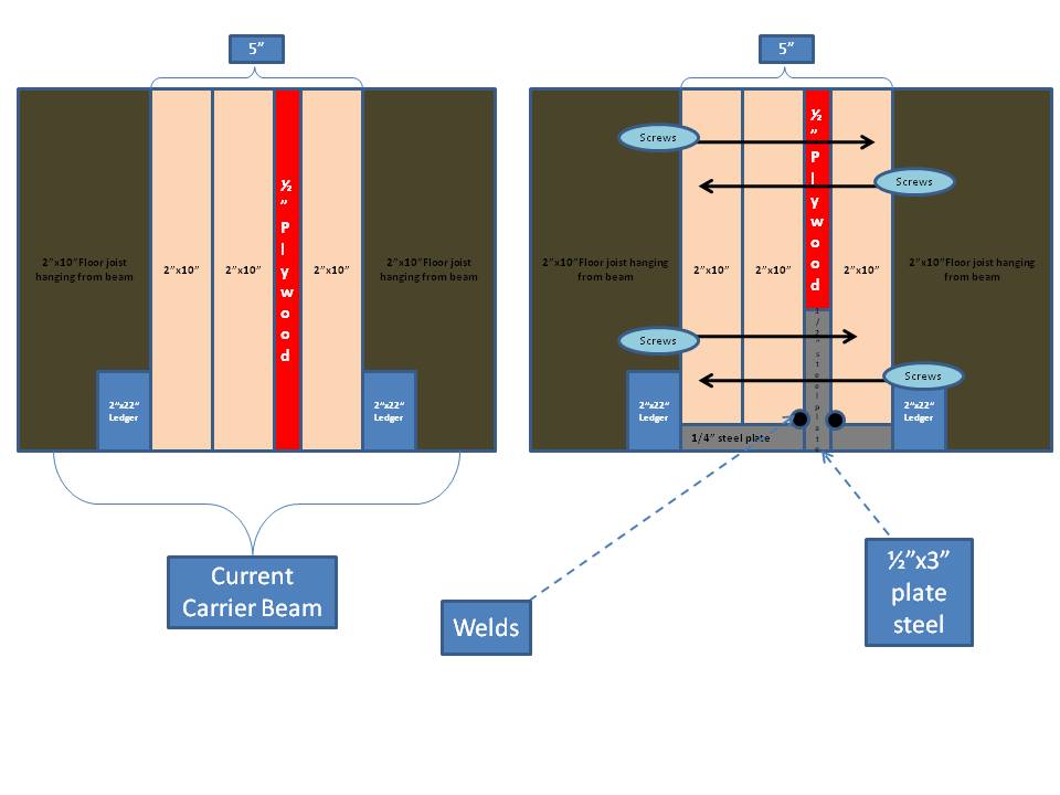

Well I'm going to for sure limit the span to 13' 7".
I'm looking at the ways to provide additional support to the existing beam.
The options are:
1. To add a beam below the existing beam made of 2"x4"x0.25" + 3"x4"x0.25" steel tube between two 2"x6" (maybe 2"x8" ripped down). The 2"x6" on the sides will replace the current ledger and keep the current beam from moving off the support beam (works for the LVL option too).
2. Cut out about 3" to 4" deep of the current beam's 1/2" plywood and insert a piece of 1/2"x3" steel with a 0.25"x5" wide steel welded to the bottom to make a upside town "T" shape (kinda like a I beam with the top flange removed). The great thing about this way is no loss of head room, but how do I cut the plywood out which in nailed in? I can think of a few ways to cut the plywood out, but all kind of scare me.
1. Use a chainsaw cutting over head and a gas chainsaw in the house not good, but if I built a depth stop and cut using the top of the bar and pulling the saw back there wouldn't be kick back issues.
2. Use a 15" circular saw and build a track so all I have to do is push in rather than hold it up and push it.
3. I think this will work best take my router (has 1/2 chuck) and use a 1/2" steel drill bit (nails would not be an issue) and build a track so all I have to do is push in rather than hold it up and push it.
No matter which option is used the existing beam will be screwed/bolt through to tighten it as show in the steel beam options.

Scout, given that I would rather weld above, than try to run a power tool overhead...you can see where I would go.
Or, what about running an additional 2 x 10? Since you are only adding what, less than 2 feet to the span, wouldn't that work? Offset to the long span side (12' 3")? Easier to get a sawzall in and cut the floor joists shorter. Run a temporary header and posts under the joists being cut (and screwed to hold them in place so they don't 'pop' and twist when cut).
Only my thoughts, not because I have any engineering knowledge. I suppose running an lvl the same way is similar.
