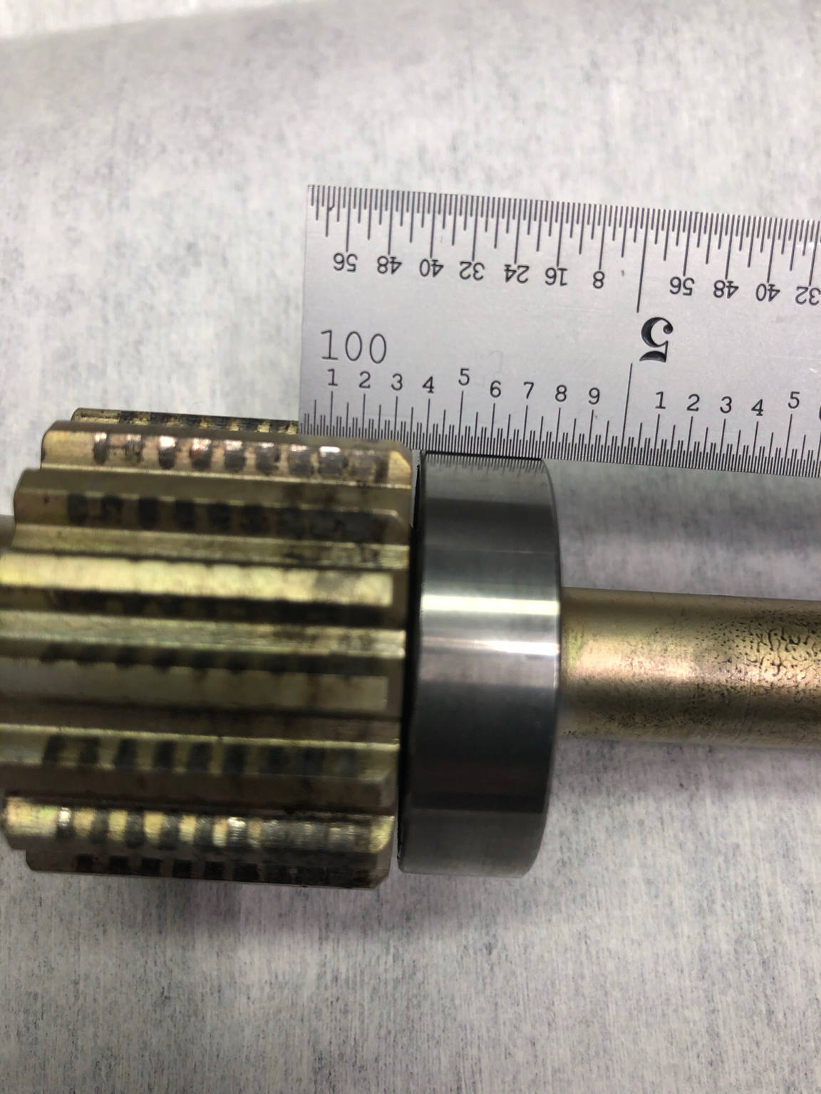

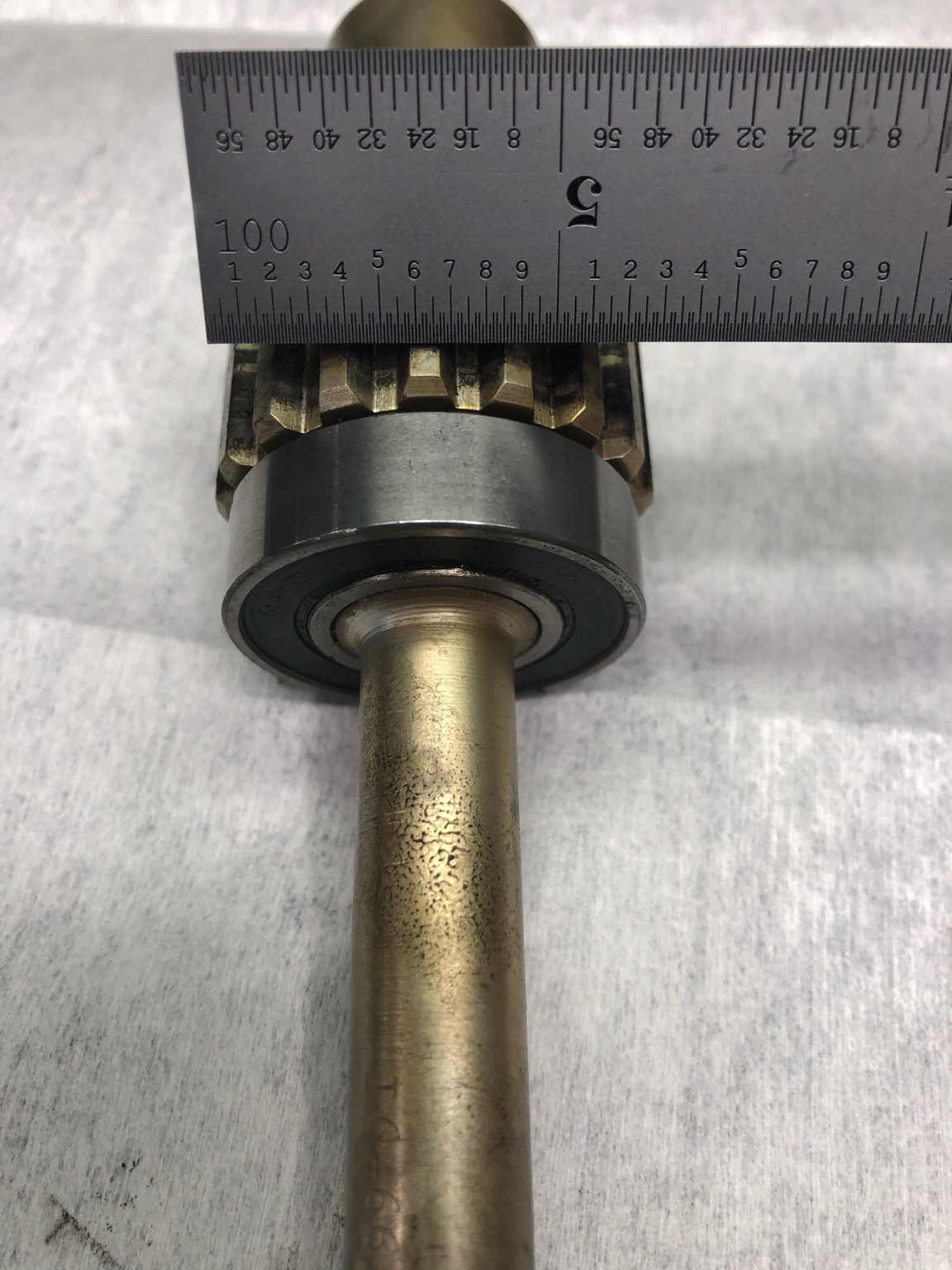

I have a problem I have thus far been unable to figure out and I’m wondering if one of you can give me an idea how I can remove this bearing without causing any damage to either the bearing or shaft.
I can’t tell you what it’s for, but it is an aircraft part. Problem is, I can’t get a new bearing, but I need the bearing removed to mag particle inspect the shaft. We need to be able to inspect and reuse the bearing. The lead time to get a new certified bearing is almost a year.
The space between the bearing and splined area is so small a standard bearing separator can’t fit between the bearing and splines.
I broke one bearing trying to hold it in a vice so I could press out the shaft.
The bearing is a press fit on the shaft and it took a about half a ton of pressure to get the inner race of the broken bearing off the shaft.
Is there a special tool that could help me?

Can it come down shaft or has it gotta come off gear end? Can't tell from picture if bearing is shouldered on shaft size.

The shaft/gear part is one piece. The bearing comes down off the shaft. The inner race is up against a small shoulder.
I have a Proto bearing separator, but the two sides of the wedges are too thick to get between the bearing and separator. If there was more space between the bearing and that large portion of the shaft, this wouldn’t be an issue.
The other issue is I don’t want to gouge the cadmium plating on the shaft or the shaft itself.
Is there a bearing separator that is very thin that could get in there?
I have an induction heater that I could heat the bearing with, and I I am wondering if I combine that with spraying the shaft with a cold shot, that the bearing might loosen up. I don’t really think that would work though. I think the diameter of the shaft is too small to get enough separation to let the bearing fall off.

If it took that much force to get the other one off, I can't imagine that a bearing separator that would be thin enough to get in there would hold up to the pressure.
It kinda looks like it might be from a magneto, do you have a component overhaul manual for (whatever) it is? That might spec out the removal process.

The correct bearing splitter has knife edges and could easily get between the gear and bearing. It looks like the gap is about .040" so that is plenty of room to start.

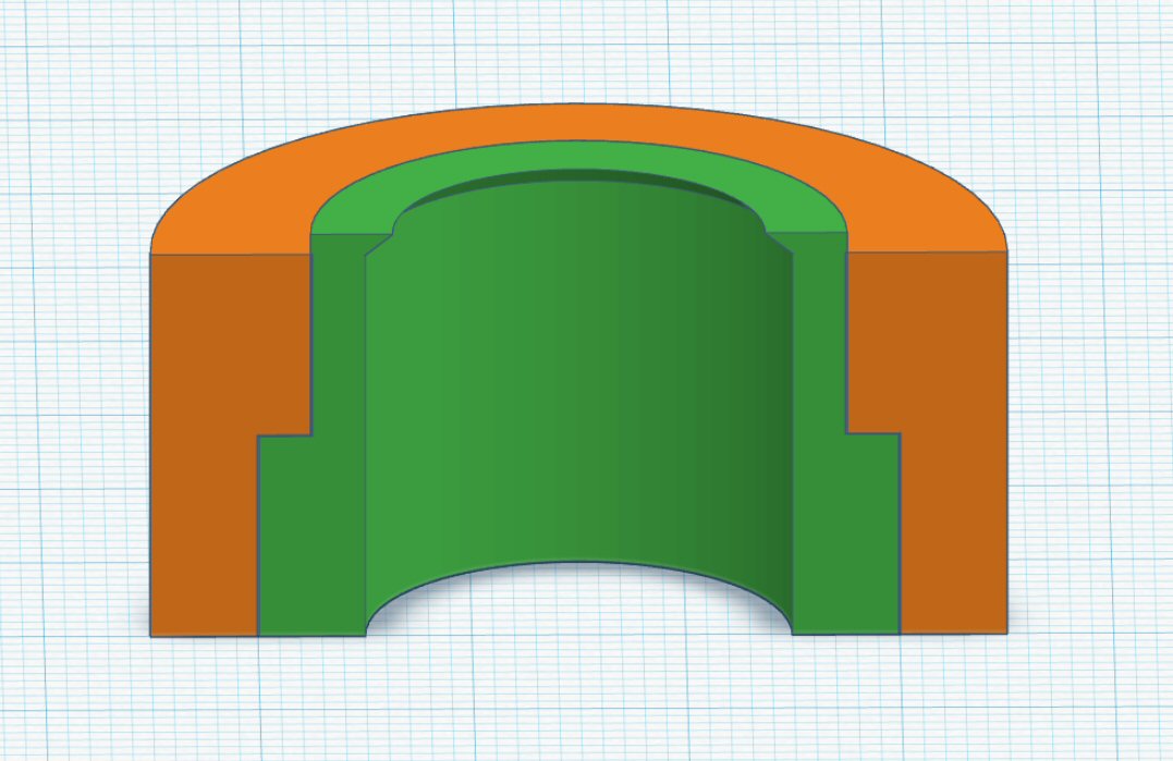

It looks like about the only way to get that off without damaging either part would be to have a collet made that would be in a couple pieces with a small ridge at the bottom to catch the bottom of the bearing race,a capture sleeve would be put over it to clamp the collet in place and give a surface to press against.
Maybe this drawing will clarify what I mean.
I had a similar problem years ago on a governor shaft on an old stationary engine.
Had a machine shop make the collets, and it pressed off no problem.
