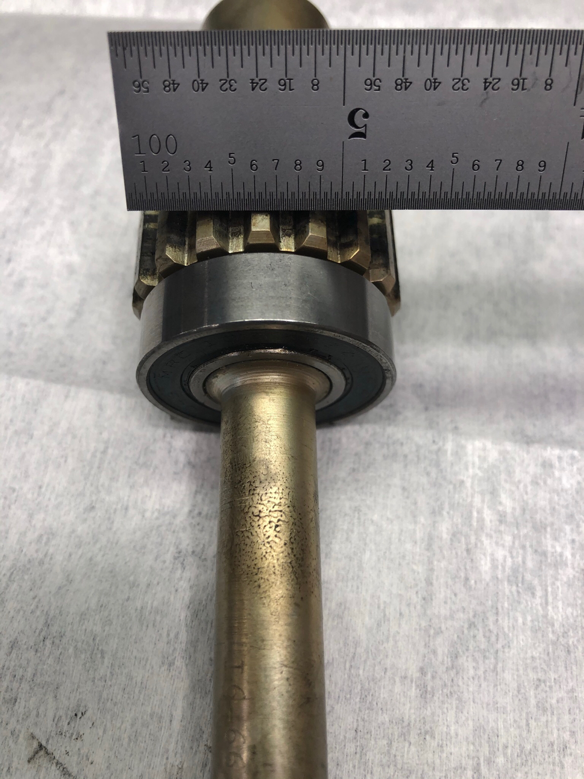

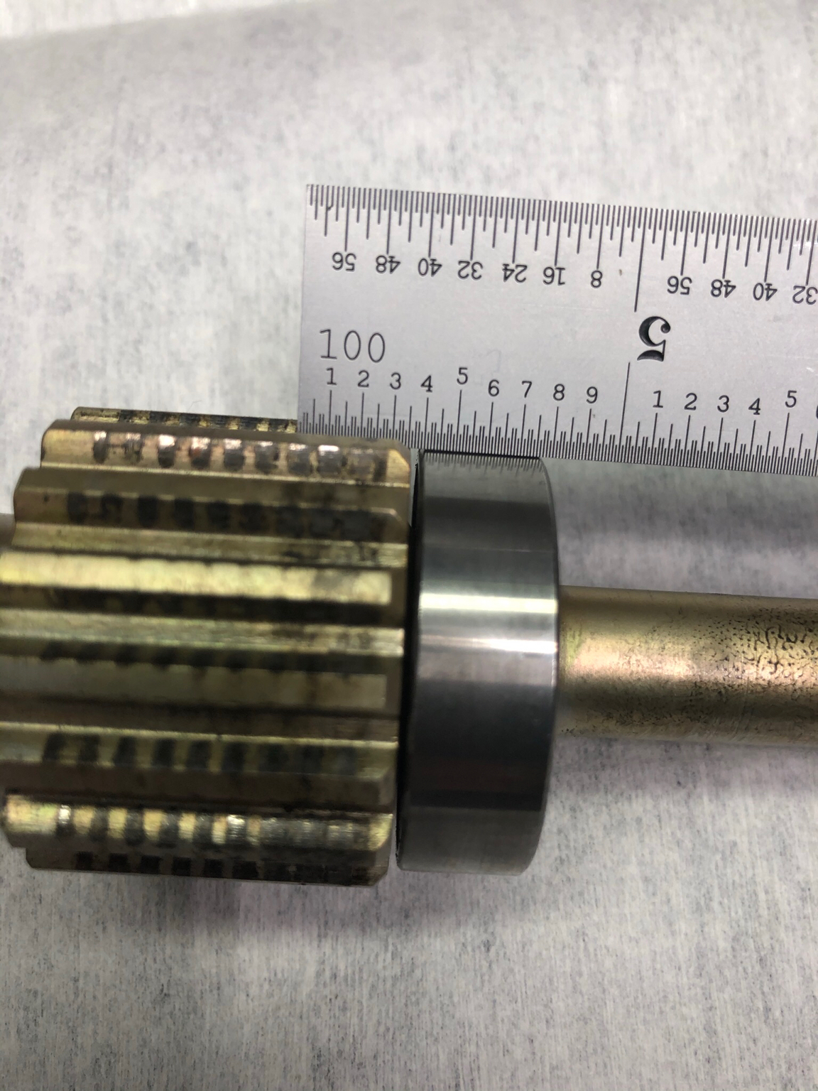

I have a problem I have thus far been unable to figure out and I知 wondering if one of you can give me an idea how I can remove this bearing without causing any damage to either the bearing or shaft.
I can稚 tell you what it痴 for, but it is an aircraft part. Problem is, I can稚 get a new bearing, but I need the bearing removed to mag particle inspect the shaft. We need to be able to inspect and reuse the bearing. The lead time to get a new certified bearing is almost a year.
The space between the bearing and splined area is so small a standard bearing separator can稚 fit between the bearing and splines.
I broke one bearing trying to hold it in a vice so I could press out the shaft.
The bearing is a press fit on the shaft and it took a about half a ton of pressure to get the inner race of the broken bearing off the shaft.
Is there a special tool that could help me?
Hydraulics... a blind cylinder to hold the gear, two half circles of shim stock to blank off the bearing race, lip seal to the outer race to the cylinder... then pump grease to the cylinder at the gear through a zerk. The grease will flow past the gear to the bearing. But the grease can't pass the bearing because of the shim stock. If the grease leaks past the half circles, then use multiple pieces to act like piston rings.
If you can move the bearing the width of the outer race, you can then use a knife edge to pull it off the shaft.
After some consideration, might not need the shim stock since the bearing is sealed and you'll have to restrain the shaft to separate the two.
Outer 1.25 diameter area minus ID .5 area = about 1.00 in sq.
1000 psi x 1.00 in sq = half ton pressure. grease gun should be able to develop 7,000 psi.
