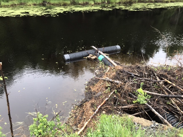

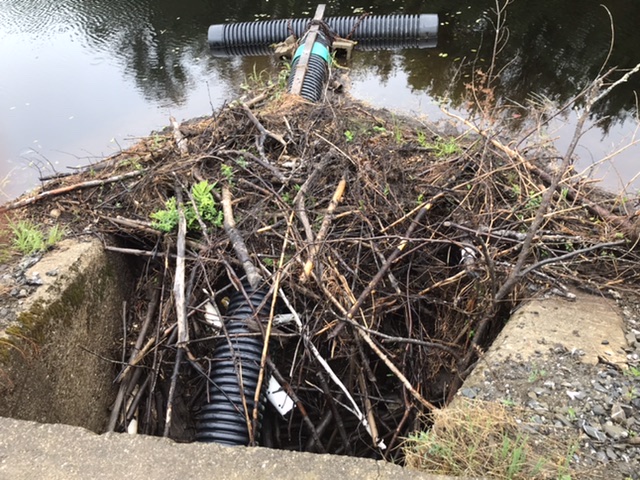

These have been discussed before, so I thought I"d post a couple of pics of one in action. They're on a concrete culvert on an old RR bed in the central Maine township of Lakeview Plantation.
I don't know the exact details but judging from what I saw they were placed to keep a problem area from destroying the road bed. 5984A2D0-DCCA-4909-871E-123D0CC57DA9.jpeg8B7E0565-D1E1-417D-A052-863591E305C0.jpeg

Not bad idea,wonder happens if heavy rain flash flooding.
   / Beaver Deciever #3
We did this years ago but added 2 more 'T's' at the ends.
Theory is beavers detect the leak by detecting the currents so the less eddys the better.
I saw similar installations using simple stove pipe but it rusts out quite rapidly.
Our best dam deterrent was using galvanized an 8 inch culvert that the city donated.
As to major flash flooding, the water simply spills over the top of the dam.

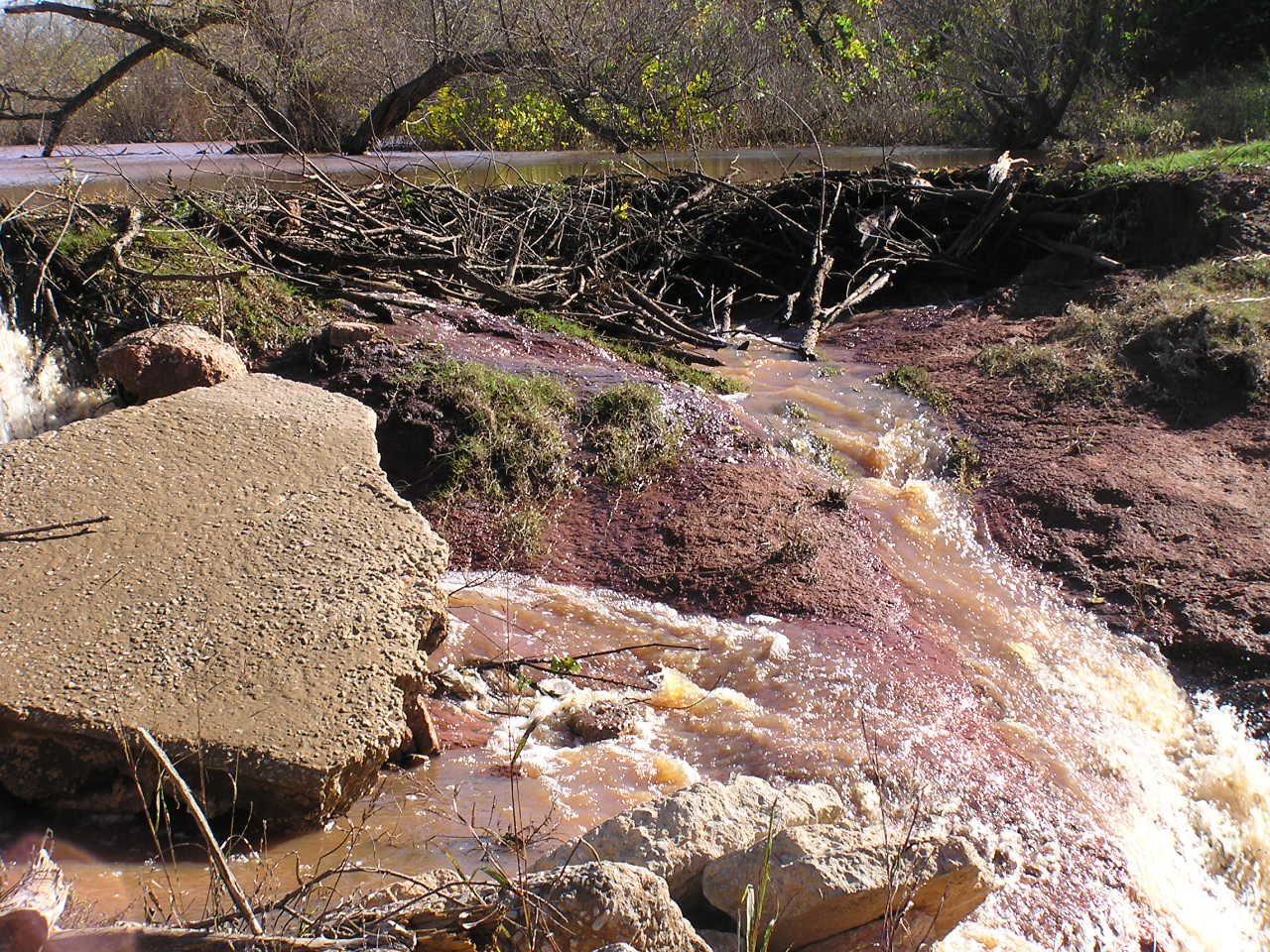

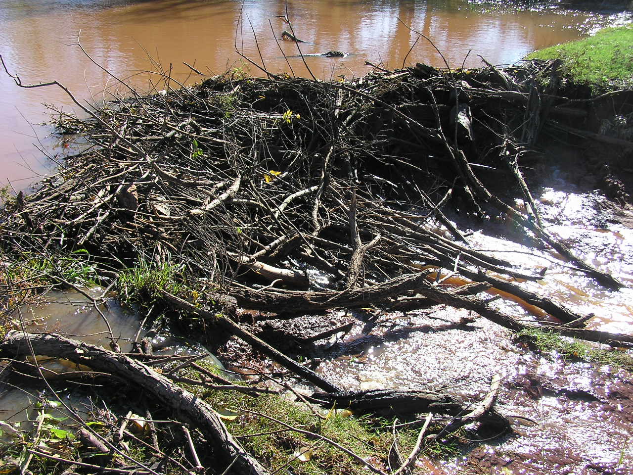

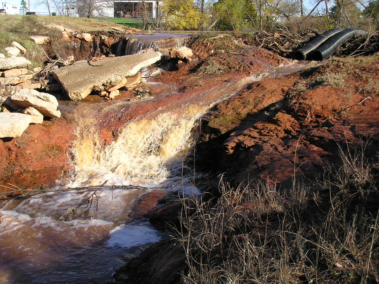

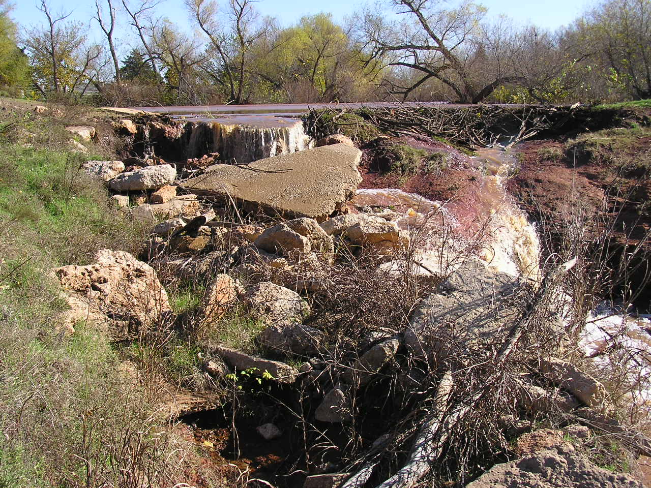

Pictures from 16 years ago. Beavers built a dam on the pond spillway:

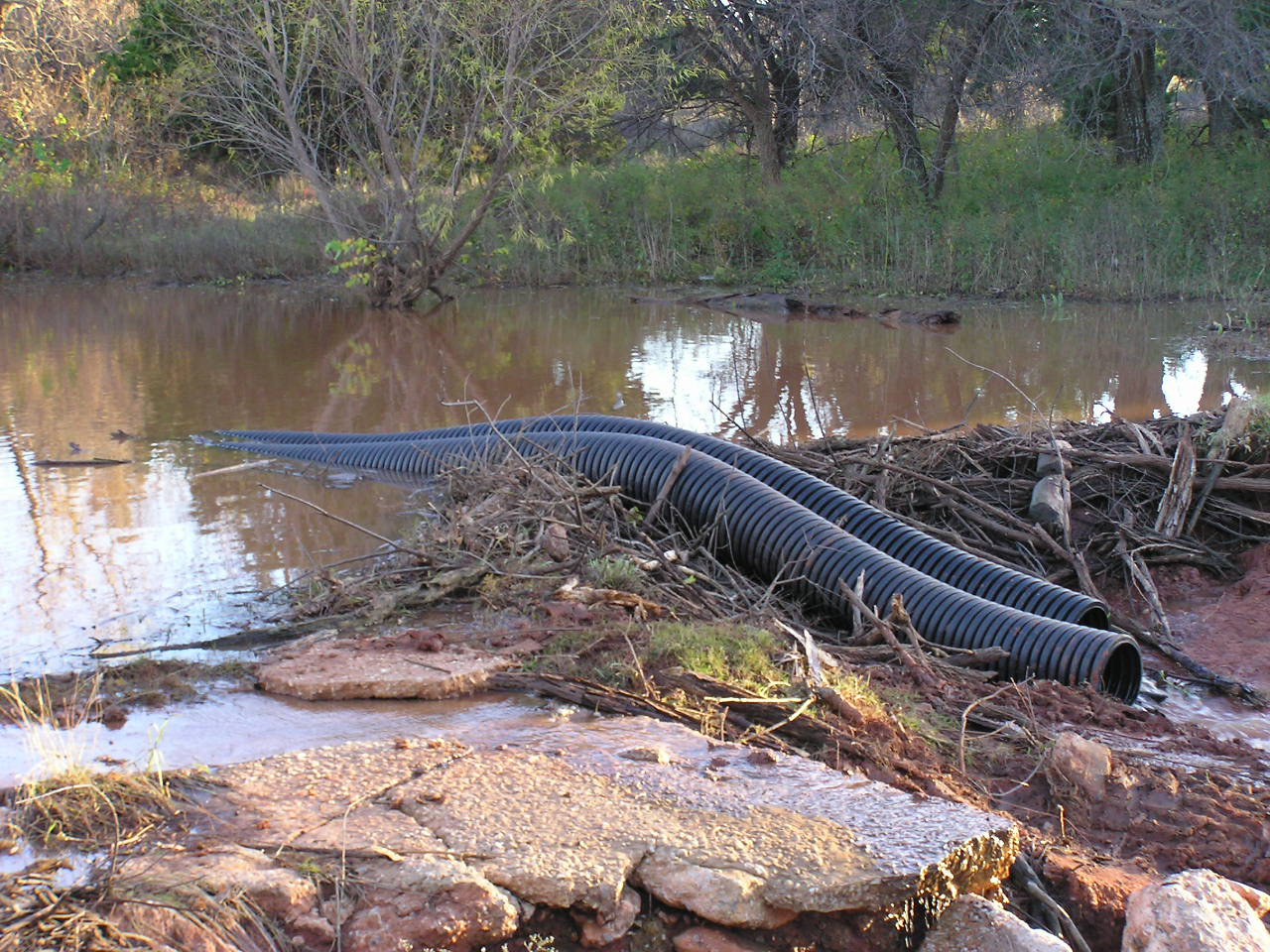

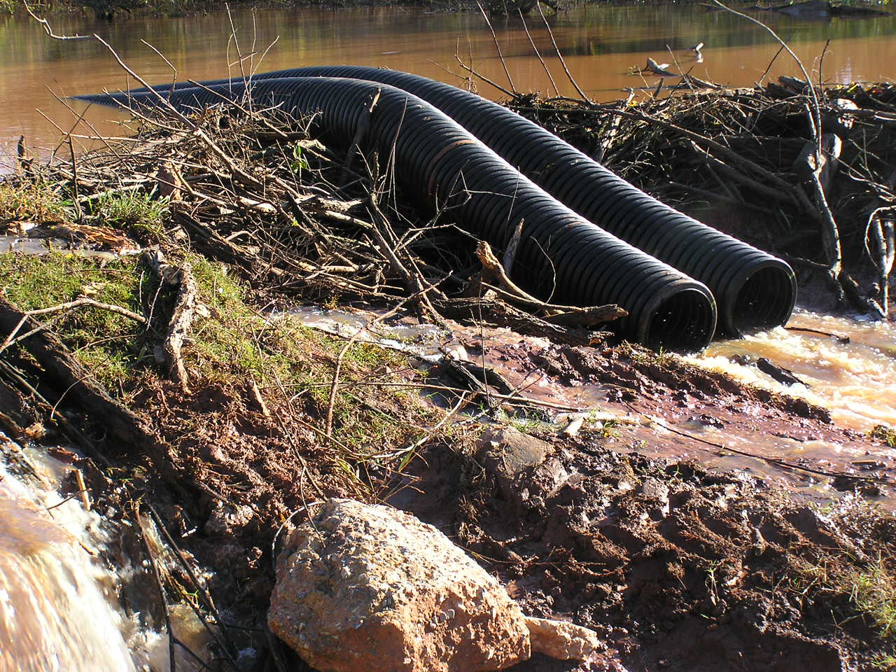

I put the 12-in Corrugated Culvert over the dam and staked the other ends down under water:

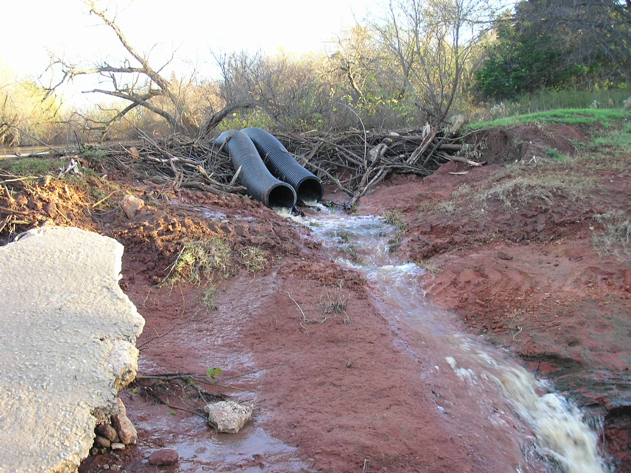

As the water level would rise it would flow through the pipes:
The beavers packed sticks around the pipes at their dam, but no where else. The pipes would siphon the pond down until air entered the pipe.

The family of beavers on my lake have built a low dam at the outlet. Looks just like the pics Xfaxman has posted. There are no siphon pipes on the dam. There is an overflow bypass just like on the very bottom pic. Water gets high - flows thru the bypass until it's lowered.

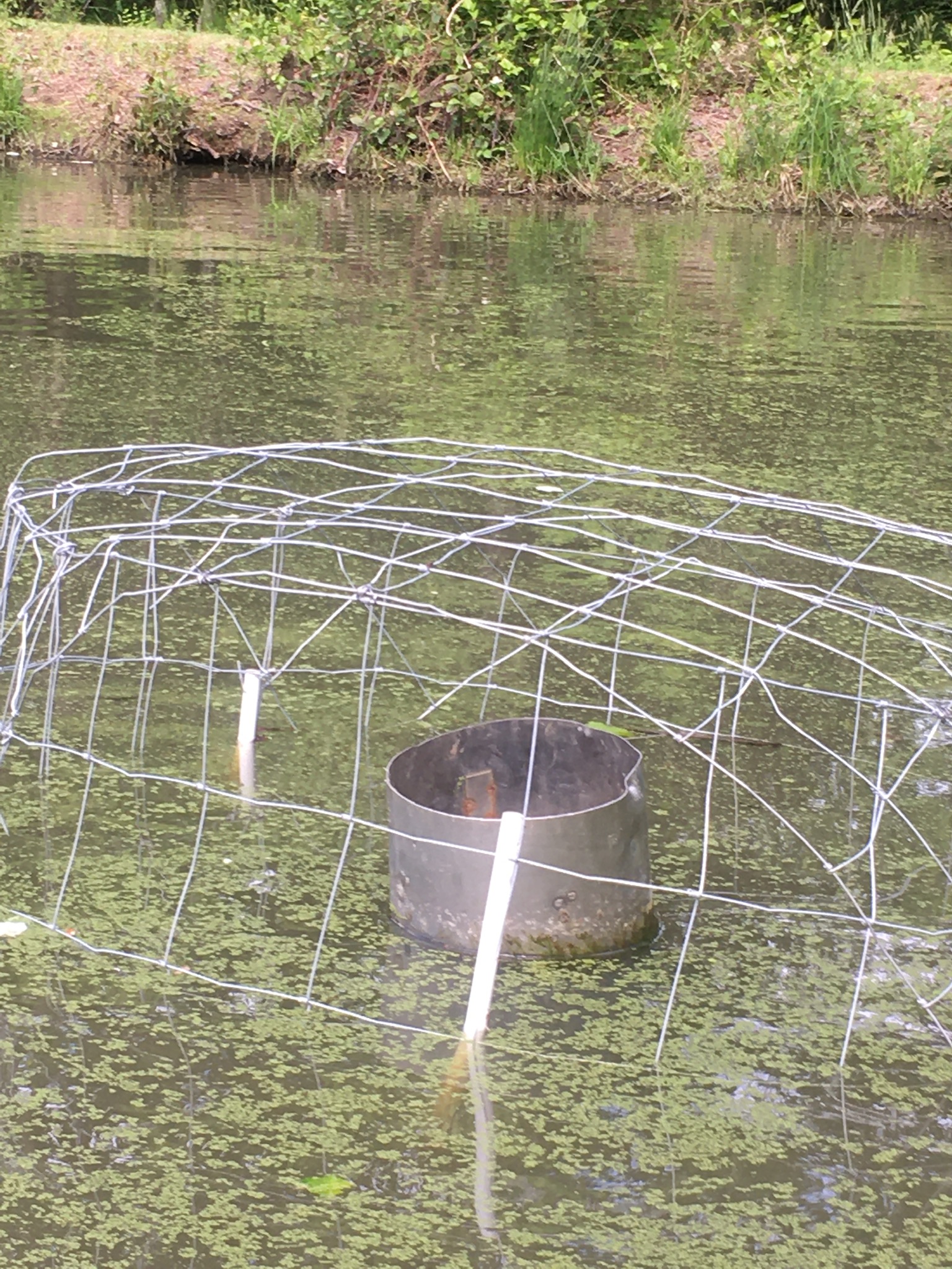

I have a beaver excluder over the pond overflow. The stinkers built a ten foot seamount from the bottom of the pond to the inlet area. The 6x6 mesh is to keep them away from the inlet. So far over the last three months, it's done the job.
