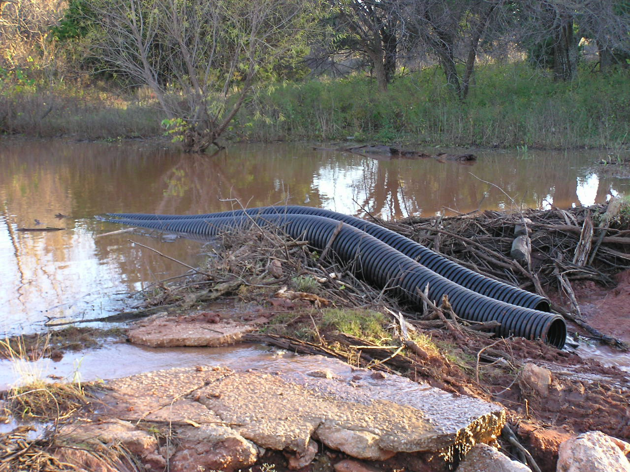

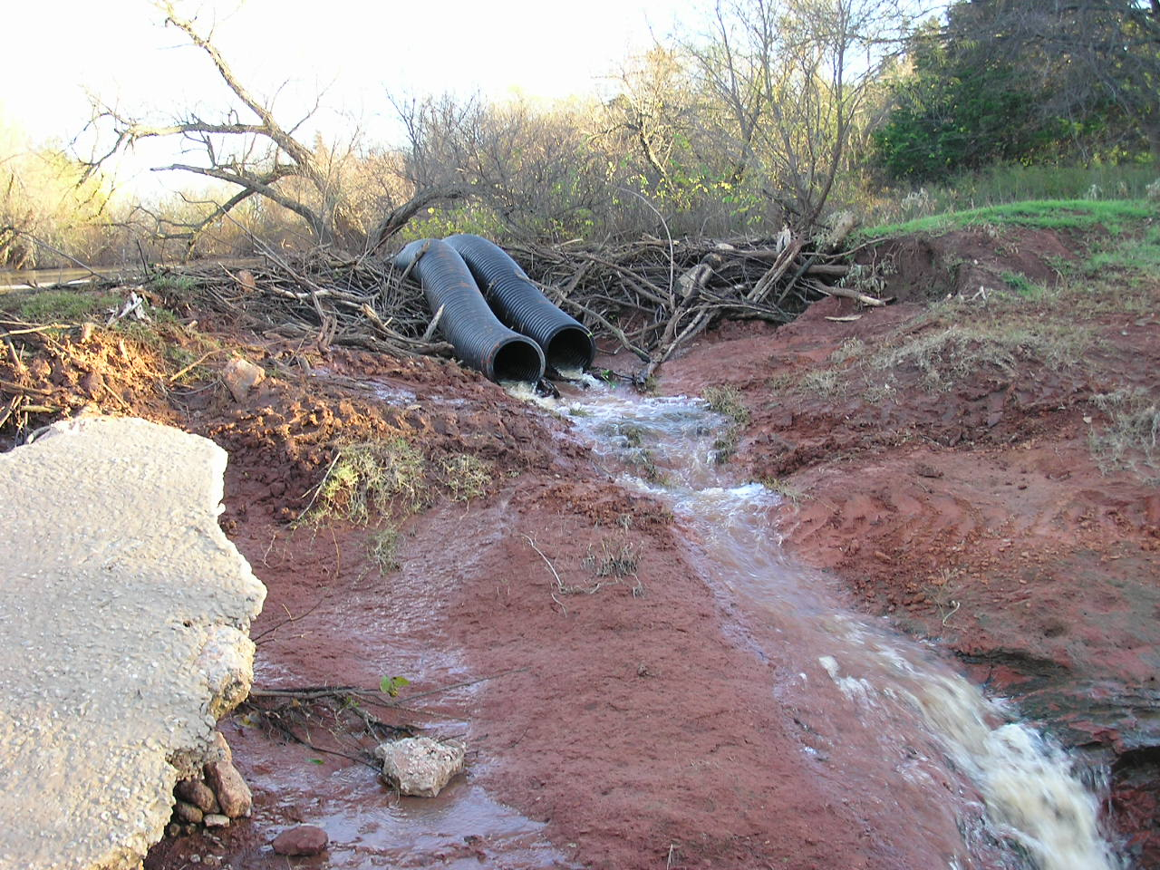

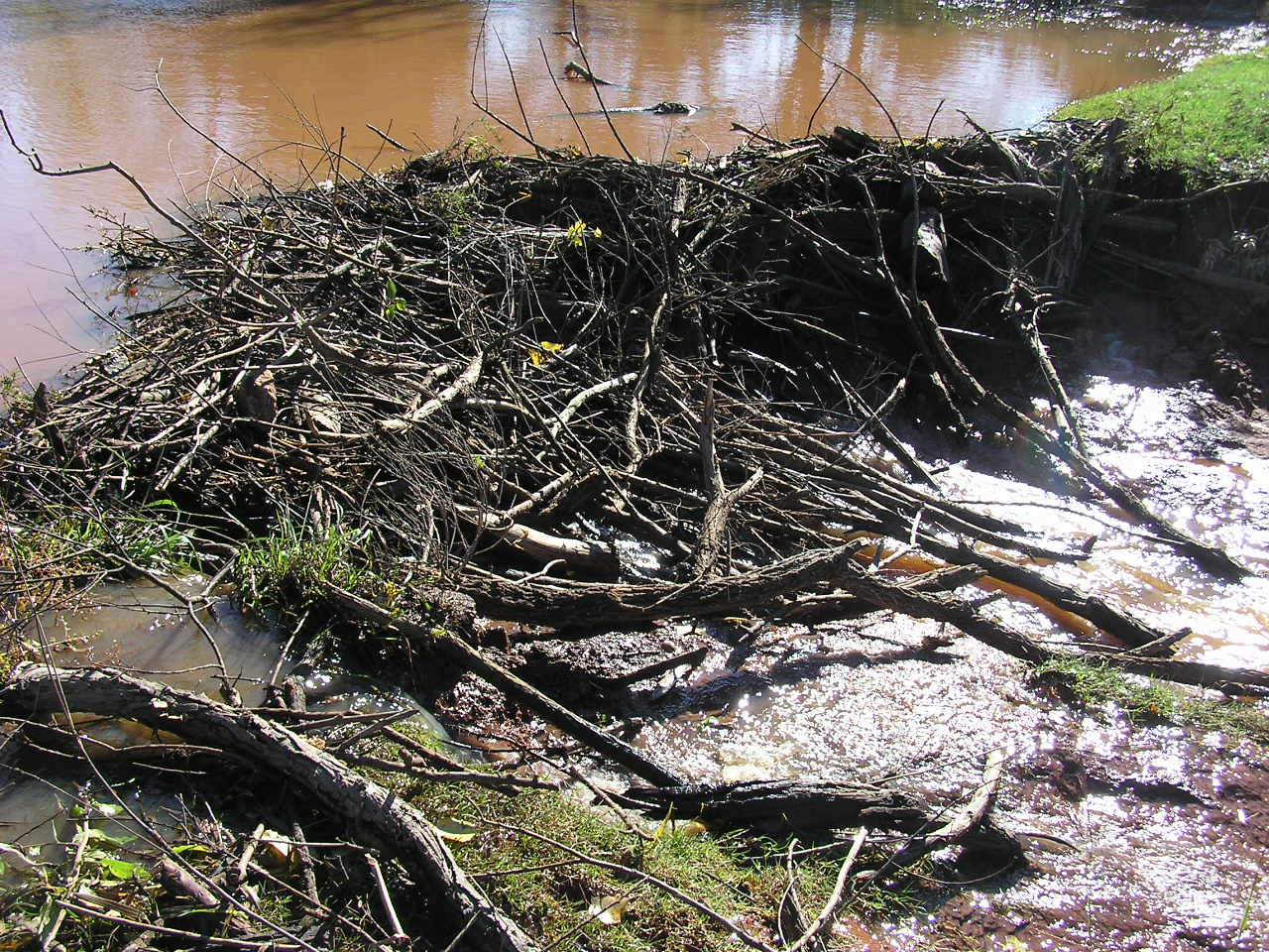

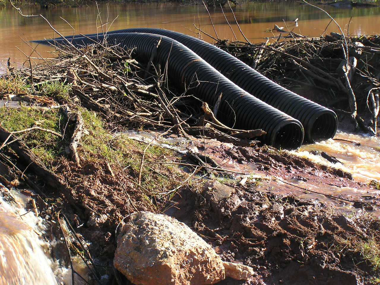

This is how I fooled the beavers that were damming the spillway:
Staked the inlet down low, water would continue to siphon until level dropped low enough to let air in, breaking the siphon.
