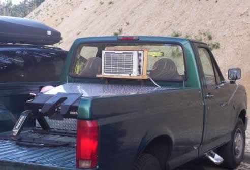

I believe this fella put a 5th wheel hitch in his 1/2 ton pickup along with adding aftermarket A/C.
You've got to be kidding me! looks like the punch line of a Jeff Foxworthy joke :)
JB.
