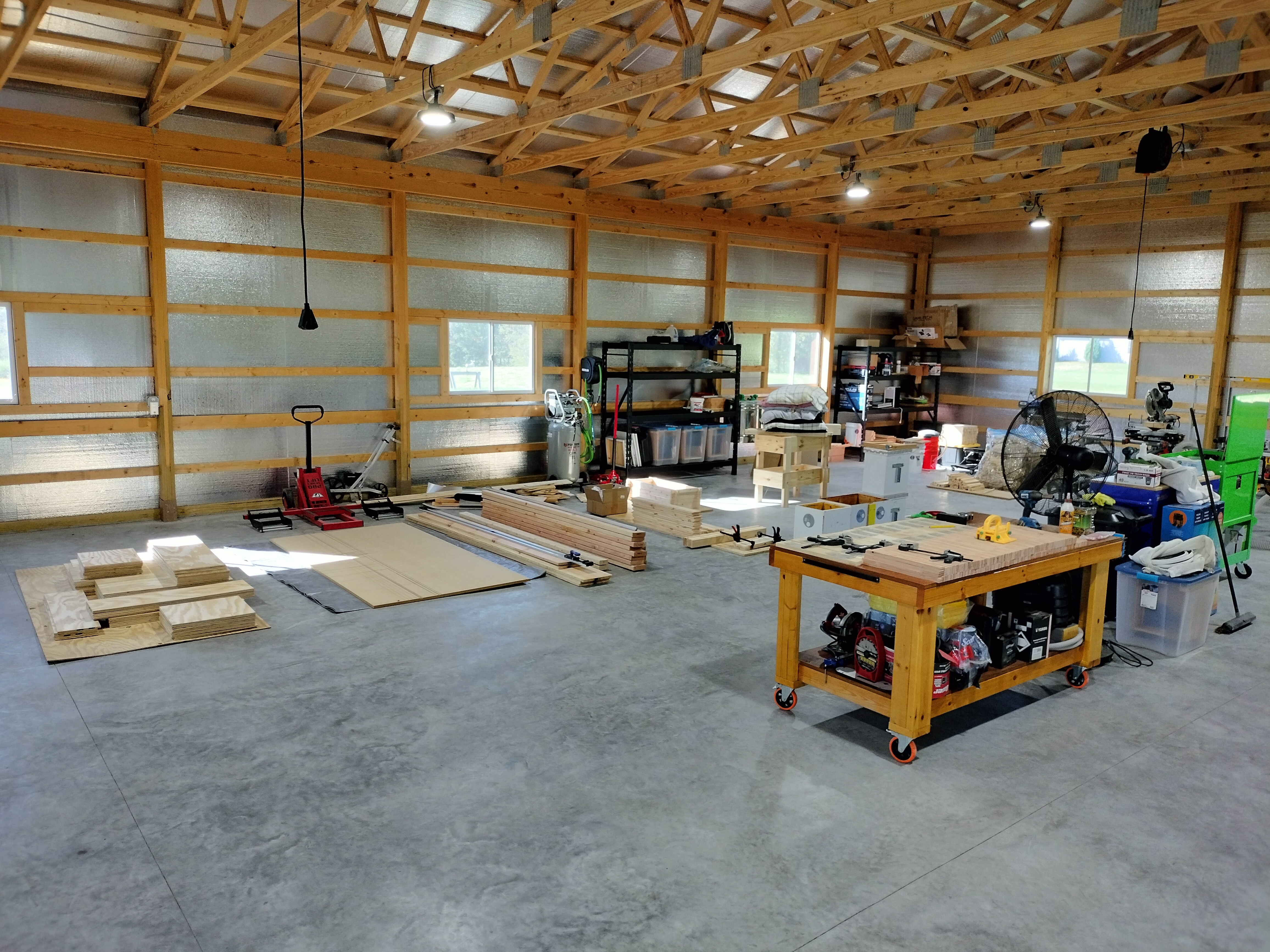

Off to buy another $1000 in lumber for hives and stand builds this winter.
Its a good feeling having the shop stocked for 5 months of building. Now I can just hibernate.

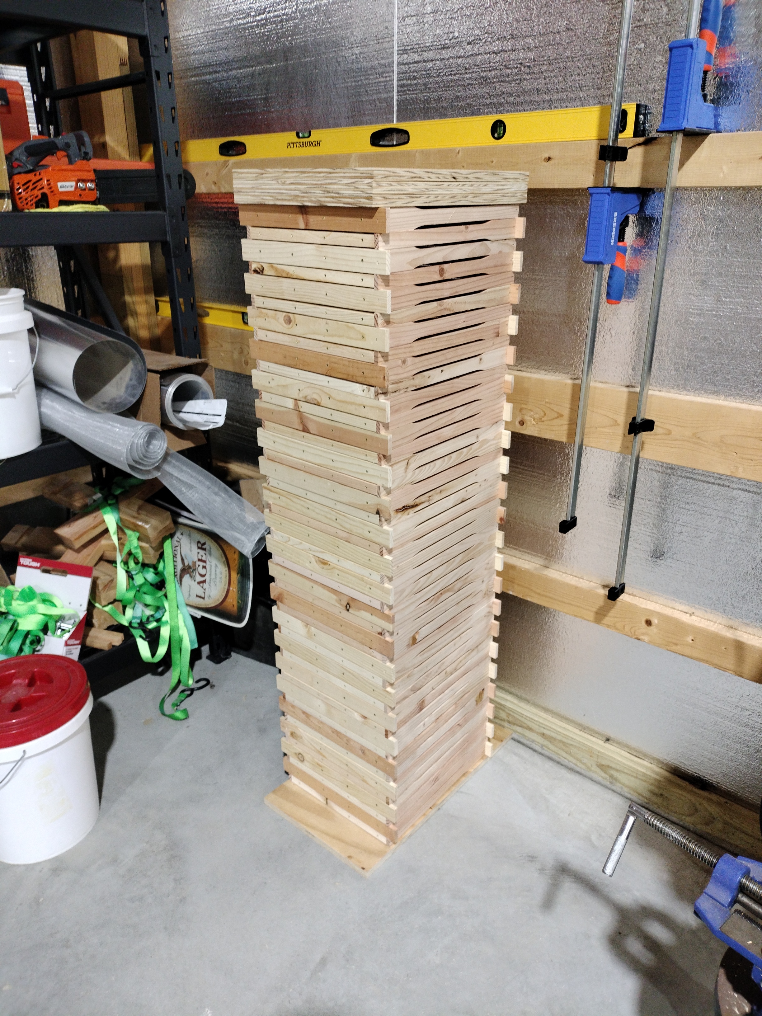

These new frames are turning out amazing. I think I'm on track to build my 700th frame!

Is that an SAF Natura honey extractor in the background 2 pictures up? If so, the layens version?
/ Beekeeping #747
Yessir. Its a SAF
I'm always amused by the details that stick when I'm researching something. The green legs and shape of the tub looked very familiar to me.
The used extractor I bought is a manual 9 frame radial/3 frame tangential SAF. Looking forward to getting to use it next year.

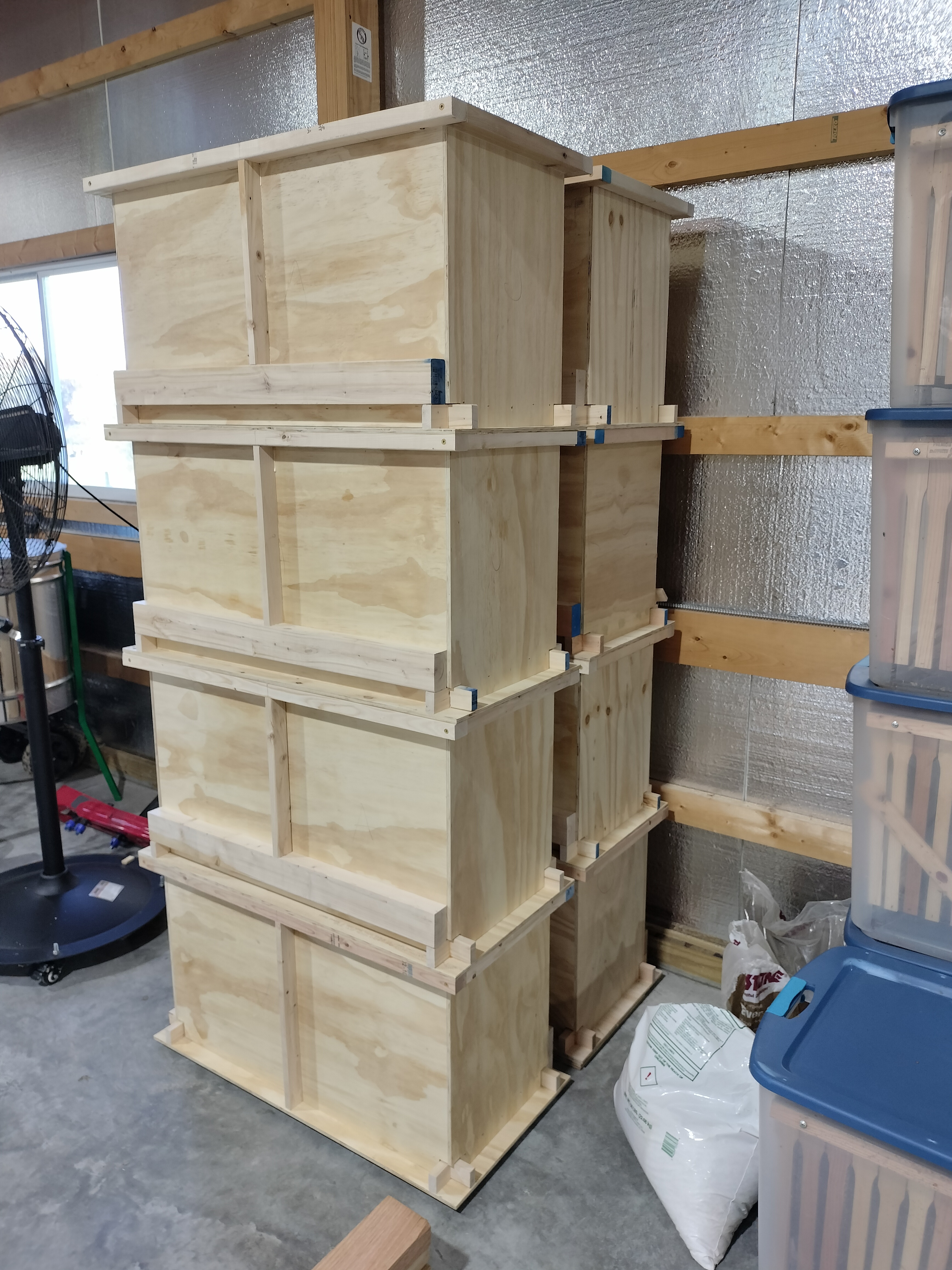

So this time around I enacted a few more quality control measures for these boxes in a box... Wow, what a difference. Keeping the inner and middle components aligned so that the outer panels align perfectly, has been a challenge. But this time around they are amazing. I planned to build these orders over winter... But it seems I'll be finished by Dec 1

What did you do differently? (Looks gorgeous)

I have begun measuring corner to corner for all of the interior walls to ensure they are centered to the bottom. Also made a jig to ensure the interior wall heights are correct and uniform. They are all within about .015" after assembly. Those set up your exterior walls, so if they are off, your exterior walls will be misaligned
It's really an issue of stacking tolerances as you build them from the inside out. The original plans do not address that issue or any ways to mitigate it. I've been building them for about 5 years and each time tweak the process. These are by far my best boxes ever.
