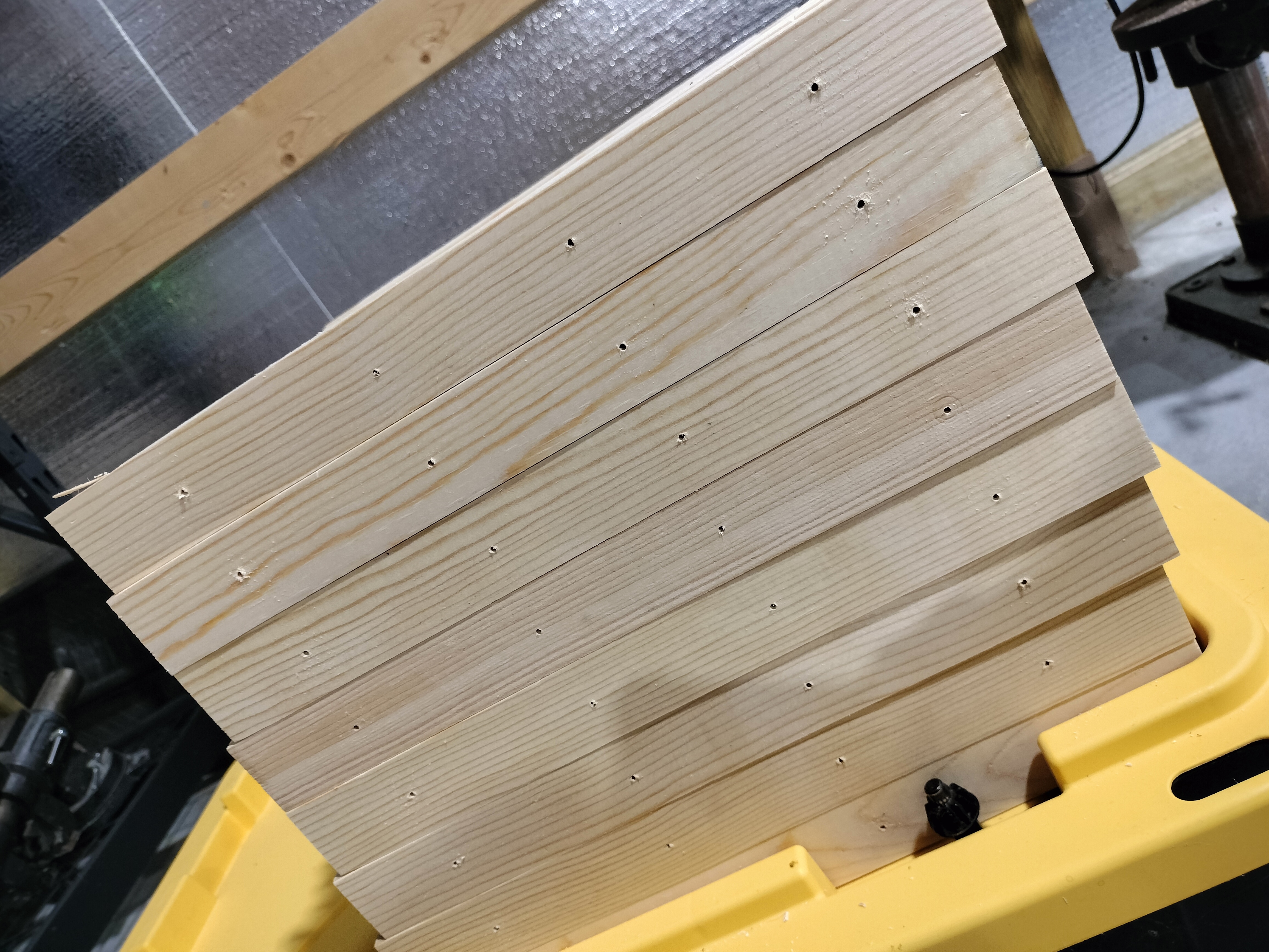

Getting ready to put the bees to bed this coming week. The fall flow is starting to diminish. Also building hives for next springs orders. Out of the fields and back into the wood shop.

How does that box separate the brood from the honey? Nice looking boxes. I am planning to start building mine vs buying them this winter.
/ Beekeeping #724
Bees naturally separate brood from honey. No need to do anything to force it.
I had a couple guys contemplating building their own. Then they looked the tools they needed, the time it requires, and decided paying me a paltry $300 in labor per hive was money ahead. Especially when factoring in build quality.

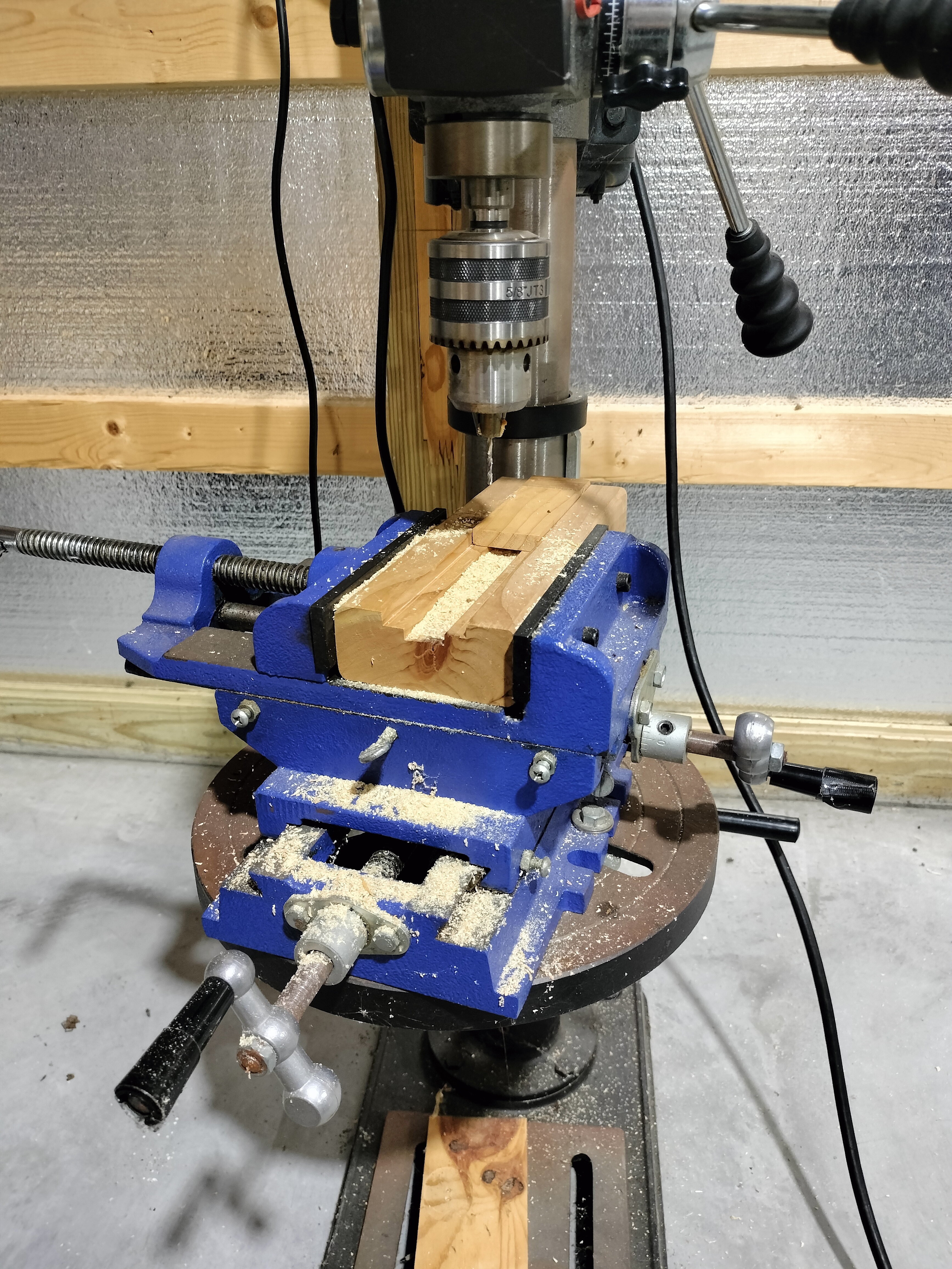

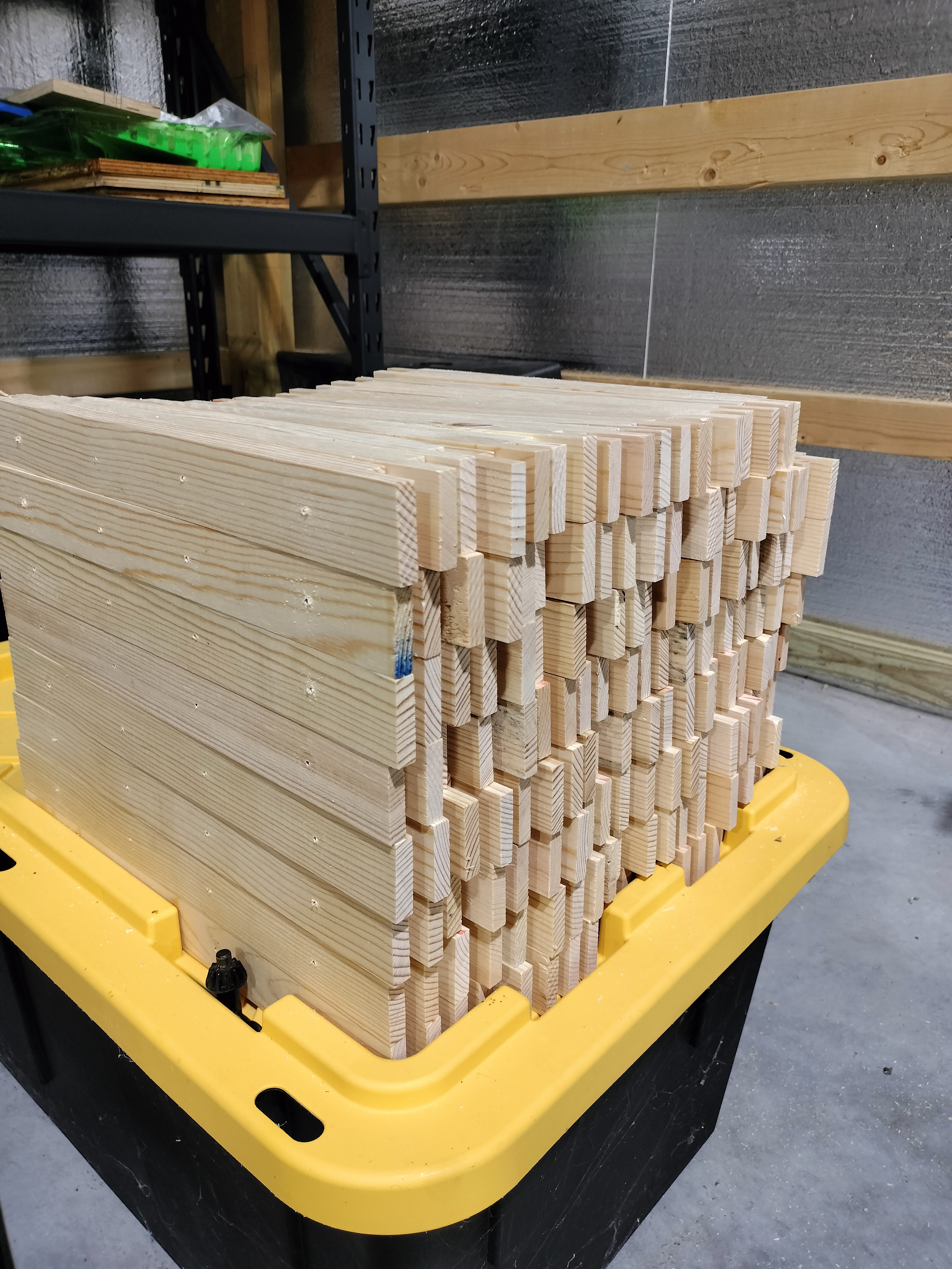

Also, last winter I did start sending all of my 2x material for frames through the surface planer, to get it all within a few thousands of an inch. That way it all mates up well in the assembly jigs with the other components. I've had beekeepers buy frames from me, and throw out ones they have bought from other providers, simply because the attention to detail is so poor from other wood workers.
Yes they are boxes for bees, but it doesn't take a significant amount of time to make a precise part vs a non precise part.

I think that having/making standardized inputs yields all sorts of benefits in the subsequent processes. Very wise.

I do not, no. I have a well tuned DeWalt job site saw. 7491RS
So speaking of standardized... I use digital calipers to check widths and thicknesses for parts. Some parts are intentionally cut .010" undersize to aid in assembly.
When you start stacking tolerances, things go wonky pretty fast. Stretching a tape on these smaller parts isn't enough.
