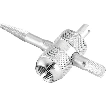

/ Beet Juice Shower! #15
Having one of these can go a long way to prevent such accidents. You can use the wrench end to tighten and remove valve cores. and the inside and outside thread taps/die to touch up the threads if they are "boogered up"

/ Beet Juice Shower! #17
Those are very handy to have indeed.
/ Beet Juice Shower! #19
I HAVE one of those somewhere. It would be quicker to go to NAPA and buy one than find it amongst all my stuff.
