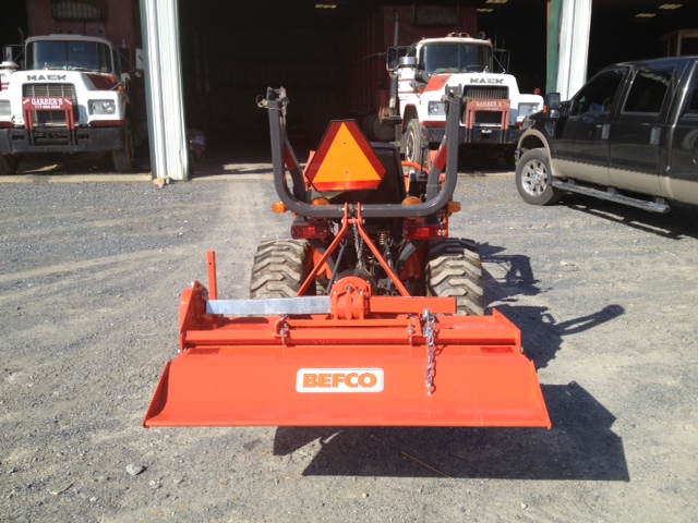

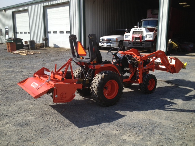

OK, so I got my Befco tiller and was finally able to sink it in the ground. I am truly pleased with the results so far as this thing really digs up the soil. Also, I was pleasantly surprised to see the color match was almost spot on with my Kubota.:thumbsup:
