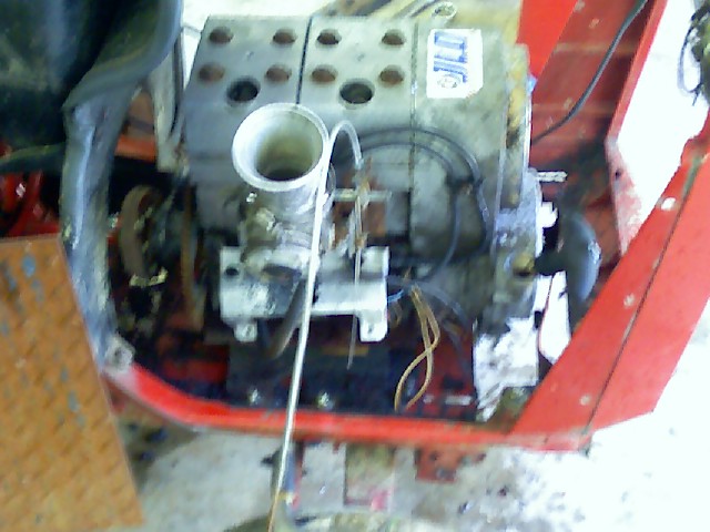

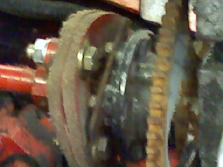

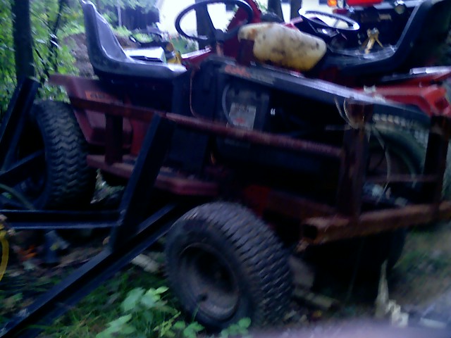

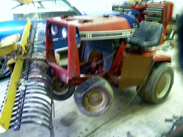

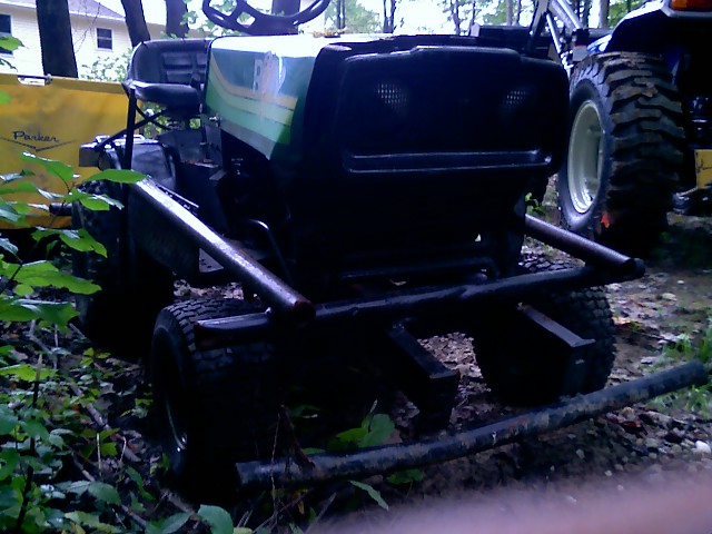

#9
Hi guys, got 440 installed in cub , driveshaft hooked up and angle set, and mounts bolted to frame. will now remove engine again to rebuild carb and replace points and condensors, sprayed some gas down carb and pulled rope, fired up and idled for a few seconds, but is in good need of tune up. I have also posted pictures of two of my demo tractors other than the cub. this is my first time trying to post pictures and attach them to a file , so if the link does not come up here, you can go to the photo section of this site. stay tuned for more photos and updates later this week.P.S. sorry for poor quality of photos, they wiil be better in future
