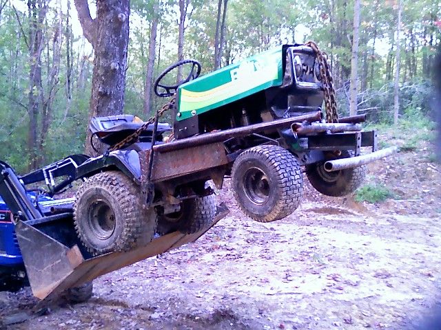

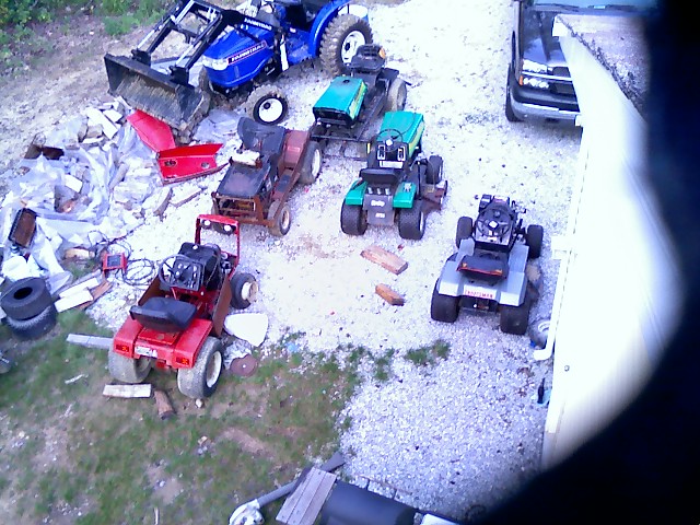

Dug my old demo mower out today, here is a better picture of it. I aquired two more mowers today, so I took a picture of my entire fleet of them, the wife has put her foot down and said no more until I get rid of some junk, she was not happy [IT IS EASIER TO BEG FOR FORGIVENESS THAN ASK FOR PERMISSION sometimes]. I was just informed this evening that derby has been moved back to 9-30-06

Hello all, have not had time to check in for a while, I have not done anything with cub after installing electric starter from briggs engine. What spare time I have had has been spent preparing the murray demo mower and a friend of mines demo mower for the upcoming derby on the 30th of this month. I found the frame damage on the murray to be much more extensive than I had thought, requiring 2 evenings of straightening with a JD 440 log skidder, my 270s loader and a rosebud torch tip, but as of this writing, it is ready to go and , as promised, my wife will be video taping the whole thing and I plan to download the video on youtube and post a link to it on this thread, sadly the cub will not be running in this one, but there is another one scheduled for the 1st week in November and I will try to have the cub sorted out in time to compete in that one. so stay tuned!!
