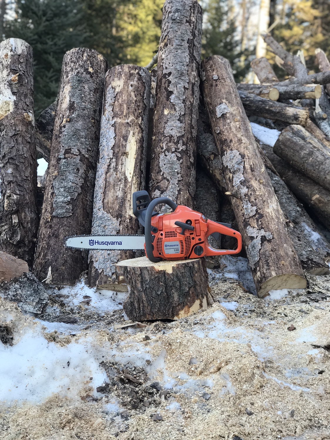

Thanks for the replies everyone! I went down to the chainsaw dealer today and ended up buying a Husqvarna 135. Really appreciate everyone’s input, thanks again! IMG_3245.jpg
