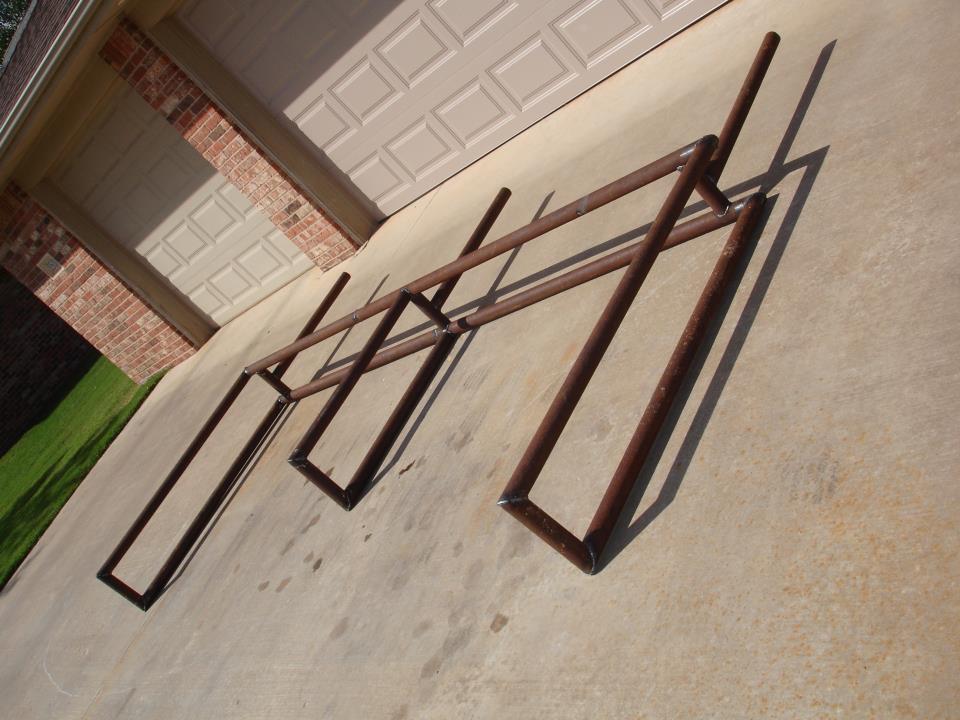

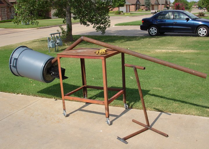

I have a Hobart 135 Handler. It's a 110 volt MIG. I have no training and simply read the instructions and practiced a few welds before I started actually assembling stuff. I've built a stand for a meet grinder, a jack/stand for my ZTR, a wood rack, an over-engineered target holder, and some deer feeders.
Colt made men equal with the Peacemaker but the MIG makes the unskilled look competent. I have access to more capable gear but I really enjoy welding in my garage at home.
