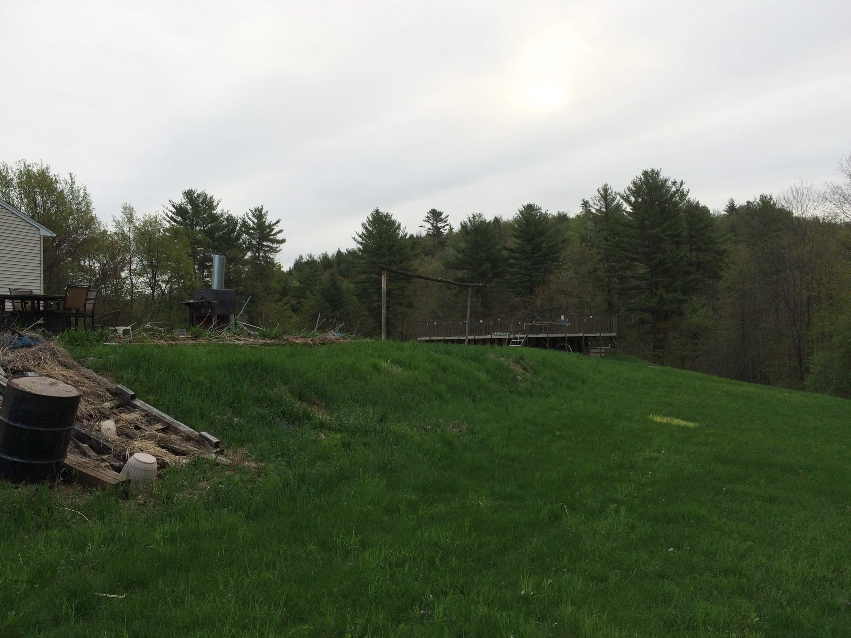

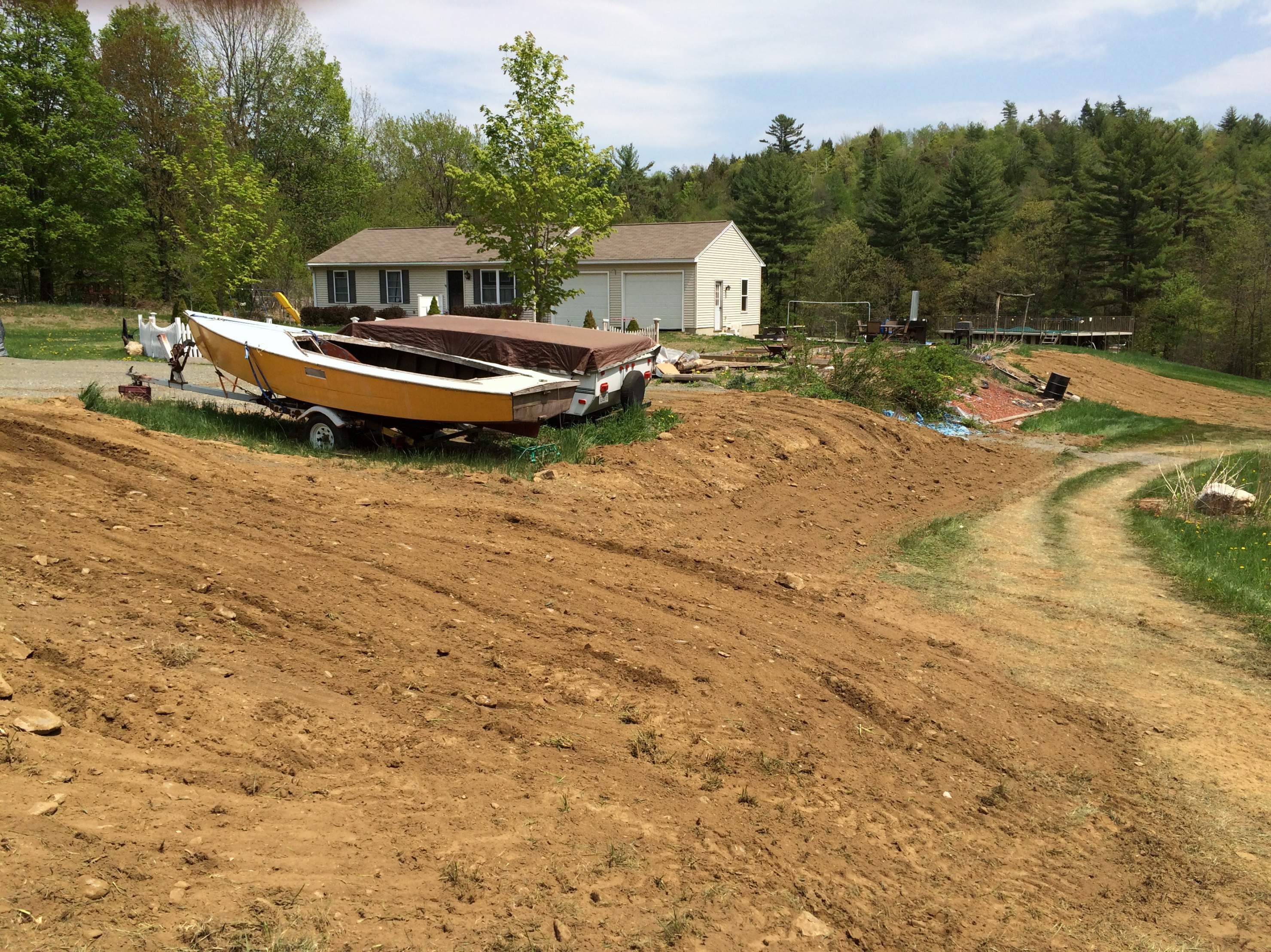

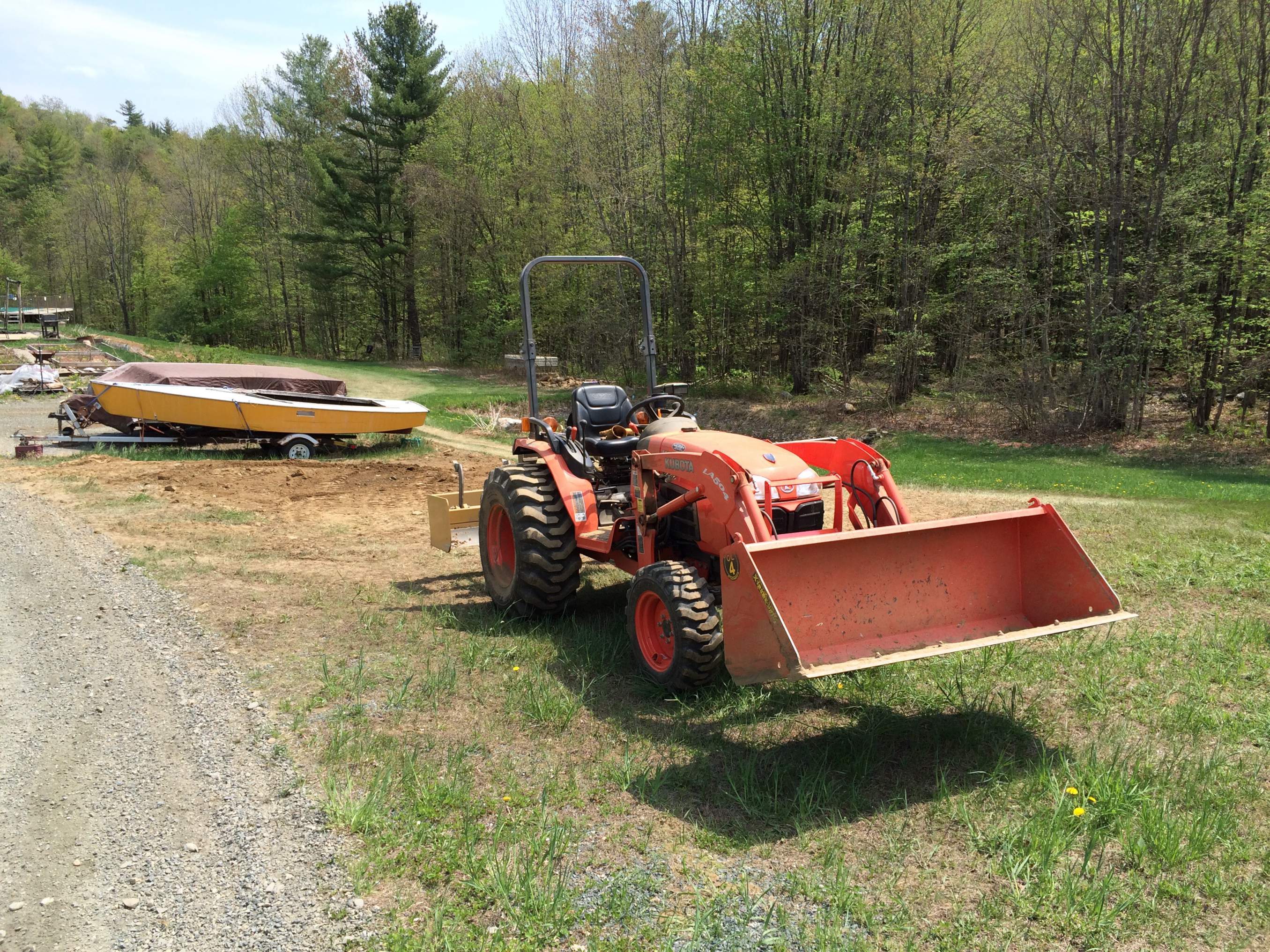

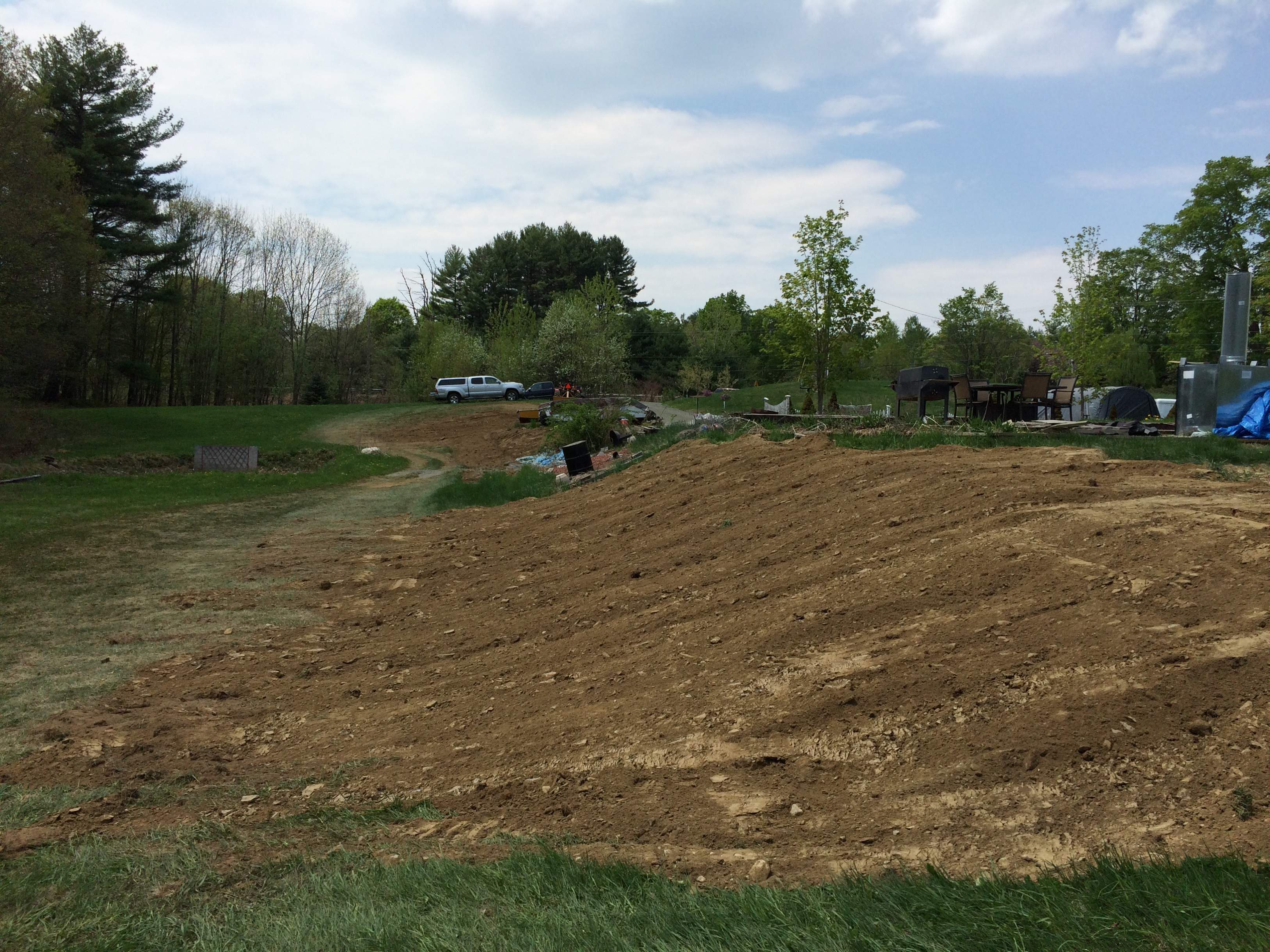

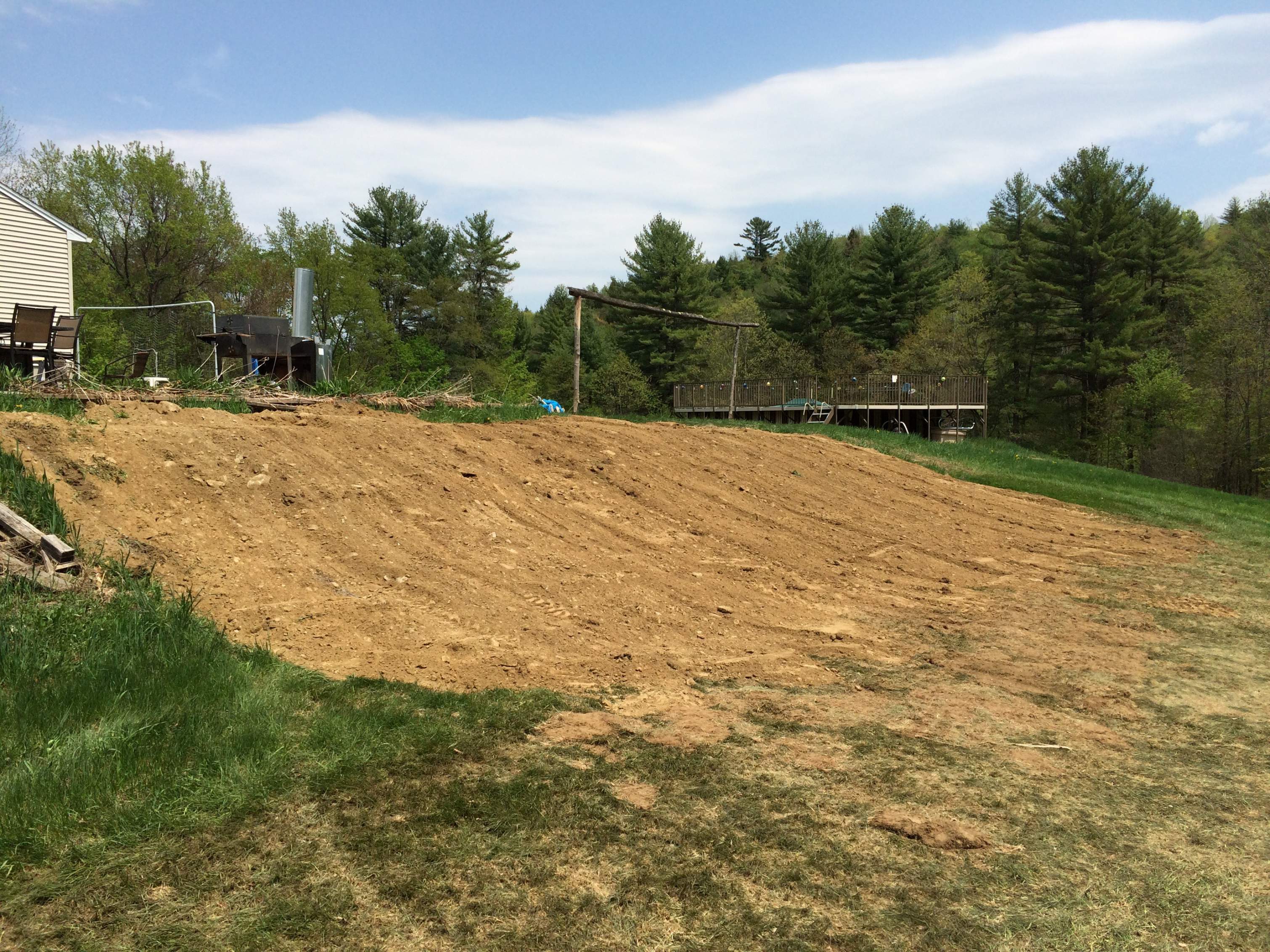

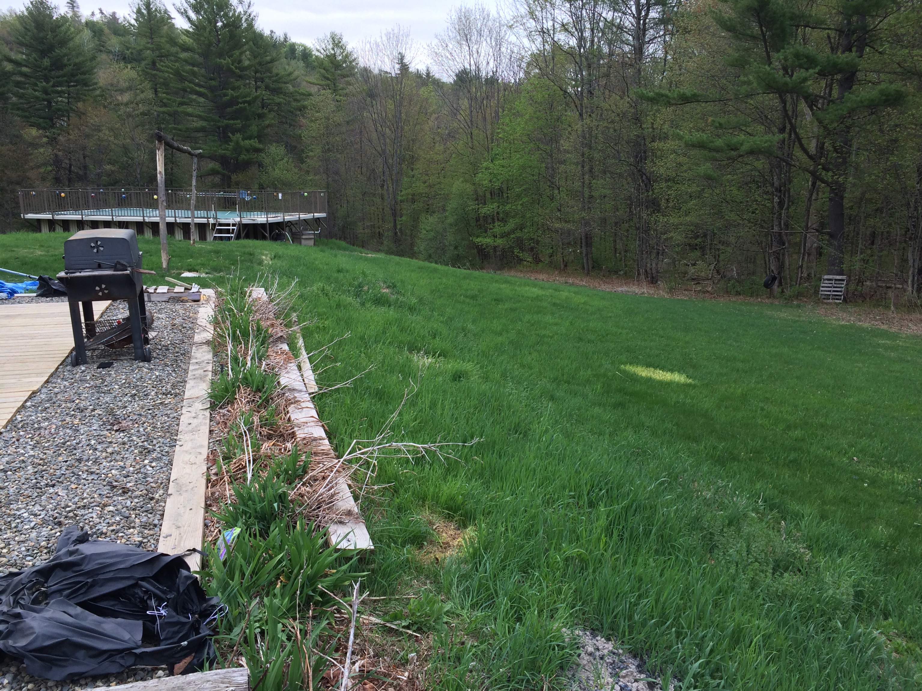

I volunteered to help some friends who had a hillside excavated last summer to put up a large Shelter Logic structure. The spoils from that were piled beside their driveway.
They wanted the spoils moved to another area of their yard to decrease the slope of a hillside to enable them to safely mow it.
They also had anther area that's been difficult to weed whack that they wanted some of the spoil moved to as well but didn't need to be mow-able.
Here's what I finished yesterday:

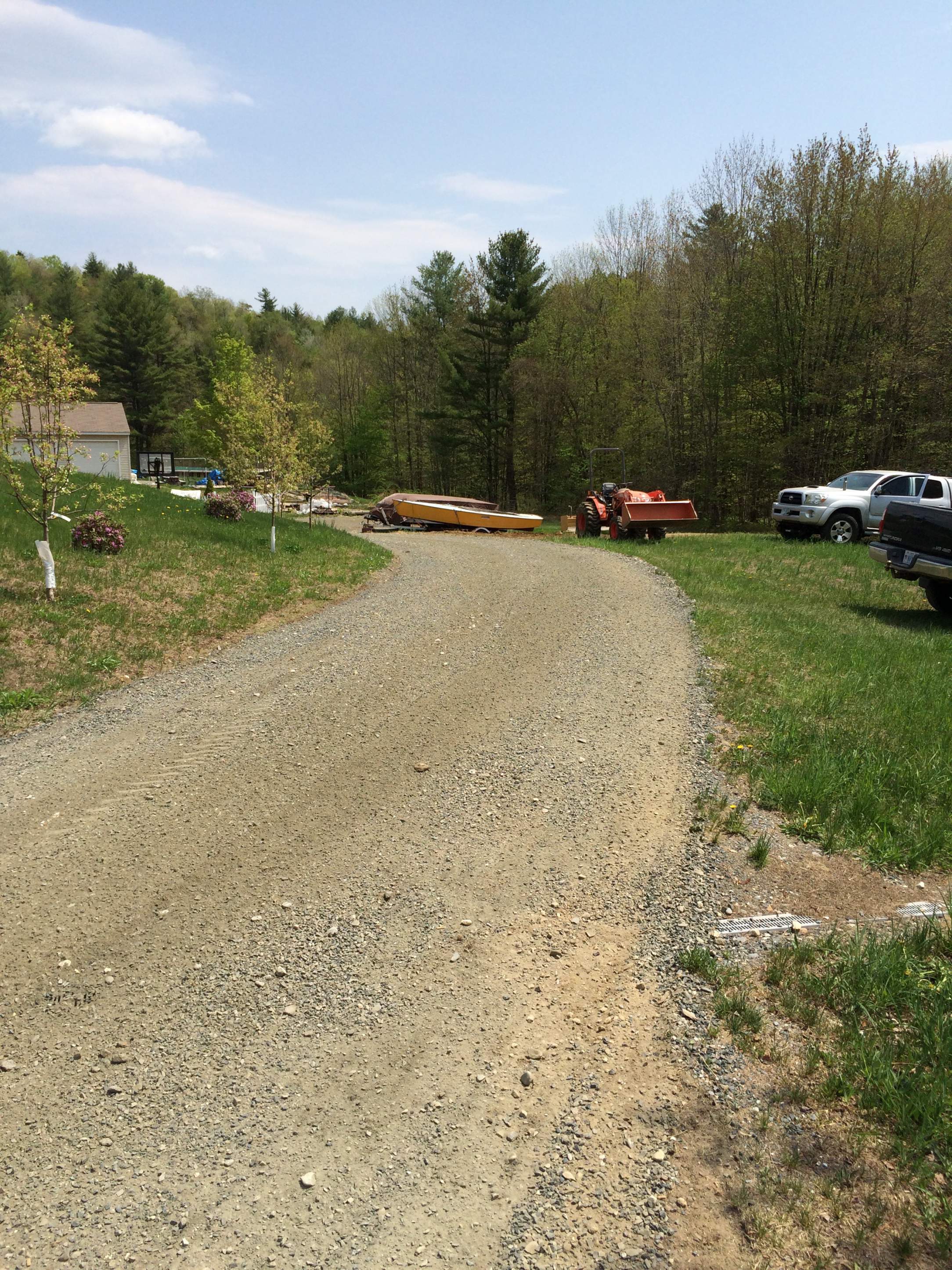

I wrapped it up today & gave their driveway a going-over for good measure! A fun weekend of "working" on my tractor! About 7 hours of seat time. I sure learned a lot!
