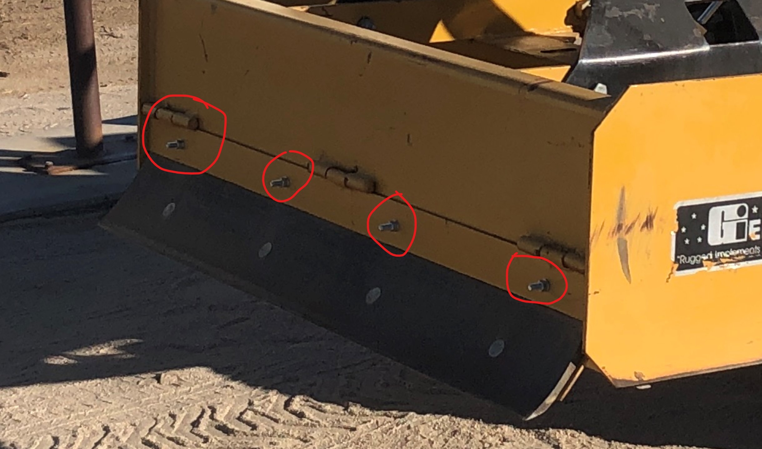

Still a bit of a noob on box blades... been reading through this and other similar threads but still have a question..
I got a super deal on a General-branded BoxBlade for my MT125. Thanks to learning curve it took a few hours to get the hang of it enough to level the area where I'm putting up a new shop.
Mine has a hinged rear-facing blade. I ended up running some bolts through it to make it fixed and that worked great, but I have to wonder what use that blade would be when it's swinging free?
   / Beginners guide to using a box blade #239
A rigid rear blade limits how deep the front blade can cut in a concave location like the bottom of a steep hill.
I can cut with mine coming down a hill, and after being on flat ground, but it won't cut in the transition, even with the top link fully short.
This would also apply at the start of a "trenching" cut.

ya, that I know.. that's why I bolted mine down to it wont swing.. what I'm wondering is what the advantage is when it swings? they made it that way for a reason.. why?
