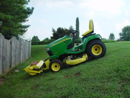

Here is a winter project that I have mostly completed. It is really the first major dirt digging I have done with my X585/loader and then 2210/loader. The hairyest part of this was the close proximately to the pool fence. The slope really ended at 1 foot from the fence and went from 20 degrees at one end to over 35 at the other. It was difficult to mow with the push mower so required using the weedwacker which I just love using sooo much /forums/images/graemlins/mad.gif Because of this love I would typacally ignore cutting this part and it would tend to get overgrown. The X585 could cut most of it in 4wd except the steepest 15'. Here is a picture of the slope with my 585/johnny bucket at the half way point with a slope of 27 degrees.

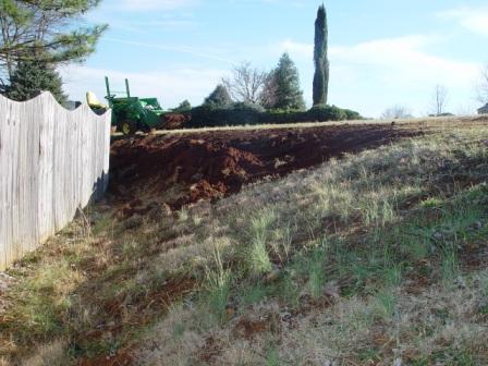

Here is the next picture showing the 585/loader taking the first pass

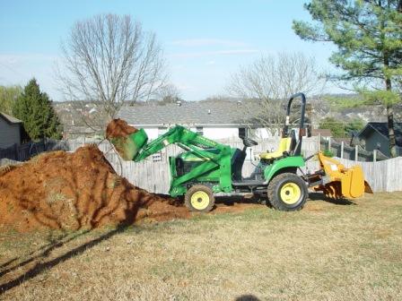

The next shot with some more dirt removed

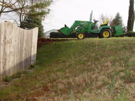

This picture is the 2210 getting dirty. I traded the 585/loader for the 2210/loader so you are looking a a very expensive 2210 /forums/images/graemlins/crazy.gif The difference in the 2210 loader ability and 585 loader ability was impressive. Taking a big chunk of earth out of this pile was no problem for the 2210 and I have yet to install the the toothbar that I kept from the 45 loader.

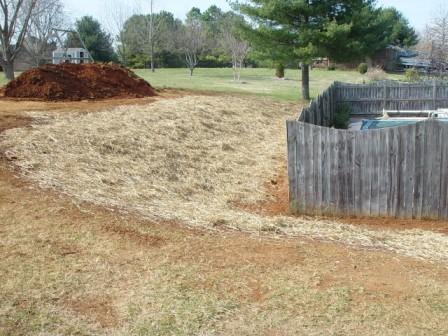

Well play time was over and it is time for seed and straw. Just hope it doesn't rain too hard otherwise I'll have lots of green at the fence. I can now drive the 2210 down by the fence without hitting the ROPS. I will still have to cut in the up/down but won't have to worry about driving into the pool.

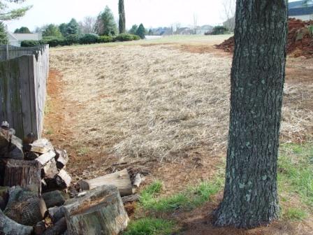

Final picture. Now all I have to do is get rid of the dirt /forums/images/graemlins/grin.gif
