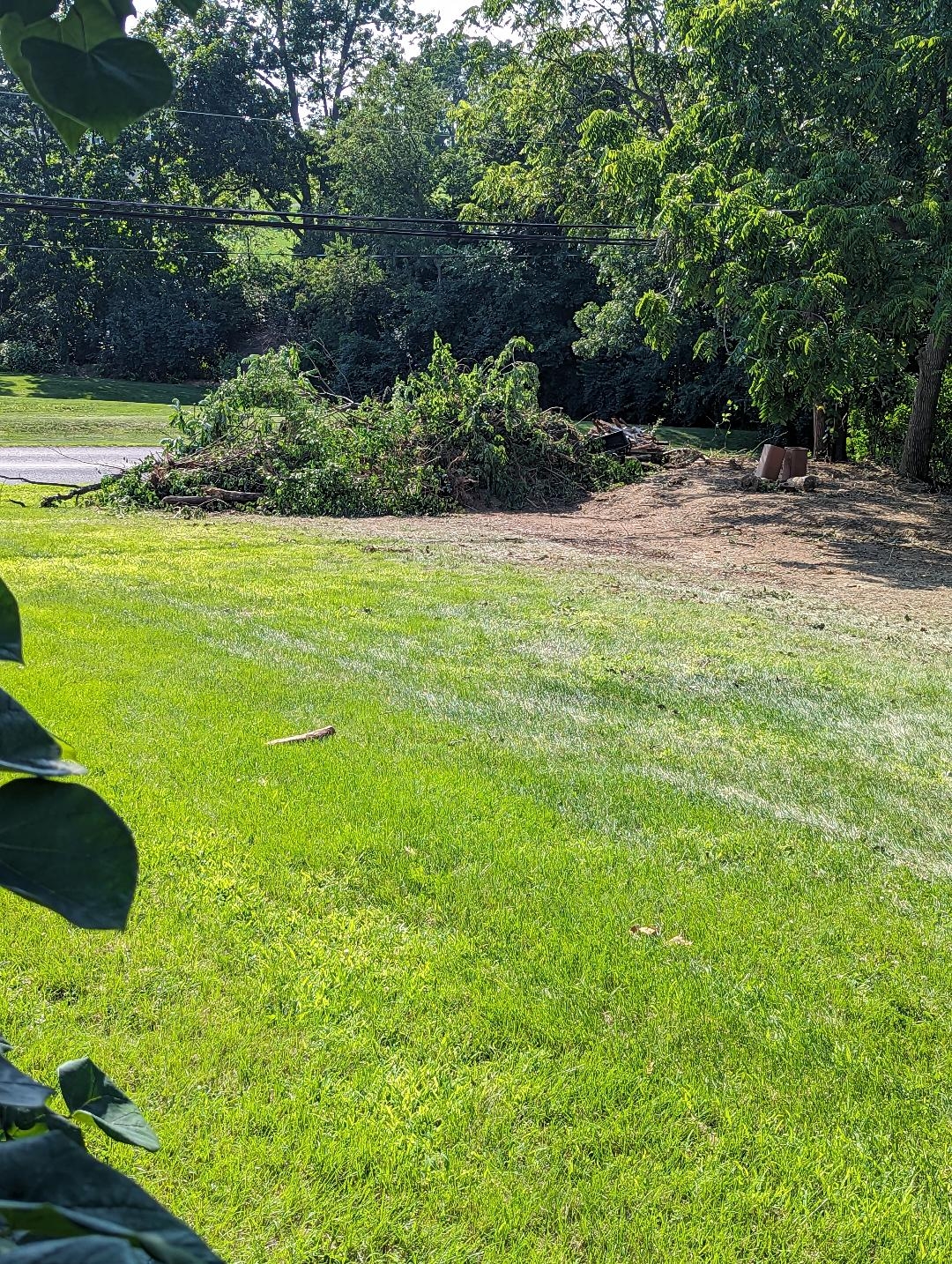

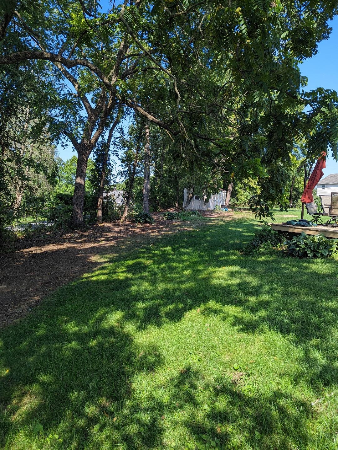

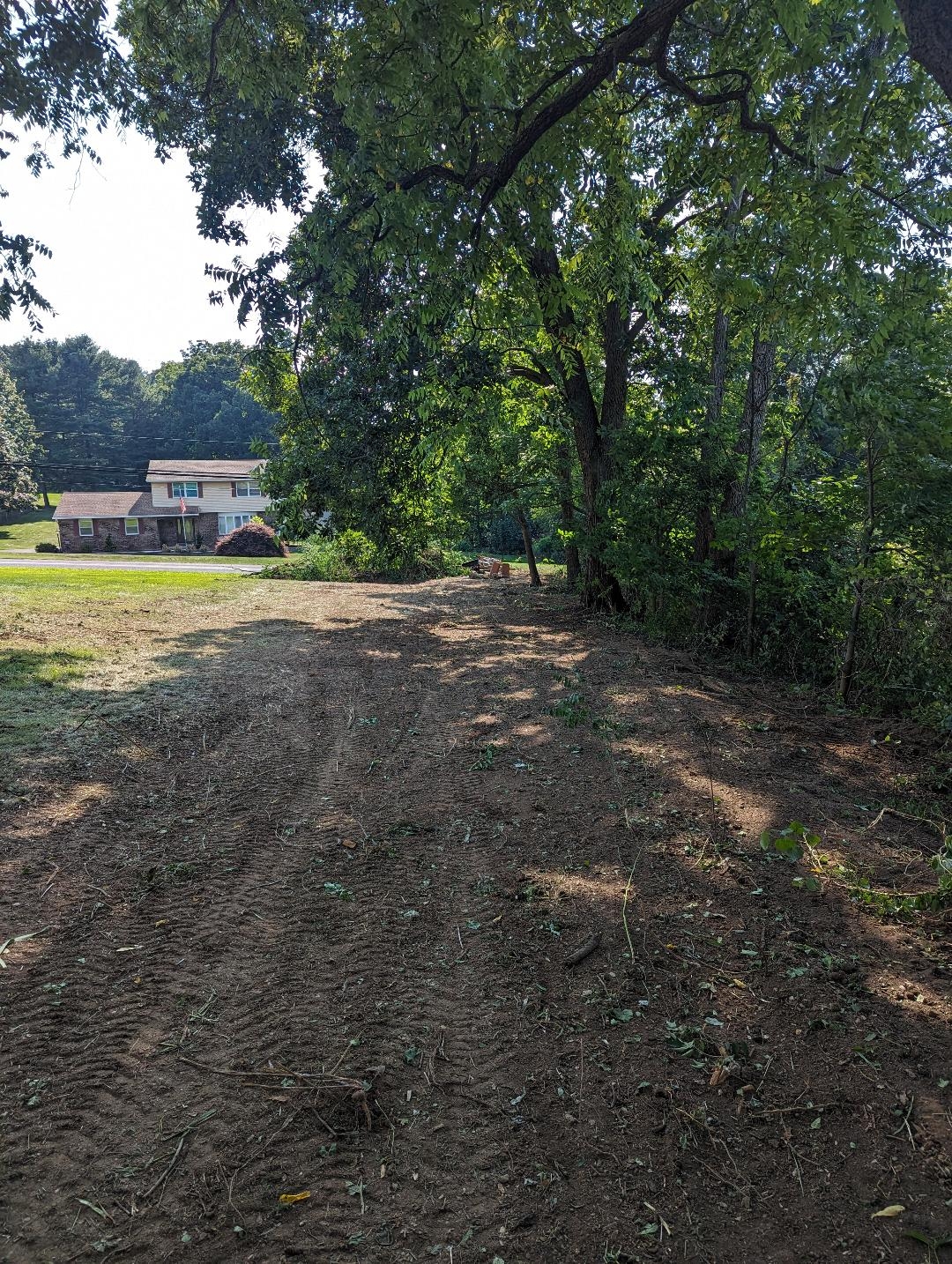

Otherwise I've been clearing out an area about 20' x 280' of underbrush, fallen trees, weeds and so on. It's smaller size is a definite plus for my use. Once I removed the loader and backhoe it makes an excellent mower of my property. It's only 1.3 acre but except of the house and driveway, it's all lawn.
