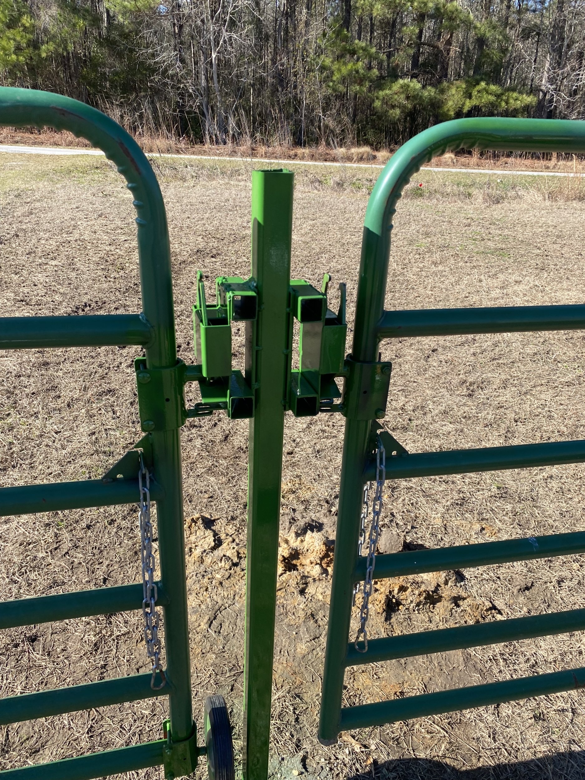

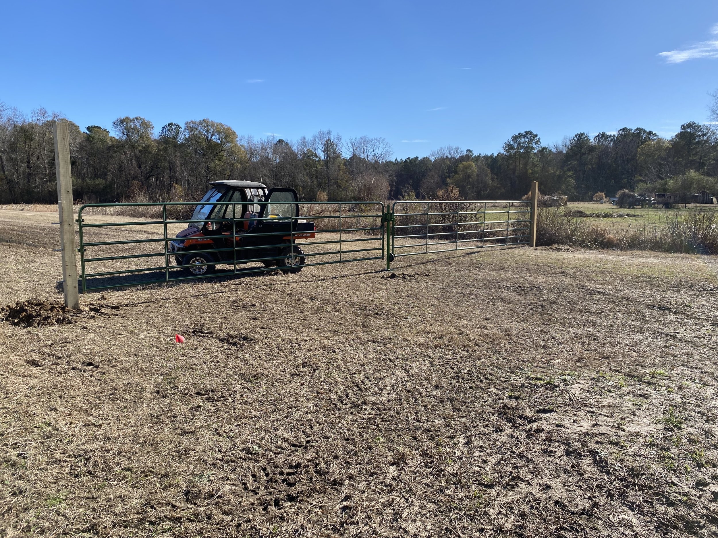

Just finished up my main gates and laid out the fence perimeter. I'll need 4 rolls of wire. Planning to get all the gates in first. I have 6 of them.

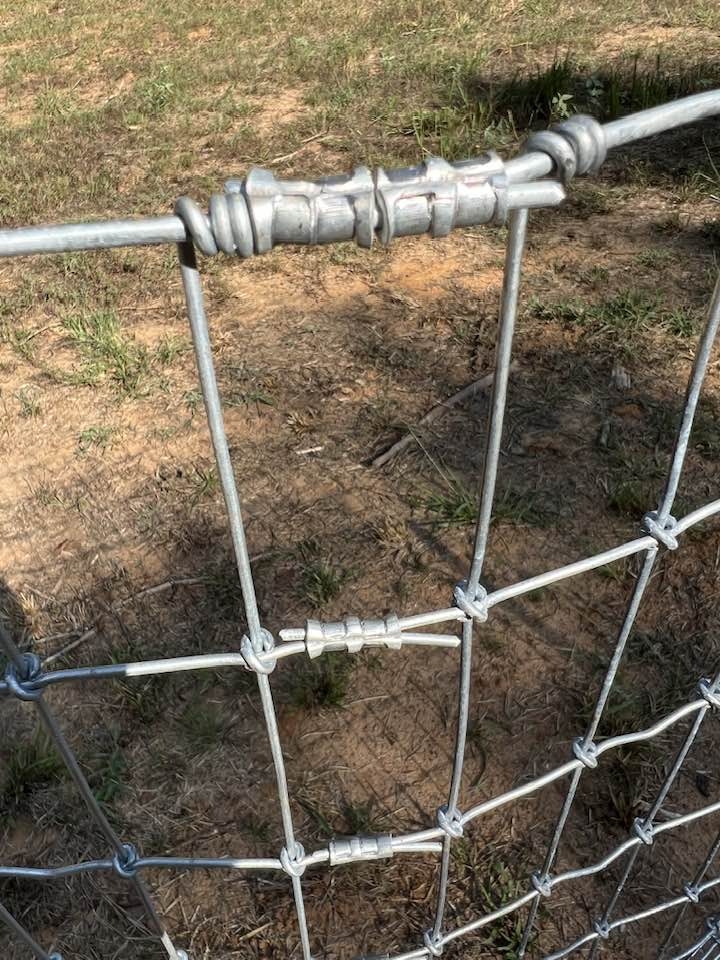

You also need to find a good crimper to connect each roll of fencing. To me, this is the thing I hate the most. My crimper does the job, but I hate using it. I put two sleeves on the top and bottom wire, and a single sleeve on the other wires.
What type of crimp and crimper do you use?
i just put the two vertical end wires together, then double back the horizontal wires to loop the two together and then wrap the horizontal wire back on itself for each horizontal wire. No crimp sleeves needed.

Anyone ever use the Baekert T-post clips? They have a special tool that goes in your cordless drill that does the twisting.
Only my main gate will be pipe panel. The others are just old school posts hinged with wire on one end and latched with wire on the other. Not sure what the official name is for it, but most ranches back home use them. Much cheaper than buying many gates.
