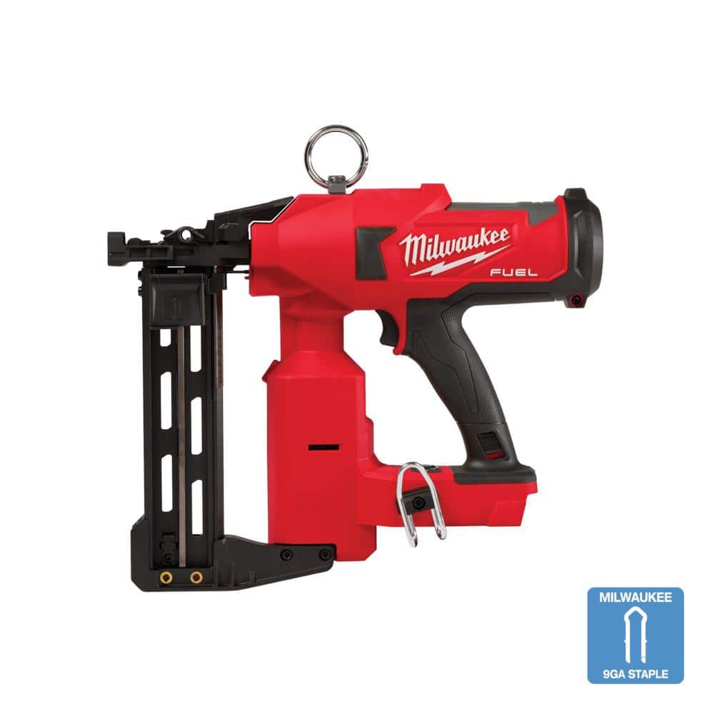

Might want something like this on your Christmas list....
I thought about it, but the price tag scared me off. The other issue was that the staples on some of them are not barbed, or if they are, they are thinner staples then what I'm using, and they only had one barb. I'm sure there is one out there that does the bigger staples with double barbs, but I haven't put much effort into looking for it because of the cost of buying one.
I base everything on $300 for a roll of fence, or buy something else. Do I need it more then another roll of fencing?

I only rarely crimp barbed wire because of the hassle, but I have used a cheap hydraulic crimper, with one anvil flipped to be flat to crimp that style of crimp, but I have no idea if it would hold high tensile wire.
I don't do enough wood post wire fencing to make it worthwhile for me, but the Milwaukee M18 staples are double barbed.

I saw those, but I think they are just barbed, not double. Double barbed have 4 barbs 2 on each tine. Works for me, but not Eddie. Milwaukee tool is cheaper. Under 200 with tax if you already have their battery system. Alas, I do not.
