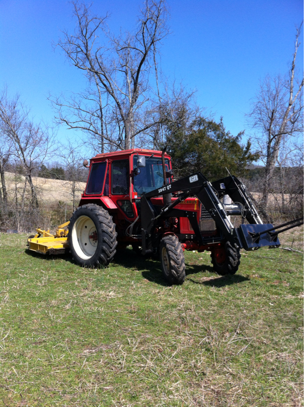

I've got a 1994 825. It's old, ugly, and I wear ear plugs even with the cab. Something is always wrong with it, but no major issues.
It's heavy, cheap horsepower. It sips fuel, and has generally been cheap to work on. Just finished mowing thick fescue, briars, and persimmon sprouts in rough steep ground. It burned less than 2 gallons per hour. The down pressure on the 3PH is awesome for drilling post holes.
I'd scrap that sucker in a heartbeat and get a new Deere, Kubota, or New Holland if I could, but poor folks have poor ways and it gets the job done.

Hey it looks pretty good still!! I've seen some on lots and I scratch my head as the hr. meter says 1500 but they look like they've got 15,000 on!! Doors ripped off seat wrecked dents and so forth. I guess its like auto's some people can have them with 100K miles and they look new and some can have them with 50K and they are trash.
I like to wear these in the old Belarus if I'm in it for a long time, and other noiser equipment around the farm. Then I can listen to the radio :thumbsup:
Yeah the down pressure on the 3pt is handy. When I 1st got my Valtra and was going to use the 3 pt. hitch I fooled around a while thinking something is wrong with this thing then remembered it doesn't have down pressure on the 3pt. :duh:.
