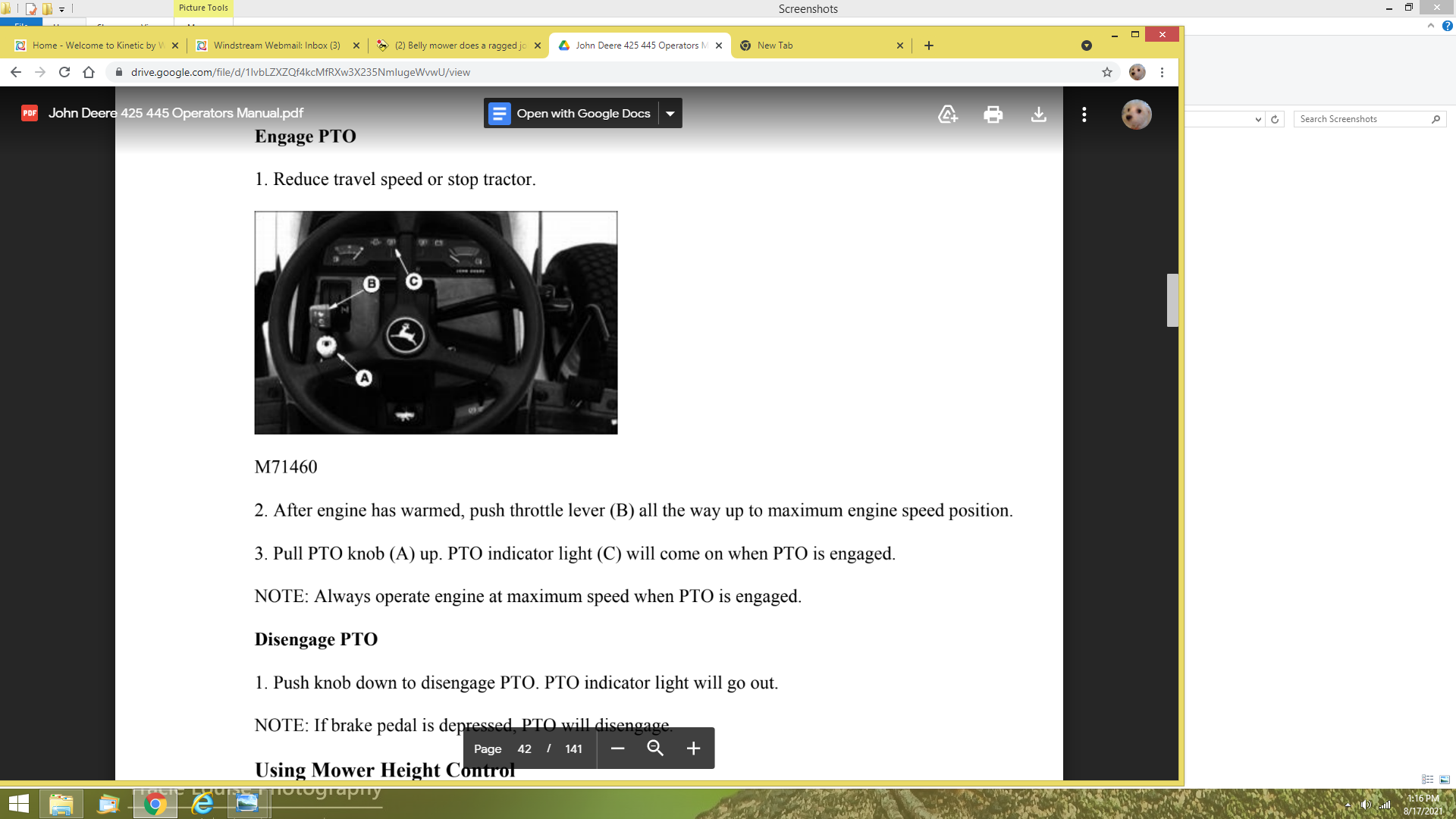

Several of us are reading directions written by people with poor English skills and not involved in the logic of what they are saying. It is 100% obvious that you can minimize the wear/tear/jerk by engaging the mower at a low rpm before revving it up. Duh ! The manual saying to "engage" at full throttle needs to be rewritten to say "operate at full throttle" not "engage at full thorttle."
This screen shot of a jd 425/445 manual is pretty clear. Start pto with wot.
   / Belly mower does a ragged job - why? #62
That's very interesting. I would think the PTO engagement system on a 4xx machine would be similar to my 2320. My manual specifically says to keep engine speed below 1500 rpm and engage the PTO, then bring up to operating speed.

I had a few 425/445's. They are gas engines. If they were not warmed up long enough and WOT, the engine would die when a 54" deck was started. After mowing for 5 + minutes the deck could be started at a slightly faster than idle speed.
The same series 455 was a diesel and it would start the deck at a cold idle.

Mike... at what RPM is the tach marked for the PTO?
The picture back a frw posts indicate 2800 is the recommended setting, not 2600.
