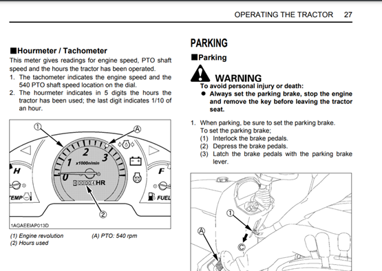

Mike... at what RPM is the tach marked for the PTO?
The picture back a frw posts indicate 2800 is the recommended setting, not 2600.
Tach on my B2601 isn't marked for optimum PTO speeds. Red line is about 2,800.
Manual says rear PTO turns 540 RPM when engine is doing 2,768 RPM.
Mid PTO turns 2,500 RPM when engine turns 2,753 RPM.
That tells me the sweet spot is 2,750 to 2,770 RPM.
Translation - For best results, pour on the coal and let 'er rip!
Best Regards,
Mike/Florida

Every Kubota tach that I've ever seen has a mark showing PTO RPM speed. Yours doesn't look like this?
   / Belly mower does a ragged job - why?
#79
Glad it's working better.
10-4 on "pour on the coal"!
Yes, it has a little red square at 2,800 rpm.
On every other vehicle of the many, many vehicles I have ever owned equipped with a tachometer, the red line/red mark is the top allowable RPM for the engine. I'm talking cars, motorcycles, airplanes, boats, exceed red line and you'll blow it up.
I went and looked through the Kubota manual and I didn't SEE a red line! (I may have missed it, or it may not be possible to get there under load.)
In any event, 2,800 rpm seems to be the design target speed for the engine. Henceforth, that's where the needle will be and I'll wear my ear protectors (I do anyway).

Understood. But it's not like a car or motorcycle. You can't red-line or over-rev the engine by running it at WOT. Like a motorboat, chainsaw, lawn mower, snowblower, etc., it's designed to run at WOT.
Thanks for the follow-up info. Happy mowing!
