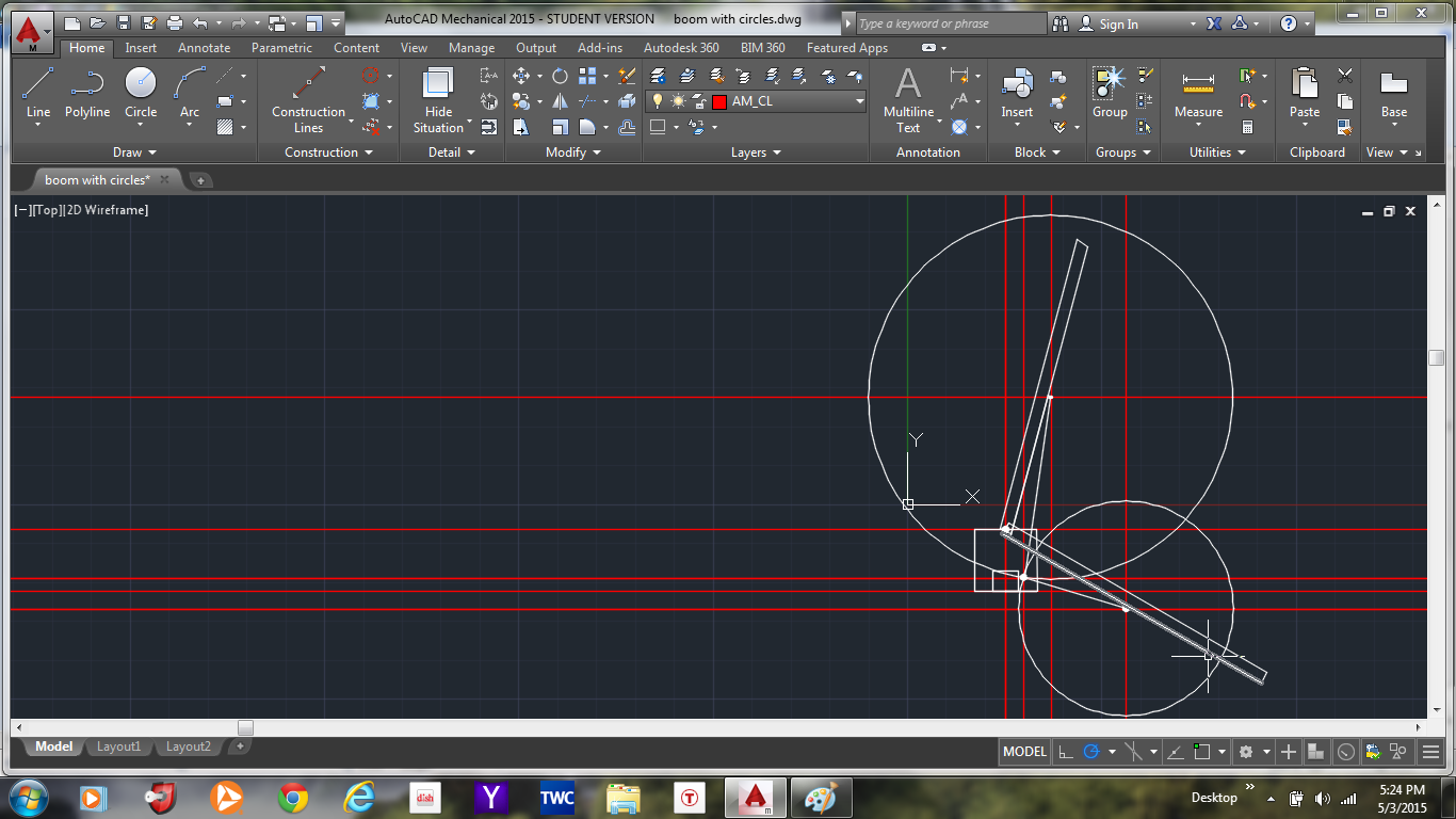

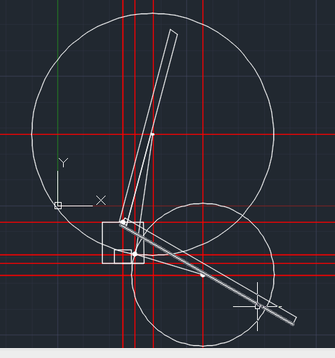

another try at autocad drawing up the boom/cyl mounting points. Did I mention I hate autocad?? boom with circles.png
   / bending 4x4x.250 sqtube #26
Kinda hard to see the drawing, so I cropped it.

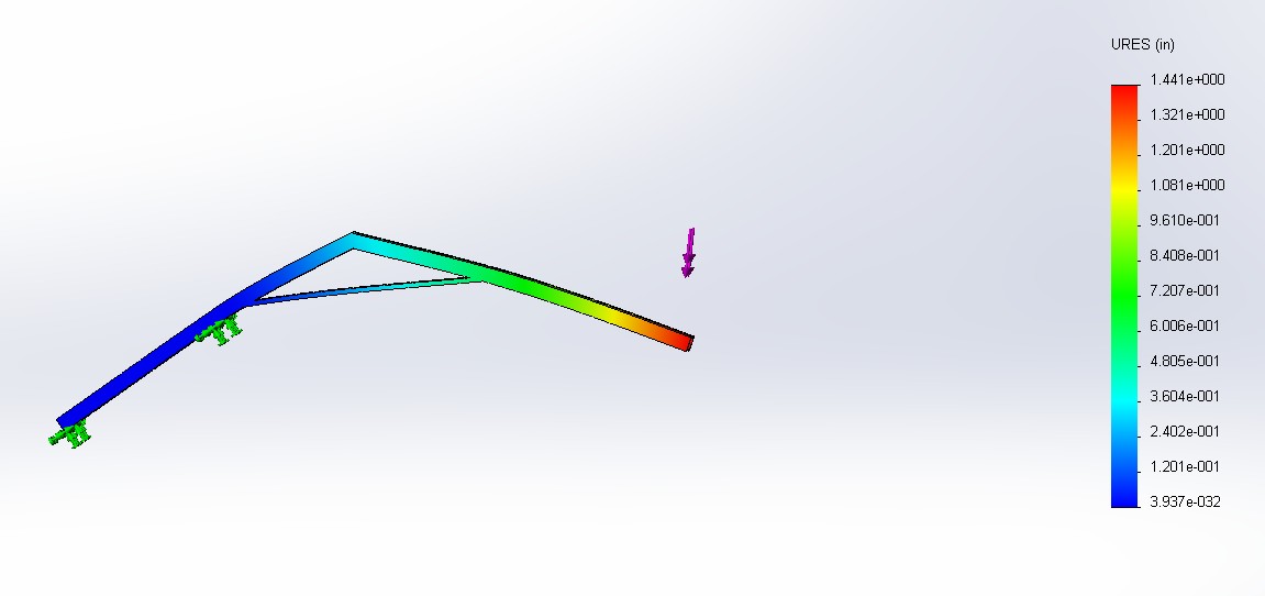

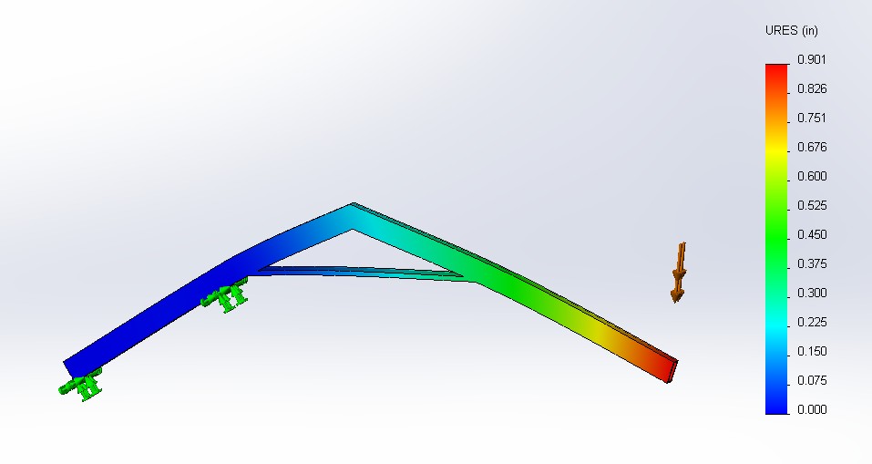

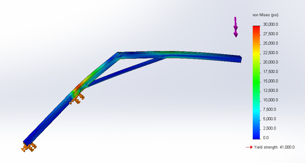

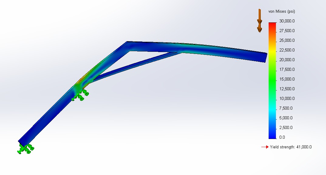

Quick and dirty analysis for you......
Ends near the base are fixed in place, the whole arm is 16 foot long. Loaded with 1000 pounds at the end.
Design 1 uses 4x4 x .25" wall.
Design 2 uses 2x6 x .25" wall
Look at the maximum deflection, and maximum stress areas near where the lower cylinder would attach. You can see that the 2x6 is better when loaded in this manner. If you add support arm above the beam like suggested, the capacity will be increased.
If I had a better dimensioned sketch and size pistons you are planning I could get you better numbers is to whether it'll work. Forget that autocad stuff, I found it more confusing than helpful.

JB, what it that program you are using? Also only engineers know that 1.44e+000 = 1.44 inches. I think Mudd is using 2,000 lbs as his limit. Also I think Sq tube has yield str 74,000 psi

I'm using solidworks.....and I meant to change that unit display to "floating" so as to not confuse the masses, my apologies lol.
The yield strength is going to depend on the material, not the shape. 50,000-75,000 psi is probably a good guess for most tubing without knowing the exact material.
Another note: just the tubing is 205 pounds. Add in mounts for cylinders, the cylinders themselves, pins, some kind of grapple at the end, and you're talking some serious weight. You want that tubing to be as efficient as possible to make this manageable.
