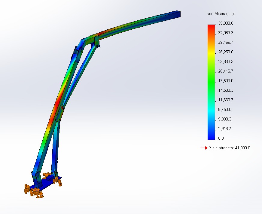

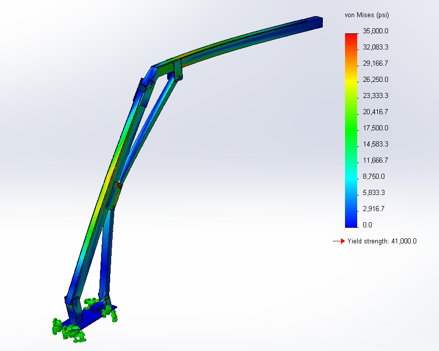

That being said, as far as the arms go, I would weld a 1/4" strip down the top center of each arm. You can see from the analysis that I did how much of a difference that strip makes. This is with 2000 pounds at the end of the arm, which was about right for a 3.5" cylinder at 2000 psi.

Hey mudd I got your number,,,,,When you've already scrounged 1/2" plate, its beautiful. But when you don't know if you'll come across 1/4x4" truss material that's "ugly".
:laughing: :laughing: Hey you can't fool another scrounger. :laughing: :laughing:
FYI the truss method with 1/8" plate would be even stronger (substantially) than the piggyback method that JB ran thru his program. But more work to model it.

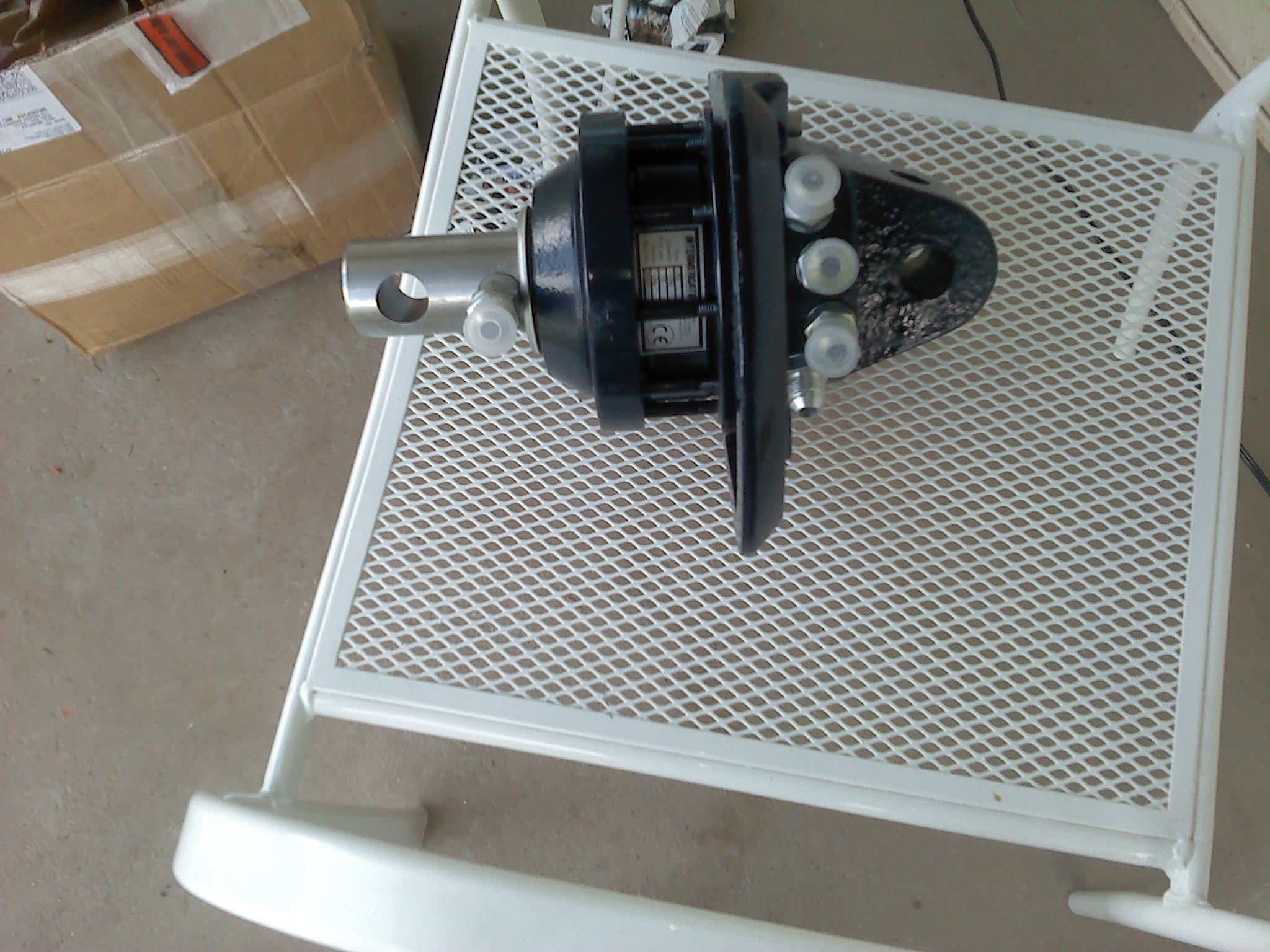

got the Valby rotator yesterday.0508151720.jpg Its a R3 rated for 6600lbs and weighs 41lbs.
