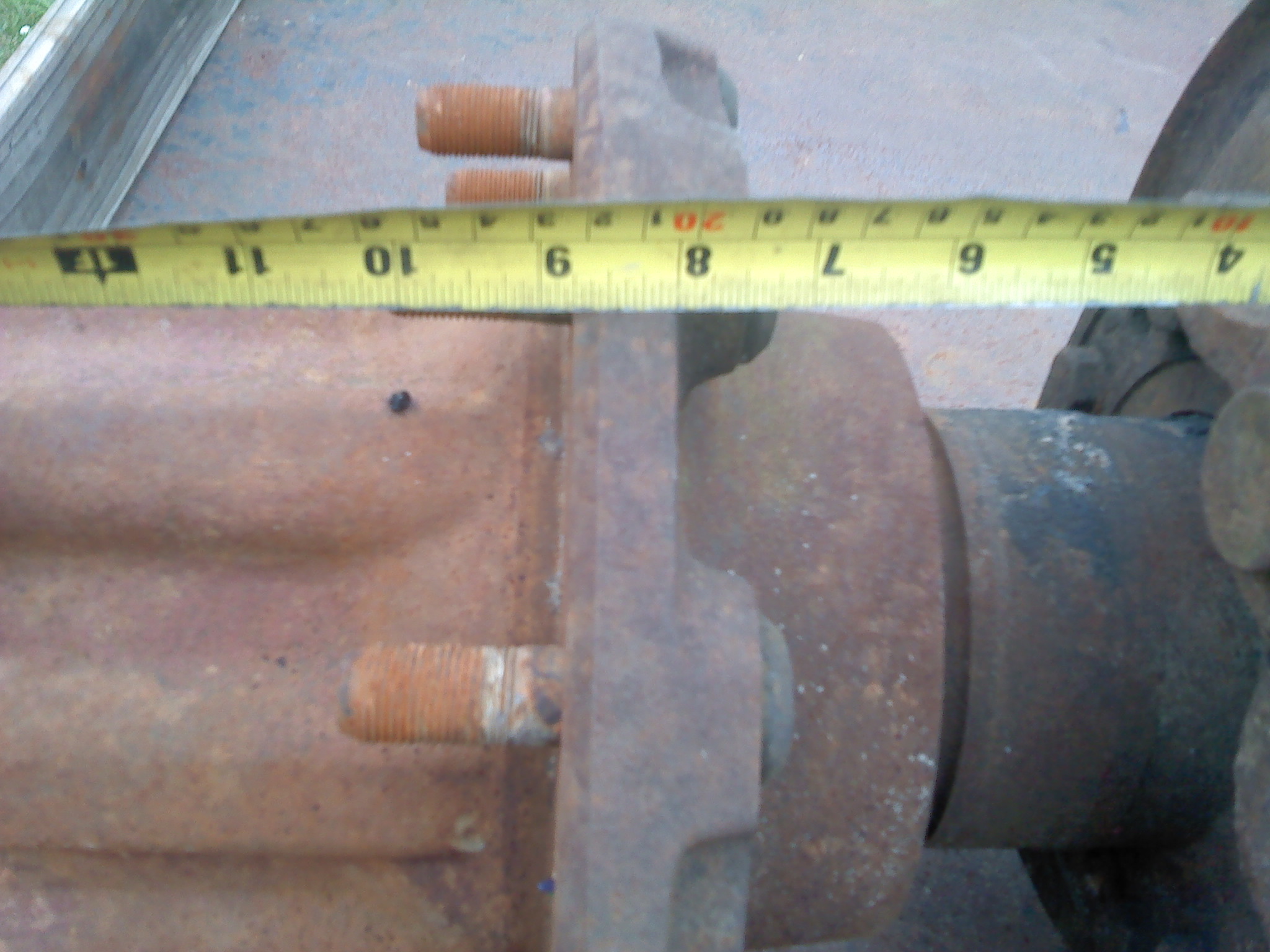

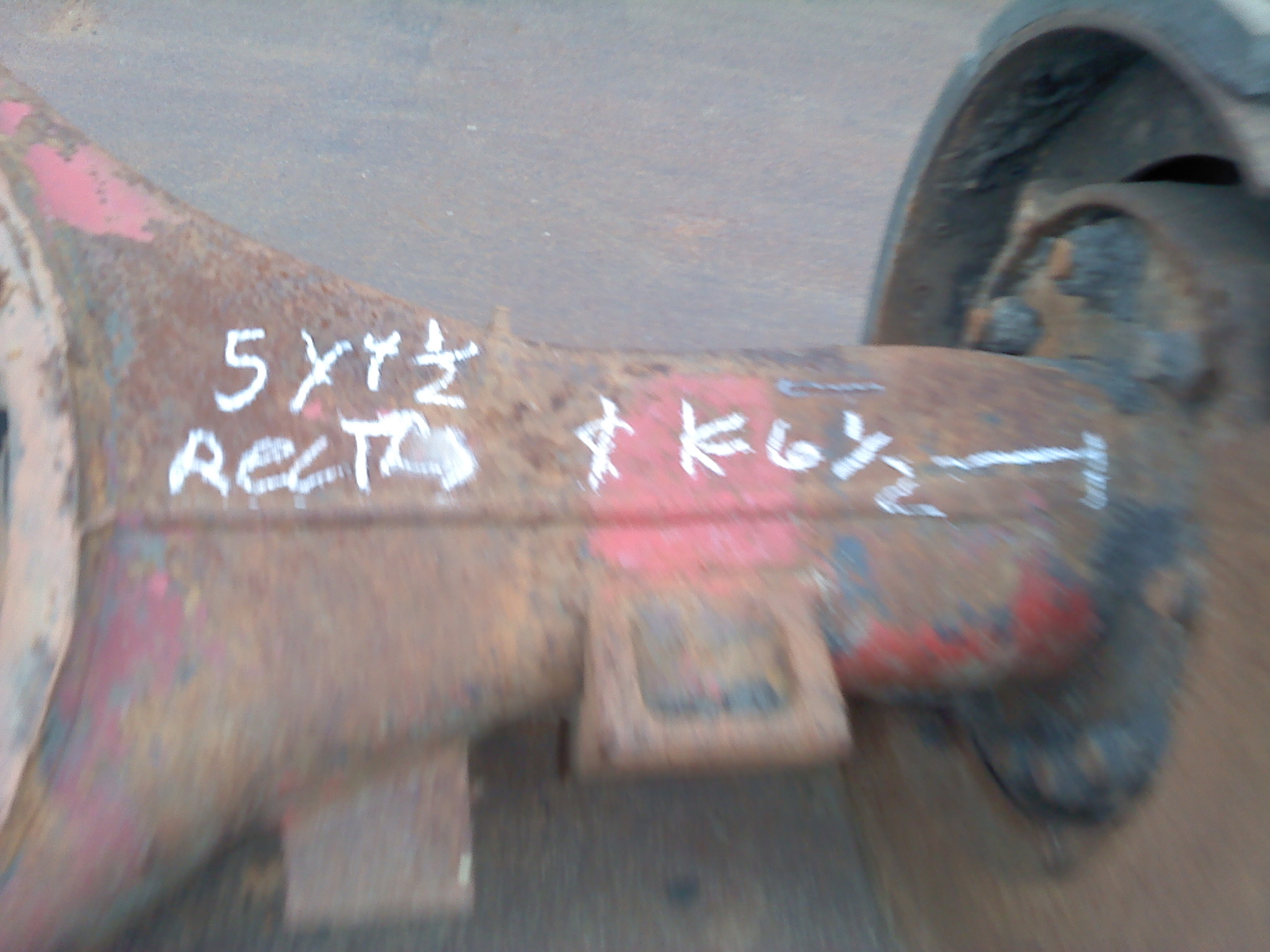

I decided to go ahead and get the measurements. Got grease on my shirt, now catching heck from the wife. Oh well. First pic is the spindle. Its 3 1/4in dia at outer bearing and 3 3/4in dia at inner bearing. 4 1/4in between inside edge of bearing and 7in to outside edge of bearing, 13in from end of spindle to where it is welded to the axle tube 0514151924.jpg
Next pic , weld for spindle is 6in to the center of the spring housing and axle tube is 5x4 1/2inches OD.0514151924a.jpg Last pic is 9inches from the base of the hub to the weld of the spindle to the tube. 0514151925.jpg
My current plans are to cut the tube to fit inside a 6x8x1/2 tube to get the height I need for the loader and to provide something to weld to when fastening to the outriggers and trailer. I am also considering using some 12in diaX1/2in piling pipe and adding gussets to keep it upright, and just putting the axle tube in it instead of the 6x8 tube. Either material I choose to use I will be making a plate cut to fit the outside of the axle tube and the inside of the pipe or tube to support it top and bottom.
Well phooey, pics aint in proper position, but measurements are written on each pic

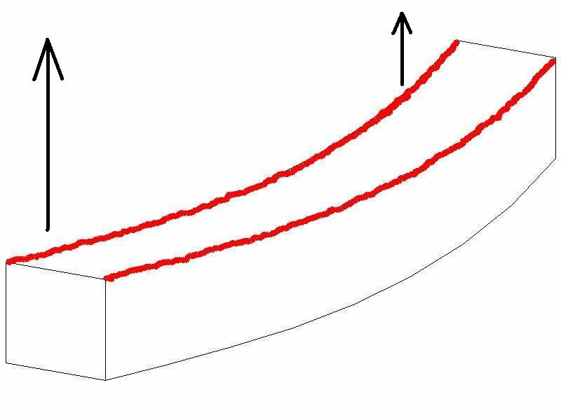

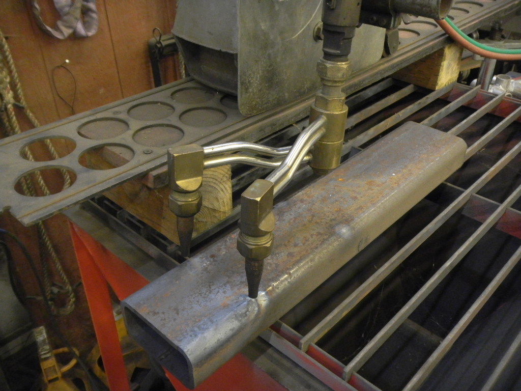

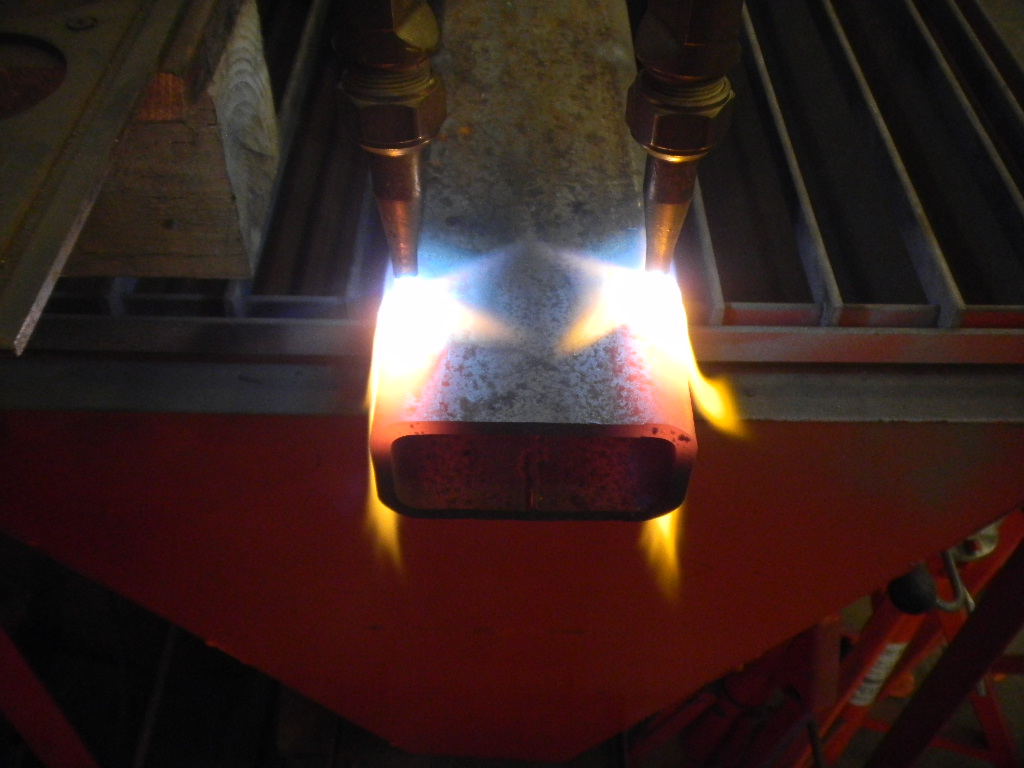

muddstopper I'm wondering (thinking out loud here). If it would help to heat shrink the two top heels of the box tube before you add the mounts for the hydraulic cylinders? Just enough to put a long arch in the tube?

SA,I dont know if that will help. what is the goal , or what would i hope to achieve by bowing the tube. I suspect you are meaning bowing it upward, but how is that going to improve bending capacity? I am thinking that by the time I add the mounts for the cylinders, that the boom will be plenty strong enough for what I plan on lifting. the 2000lbs I am wanting to build for is a worse case senerio. I suspect actual load weight to be half or less, than 1 ton. If I do run into a 1 ton log, its pretty slim chance I would be picking it up at full extensions

My thought process is, when you heat steel the molecules in the steel expand, but when it cools, or you use water to cool it the molecules contract tighter, so the steel bows. In my mind I think it would take more force to bow / bend steel that the molecules are tighter. Also the bow in the opposite direction has to help some.:confused3:
   / bending 4x4x.250 sqtube #76
Not sure if it would help in the situation, as I have never really thought about it.
Usually you see pre-stressed or arched things where there is a solid attachment point at both ends. Like a bridge. Where in order to deflect downward, the bridge would actually have to grow in length. With solid footings, it cant, thus helping limit deflection.
Without solid anchor points at two ends, I dont see it helping. Regardless of arch, once the stresses go above what the steel is rated for, you will have a permanent bend.
