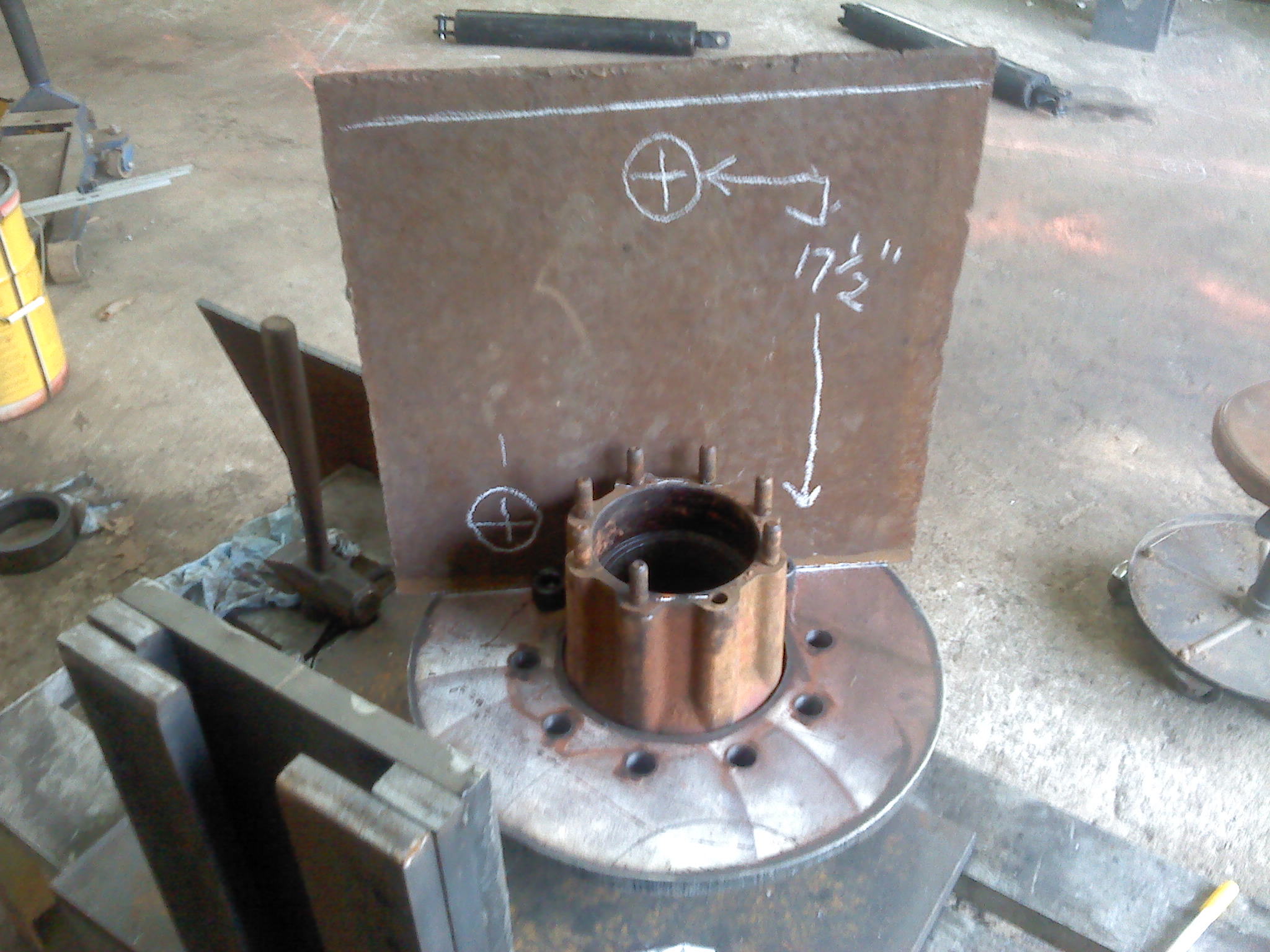

I thought about the 4x6, but what I am running into is not having enough base metal to make the base mount. Right now as I have it drawn out, the boom mount is in the center on above my hub. The base pin for the cylinder is just inside the outer edge of the 20in wide base. I can slide the side mounts forward and mount the boom off center of the hub, probably wouldnt have to move it more than about a inch, but the more I move it off center, the more side load I place on the hub. Ideally, the boom would be mounted back of center and the cyl mounted forward of center to even out the load, I think?? I could always look for more metal to make the base out of, but used flat plate around here is hard to come by and expensive to buy new. Just going from 4x4 to 5x5 moved my top boom mount up almost 2 inches. I would have thought only 1/2in, the difference between the center of tube to outer edge, but it didnt work out that way. I havent said this yet, but the hub extends 6 inches up and is 8.5 inches wide in between the upright side mounts. Just doesnt give me a lot to play with. I'll take a pic of the setup to show what I mean.
Dont know if you can tell what the first pic is, its where I drew everything out on the garage floor. Piss on Autocad.

I do not think your hub will be adequate. A wheel on a truck is almost perfectly in line with the bearing assembly. Your design places significant bending load on whatever axle fits in that hub unless you support it on both sides. If you look at a backhoe or anything similar, the pins are set apart vertically a decent distance, so you don't get the bending load. The pins in a backhoe are loaded in shear.
Bringing the pin off center won't really change the moment (bending load) on the hub. Moving it an inch off center will be negligible if you were to do a bending load calculation. This is the type of basic engineering that I feel may be lacking when building this from scratch, and hence why I have concern for your safety.

I dont know if I am following what your saying. Are you saying the hub off a 48,000lb truck axle, (24,000lbs using just one hub) which has a factory safety factor of about 5x (120,000 lbs) isnt going to support my boom with a 2000lb load at the end of the 16ft boom? There wont be any axle in the hub,http://www.tractorbynet.com/forums/...183419-bending-4x4x-250-sqtube-0509151048-jpg, this is the hub I am using, I will be using the actual axle spindle to mount the hub on. The flat plate laid up on the hub in the pic has a couple of circles with center marks in white chalk. Those chalk marks are where the boom (at the top center), and the cylinder (bottom left side and very close to the hub). The boom pin is 17.5 inches higher and in the center of the hub, and the cylinder pin is 6 inches forward of the center of the hub. With the amount of metal and cylinders I have available, this is about as good as it gets and the only way I can get the 105degrees of swing of the boom. Now I understand the pin locations on a backhoe boom,(I assume you are taking about the root boom and swing pins) and how far apart they are. A 48000lb hub has bearing about 8inches apart front to back. The hub spindle is a lot bigger than any backhoe pin I have seen even tho the spindle is hollow. I am not real sure of the distance apart of backhoe pins, but I will check a few out tomorrow. Backhoes booms are rated for much more than 2000lb and the booms are generally 14ft or longer fully extended.
Just to add, the hub itself is 8.5in in dia. I dont have a measurement on the spindle dia, but did try to put a piece of 2.5in dia shaft thru it. Shaft was to big to fit, but it didnt like much, maybe an 1/8. Didnt try to measure the outside dia, but can when I get back home Friday.

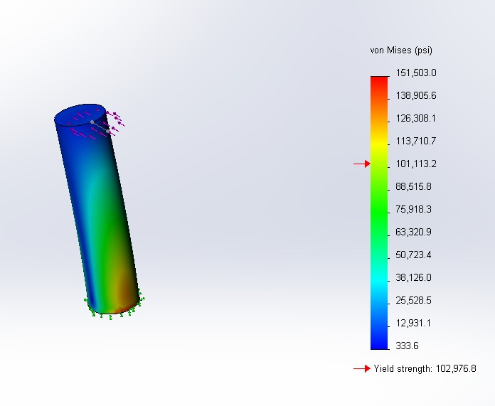

Distance of bearings is of partial importance, but you are not supporting the hub above and below the bearings. This means you are relying completely on that spindle in bending. This isn't how the hub was intended to be used, and you can't guarantee (or even predict via a calculation) that it won't break at the base. The other issue is that the axle stub is probably a harder steel, so it's more prone to a brittle failure vs a bending failure. I.E. a crack that one day completely lets loose unpredictably.
   / bending 4x4x.250 sqtube #60
For reference, if your spindle is only restrained on one side, a 3" solid steel center hub would not be sufficient.
2000 lbs * 16 ft = 32000 ft-lbs. Here is an analysis of 32000 lbs applied to the end of a 3" solid steel bar.
