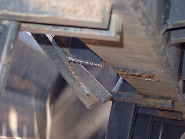

I bought a new heavy duty Gearmore 6' box scraper for my New Holland TC40 and was scarifying an open area on some foothill property that I own and snagged a root, the implement bounced but it did bend one of the teeth carriers up and back. The ripper tooth itself was unscathed. Upon further examination of the BS undercarriage I saw that the welding of the bottom of all of the tooth carriers were at best spotty to none compared to the top of the carriers that had perfect textbook welds. The tooth carrier that bent had two very shallow welds and most of them were cold because there was rust in the weld between the carrier and the square box tube (see photo BS2). The BS was over a year out of warranty, I claimed that it was a quality control issue and Gearmore paid the bill for my local NH dealer to drive out to my home (25 miles one way) and pick up the BS, take it back to the shop, weld ALL of the carrier bottoms and return it to me within two days. They brought it back attached to a shop tractor, lifted it on the trailer for my inspection which I found totally satisfactory. I commend Gearmore for their quick and proper response, I commend my local NH dealer for their teammanship in this matter and I hope that gearmore has fixed their in house quality control. I would still buy their products.
Lesson:
Look underneath before I buy.

I've had a lot of things let loose because they were poorly welded. I can't say much, I can't weld worth a darn myself...
Lastest was the landscape rake. Was smoothing out the inside of my new shed, clay dirt with heavy tracks in it, probably a little frost in the ground. Caught a lip of dirt going backwards, and the weld let go. It was a bit pooer weld than the pic in this thread of a box blade.

What does cold weld refer to???
Two instances come to mind. I was doing my neighbor a favor and mowing his back one acre with my Bush Hog 480 Squealer and I ran over a weed hidden crowbar that one of his kids had been playing with and forgot to return to the garage. No real damage to the mower but I would not want to have been in that line of fire when it launched.
Lesson:
   / Bending and Breaking Attachments.?? #29
A weld with very little, or no penetration. Basically the weld puddle is just sitting on the base metal.
