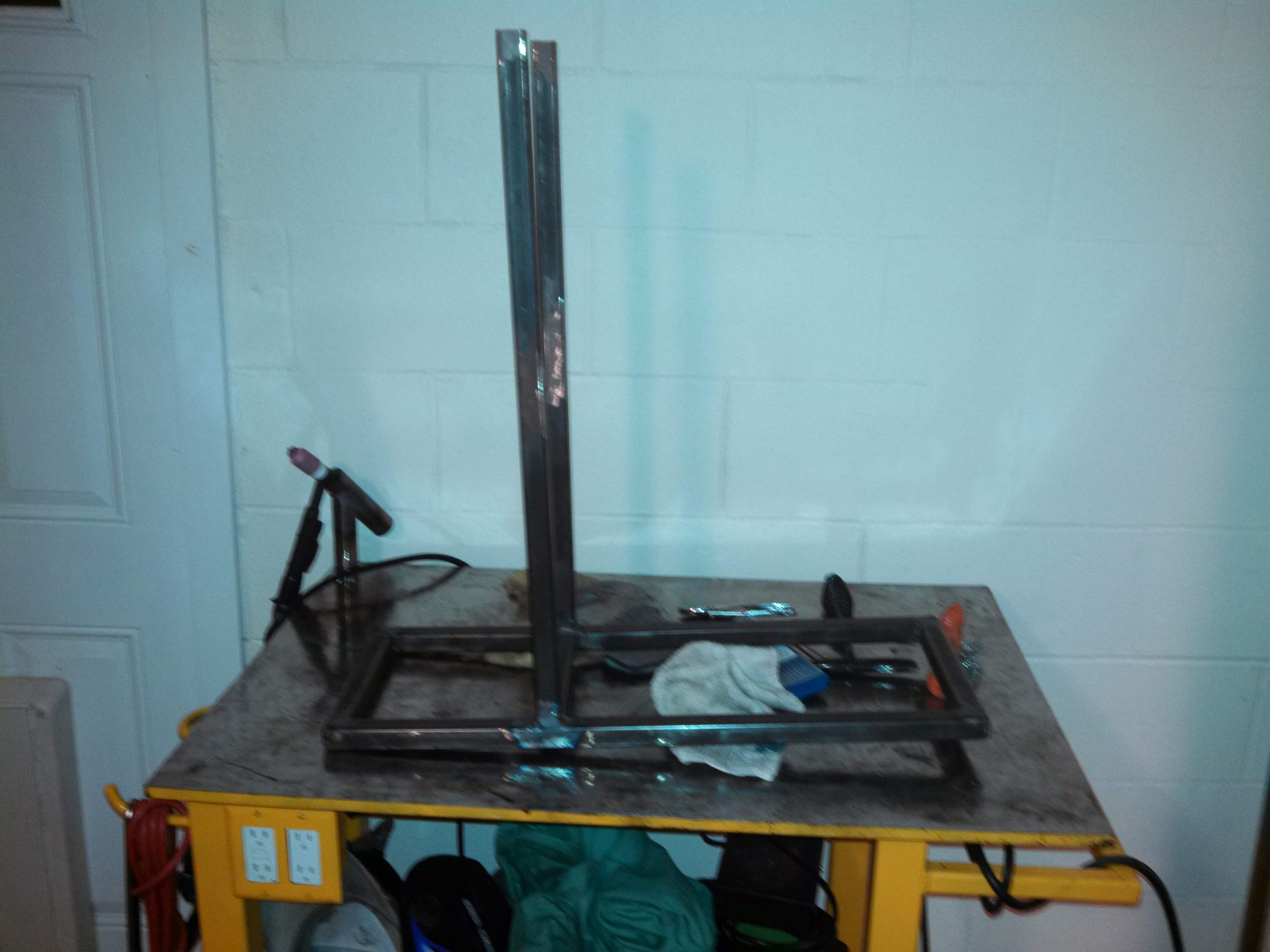

I welded some 1" x 1/8" thick tube into a T today. The "top" of the T warped slightly, of course. I know one way to bend it back is to weld a bead on the back side of the joint; I believe the bead should be perpendicular to the length of the tube, is that right?
I was also wondering if I could bend it back just by heating the back side with my TIG torch, but not to such a heat that the metal actually melted. Some web searching indicates that I'm not the first to suggest this, but I'd love to hear if others think it would work. That would save me having to grind off the weld after the fact--and, of course, give me more opportunity to use my awesome TIG setup!

Here's a photo of the piece, if you're curious.

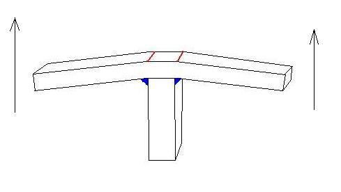

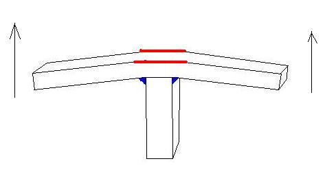

I would think heat is heat. Never used a Tig torch before. Always used O&A torch. Since switching to propane I've leaned I don't like propane for heat shrinking material as much as acetylene. Here are some different examples of how I would heat shrink a T-joint. If you can heat these areas red hot, and use a spray bottle of water to cool the heated zone. The material must be cool to the touch before re-heating. Remember if you can feel heat with your hand, the material is still moving!;)

Josh: you need to heat a small area quickly without heating the surounding area. That will make the heated area have no where to go but up. Then as it cools it will pull in the surounding area. Lots of heat, short time.
   / Bending tube with a TIG torch
So, what I was doing was using maybe 80-100 amps and washing over a large area to make it red, but now I think that may be more of an approach that would be used for making the metal malleable for bending, but not for inducing anti-warpage like I want to do. Based on what you're saying, I'm thinking, if I was going to use a TIG torch, I would want to set it to max output (160 amps in my case) and use the finger-switch to hit the metal with quick bursts of heat--perhaps moving over the corners behind the joint, like in Shield Arc's example.
