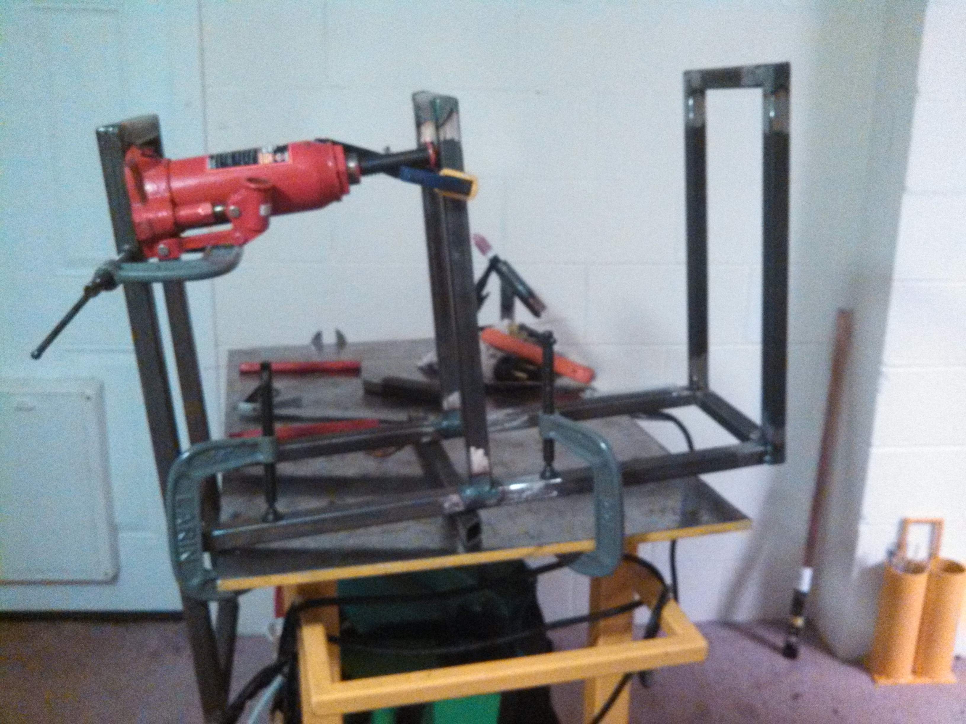

This is what it's come to...

TIG might not be the best process for that judging by how much heat discoloration there is. TIG usually has nice neat small welds.

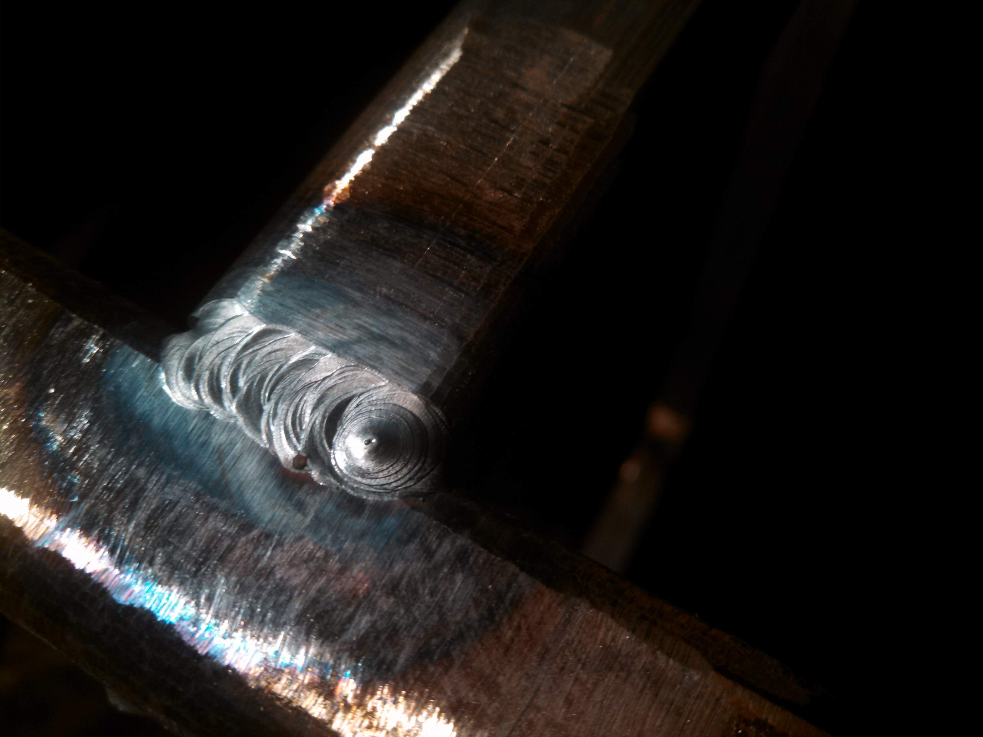

Amateur though I am, I do occasionally turn up a bead that I'm not totally ashamed to show my face around in public.
Do you think I'm putting too much heat into the metal?
   / Bending tube with a TIG torch #27
It doesn't look like it to me. In my experience box tube is one of the most reactive to heat materials you can work with.
If you had an O&A torch you could have done this to bring the legs back plumb. The wedge on the left needs to be down at the base, your C-clamp was in the way to draw the heat zone in the proper place.

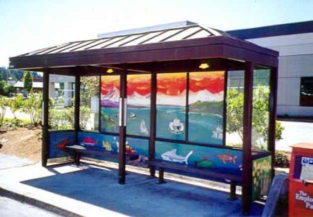

One time I got stuck building 199 of these Seattle Metro bus shelters! The legs had 1/16-inch tolerance for plumb. How do you think I kept that?

Don't feel too bad, I had to do the same thing. I was making a new bed for my pickup truck. I used 1.5" square tube. I had the frame done and everything was square and true. Now just skin it out with the sheet and it's perfect right? Warped the bajeezezes out of everything. Had to make some relief cuts to to get it back in shape.
