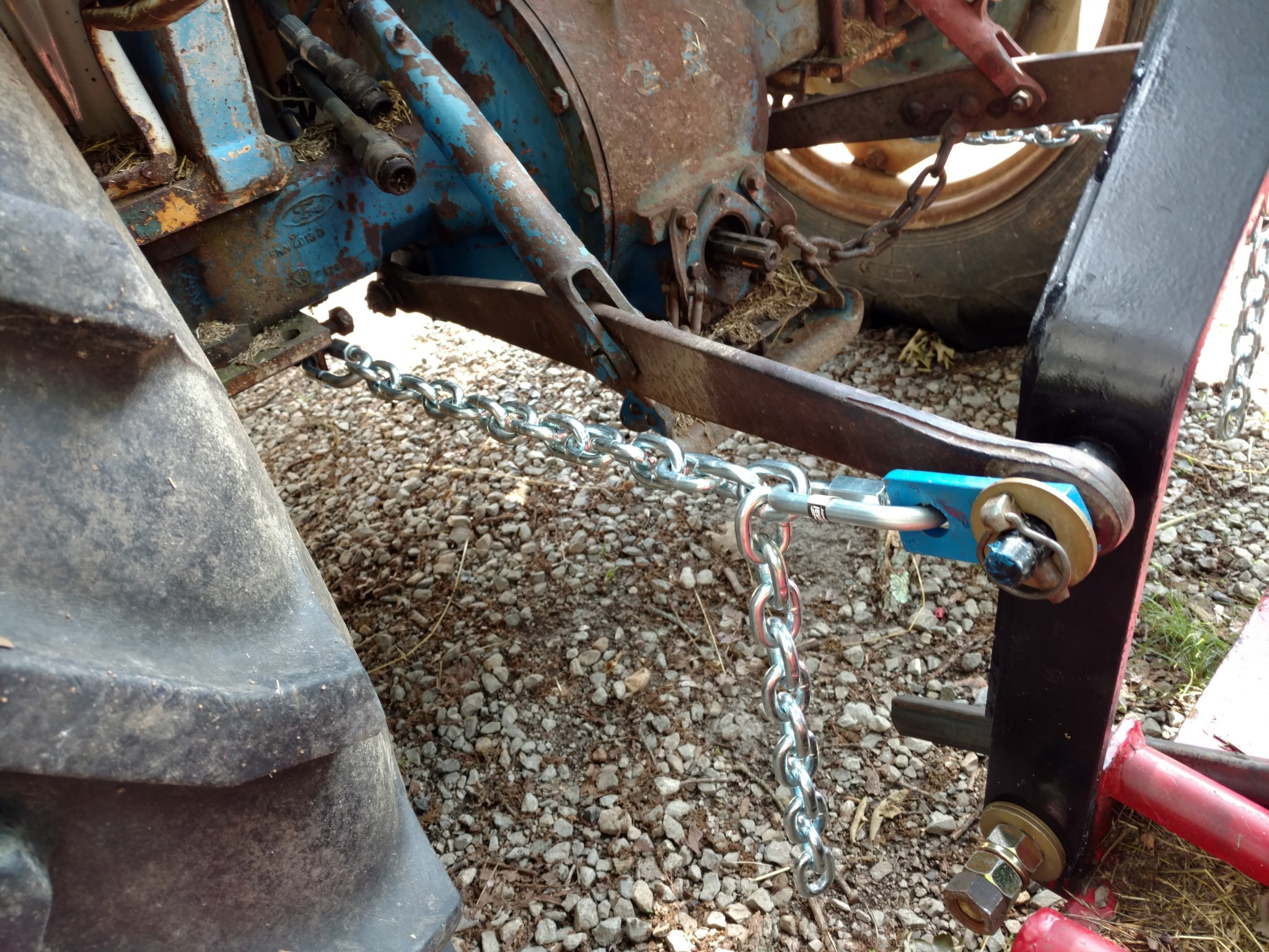

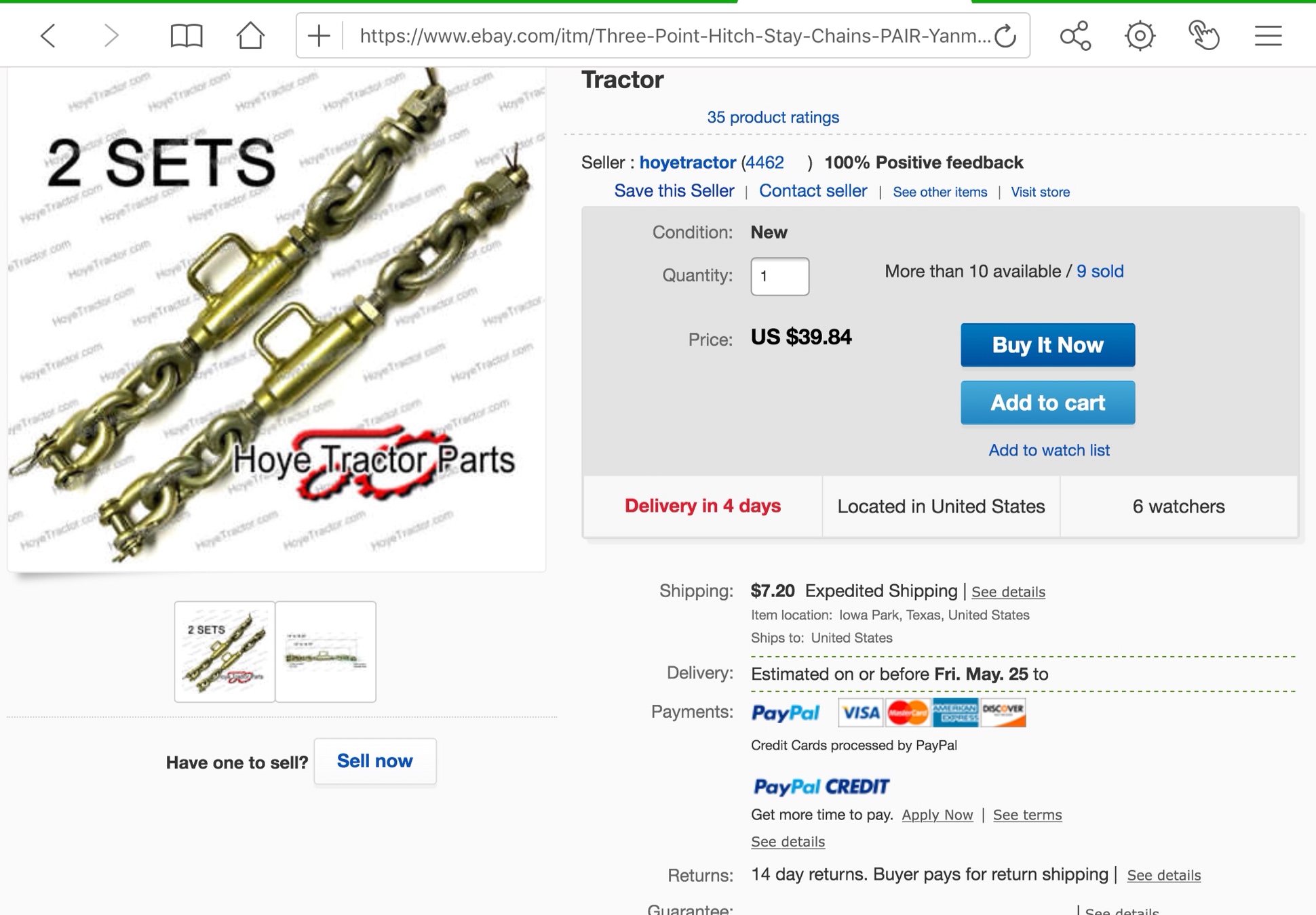

This is the photo that was posted 3 years ago that has worked out well for me. This is a 3600 Ford and the bush hog is a twin spindle a 7 ft bush hog brand.
I gave $2 for two collapsed stabilizer bars from Days go by and just cut the ends off drilled the hole and used the cheapest tractor supply chain so it offers more stretch.

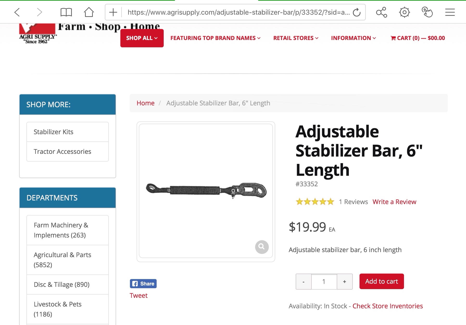

yeah those stabilizers on the 15,16,1500,1600 are all the same and seem to be all to sloppy. everyone seems to be breaking them for various reasons.... im sure anything other than that type is better lol. my 2638 has a turnbuckle style and so far been good but i haven't used it much at all.... :(
   / Bent, broken telescoping anti sway arms on Mahindra.
#70
I just ordered the ones from ag supply. The ones Bill had welded are hard to slide and line up. Since I am having to do this, I thought get what is easier for me. Thank you.
