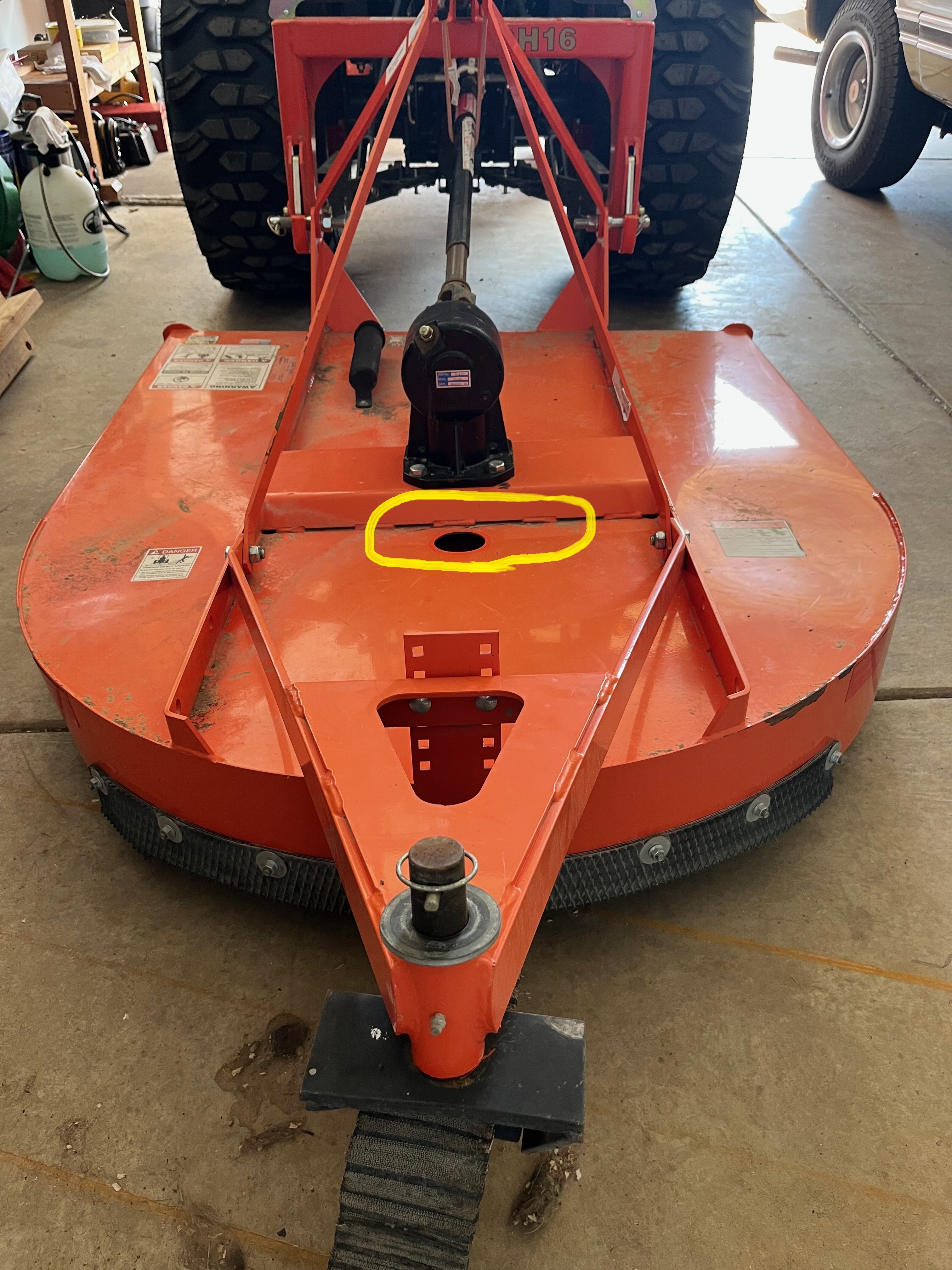

Is there some unpleasantness going on with the two circled welds, or is it just dirt?

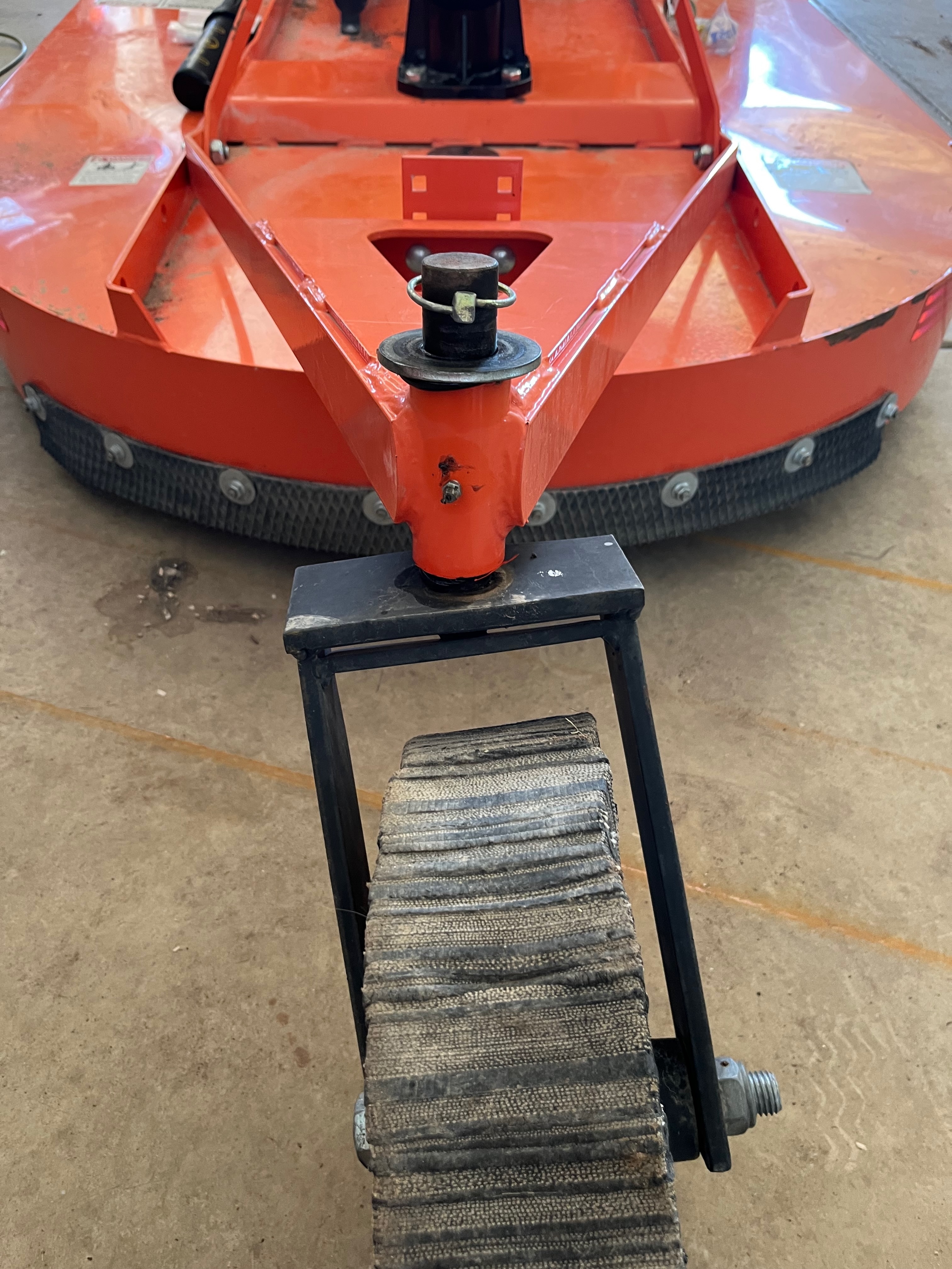

That thing needs grease for the rear wheel. If it were mine it would be a black mess.

Greetings. I was not careful enough when I bought this used Land Pride RCR1248 (heck of a deal!) and did not notice that the deck is bent in a slight U shape on the left side. See the pics with the 6' level. I'm not sure how (or if) it will cut in this condition, but if it does fine I won't worry about it much.
Is there a simple way to bend it back into shape?

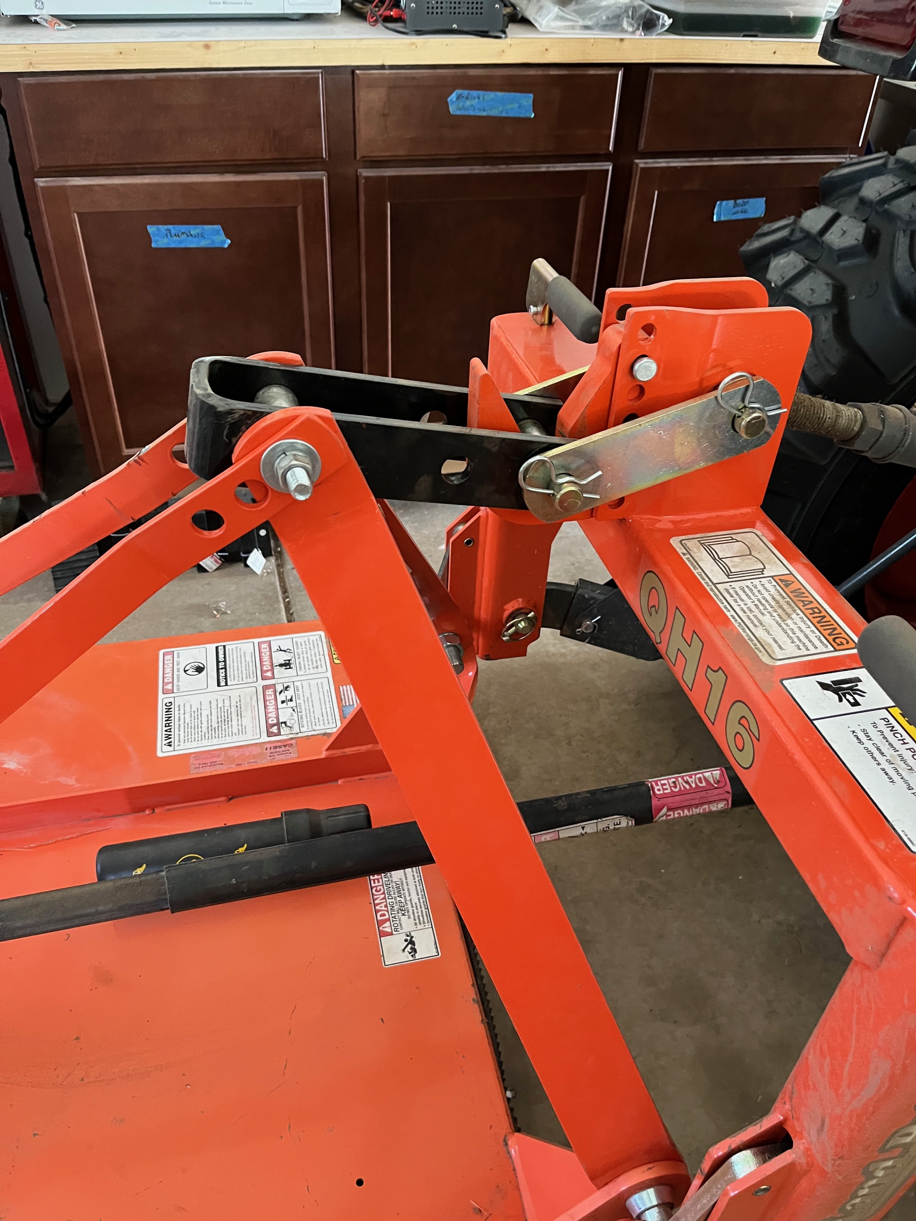

Also, it came with a horseshoe shaped top link that I 'think' will work with my quick hitch. Should I be trying to source a floating top link for it, or will it work fine as-is?
Thanks in advance for the help!
Jim
Probably a hot take from me…
But… seeing as there’s no “ring” of dents where rocks get flung up and beat the top up, the paints not all chipped and flaking like you’d see from impacts…
I’d betcha that hawg came that way from the factory.
Send it, and fugettaboutit! ;)🇺🇸

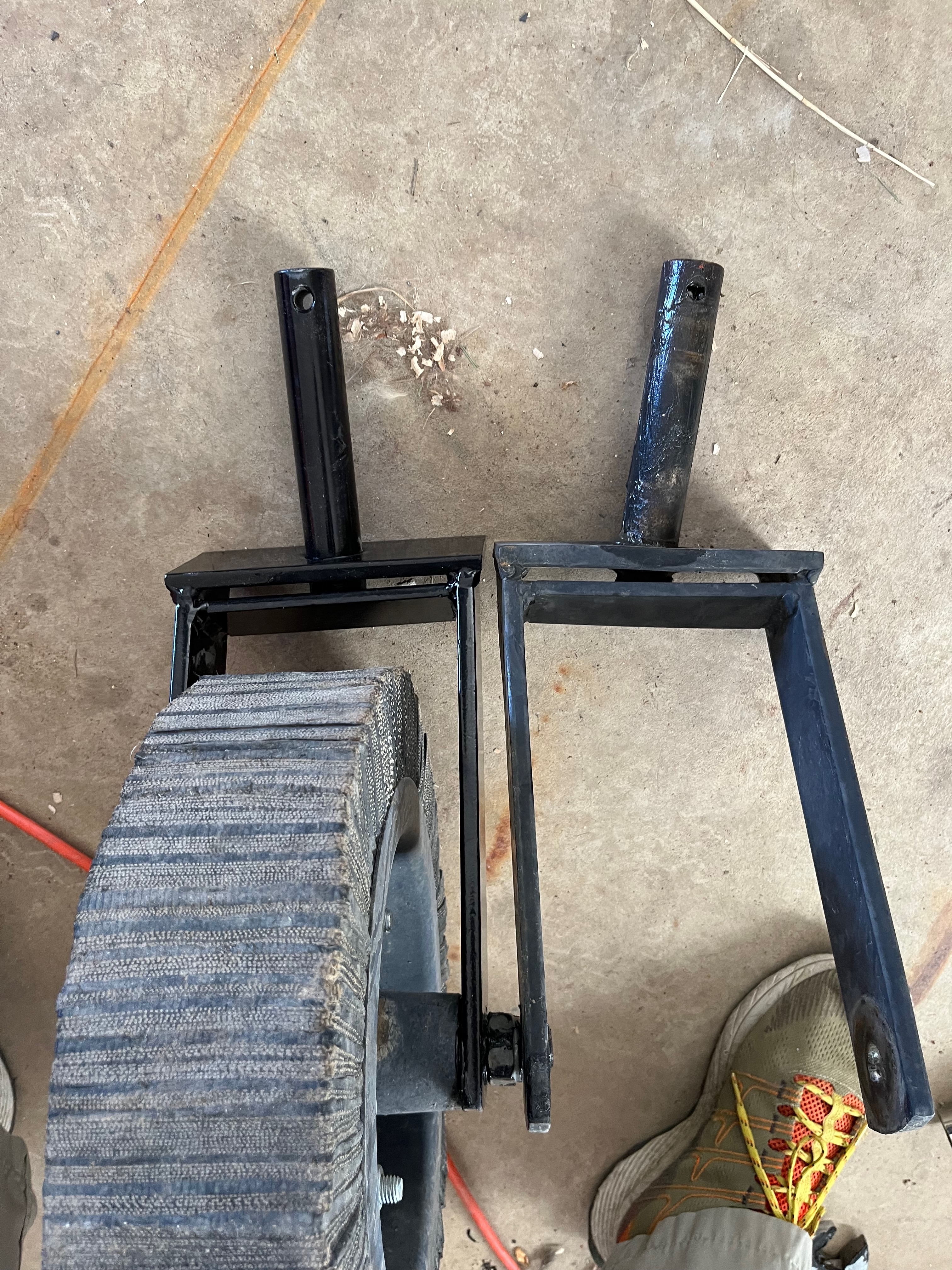

Well, the verdict is in...
After ordering a new tailwheel yoke, because, this:
New vs old:
It cut just fine. No noticeable left/right height difference in the cut.
Finally, here's the Messick's floating top link installed to give me the float I needed for my hilly pasture:
Thanks to all for the recommendations!
